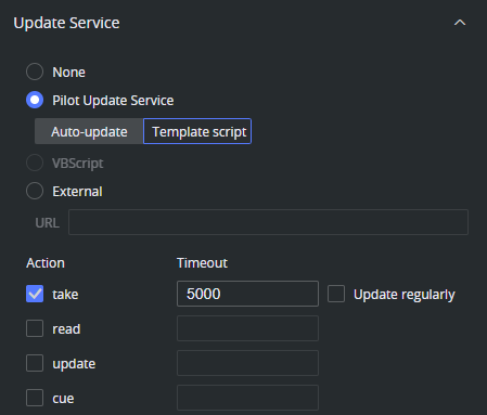

Enabling Update Service in a Template
Enter the Template Properties page:
The Update Service section has four available options:
  • None: No update service is used.
  • Pilot Update Service: Lets the Pilot Update Service either auto-update the template, or run the onUpdate event handler in the internal template script (see below). In this case, the JavaScript in the onUpdate event is executed on the server side by the Viz Pilot Edge Script Runner.
  • VBScript (legacy): Enabled if the template is created with Template Wizard and the template contains a VBScript.
  • External: Use this to specify a URL to an external update service.
Pilot Update Service with JavaScript in Template Builder
When an update script is enabled for a template, the Media Sequencer representation (VDOM) of the master template contains a <live_update> node. This node contains URLs to the update service responsible for updating the payload. The result is put into VDOM and sent to the Viz Engine, but not saved back to the Viz Pilot database.
Viz Pilot Update Service
The Viz Pilot Update Service is automatically installed together with Pilot Data Server. Make sure this service runs and is responsive and reachable from Media Sequencer. The default port is 1991 for HTTP and 1992 for HTTPS. This service executes the onUpdate part of the template script. To determine when the script runner should be invoked by Media Sequencer and control the behavior, the following properties can be set in the Update Script section of Template Properties:
  • Pilot Update Service: Determines that the Pilot Update Service should be used to update data.
    • Auto-update: Lets the Update Service refresh all field links to external data with the latest content. No script is executed.
    • Template script: The onUpdate() in the internal template script should be executed by the Update Service.
  • Action: Determines on which Media Sequencer actions the script should be invoked.
    • take: To get the graphics on air.
    • read: Used to preview the graphics on an external Viz Engine (Viz Trio for example).
    • update: Explicitly update data in an element being on air in the renderer, without starting in-animations.
    • cue: Setting graphics in the first frame of the animation in the renderer.
  • Timeout: For all actions, specifies the time in milliseconds that Media Sequencer waits for a response from the Update Service, before it continues with the operation.
  • Update regularly: For the take action, the Update Service can also be invoked on regular intervals while the graphics are on air. The interval is decided by the live_update_interval database parameter. The default and minimum value is 2 seconds.
Note: If Update regularly is checked, the update script action runs with the take action on subsequent updates. However, if update is also checked, the action script is called with update as an argument. This means you can differentiate the script behavior based on whether the Media Sequencer action is take or update.

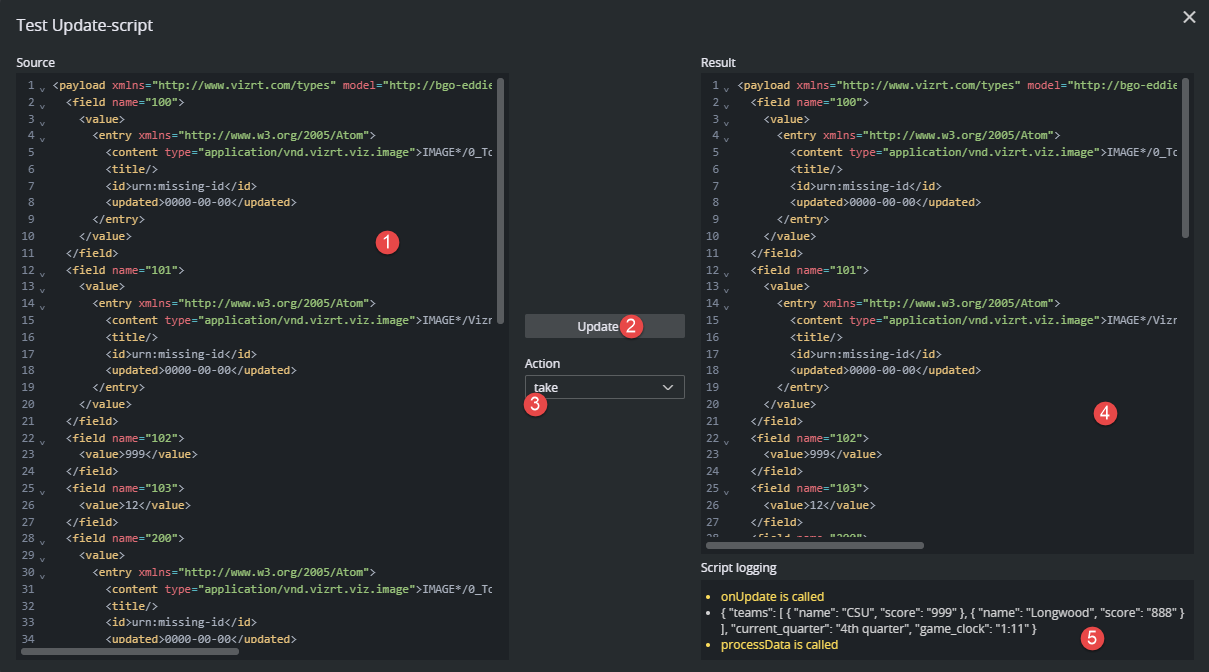

Testing the Script
To test a proper server side execution of the update script:
  • Save the template.
  • Click the test update script-button in Template Builder image-20241002-130401.png.
A new window opens, allowing you to test the script by doing a POST to the script runner URL with the source data on the left, and the returned VDF payload on the right.
  1. The left window contains the VDF payload of the current data element.
  2. When clicking Update the REST end point in Pilot Update Service (as configured in the Pilot Data Server Launcher) is called with the URL to the current data element as a parameter. Pilot Update Service then loads the template script from the Pilot Data Server, executes onUpdate and returns with a new, updated payload.
  3. The action parameter simulates different actions performed by a control client on the data element. This action is sent as an argument to the update script and makes it possible to differentiate between actions in the script.
  4. The right panel contains the response from the Pilot Update Service. To check whether it performed the desired updates, look for the field values it was supposed to manipulate inside the payload. Note that the current data element in Template Builder is not updated, nor is the preview. The only result of the server side script execution is the VDF payload in this window.
  5. If the script contains logging to console or exceptions, these log messages are returned from the Pilot Script Runner along with the VDF payload and displayed here. This is useful for debugging and testing. There are 4 log types available when logging in script, they are each displayed with different colors in the log window:
    console.log("LOG")
    console.info("INFO")
    console.warn("WARN")
    console.error("ERROR")
