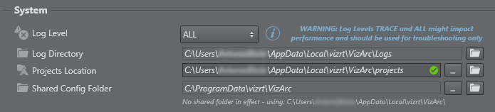

System
The System group controls logging and the storage locations Viz Arc uses for its own data (logs, projects, and the shared profiles/configuration).
  • Log Level: Sets the verbosity of the application log, from most to least detailed: ALL, TRACE, DEBUG, INFO, WARN, ERROR, FATAL, OFF. The default is INFO.
    Note: the TRACE and ALL levels are very verbose and can impact performance — use them only for troubleshooting.
    • ALL: Shows all level logs (below).
    • TRACE: Shows traced code; useful for identifying errors in a function if there is a software crash. Logs all commands sent to the Engine in a separate log file.
    • DEBUG: Shows specific technical information.
    • INFO: Shows the main information in a log.
    • WARN: Shows issues that may potentially cause application anomalies.
    • ERROR: Shows any error that is fatal to the operation.
    • FATAL: Shows only errors that force a shutdown of the application to prevent data loss.
    • OFF: Switches logs Off.
This setting does not limit what you can inspect while Viz Arc is running: the live log can still show less severe messages than are being written to disk. The live log is held in memory in a circular buffer of fixed size (the most recent entries only, older ones are discarded), independently of the on-disk log level.
  • Log Directory: Read-only. Shows the folder where log files are written. Logs are always kept per user on the local machine (%localappdata%\vizrt\VizArc\Logs) and are never redirected to a shared folder. Use the Reveal button to open it in Windows Explorer.
  • Projects Location: The folder where Viz Arc file based local projects are stored. Use Browse (…) to change it and Reveal to open the current location in Windows Explorer.
  • Shared Config Folder: Optional machine-wide folder that holds the profiles and configuration shared by all users of the machine. When set, every user reads and writes the same configuration from this location. The line below the field shows where configuration is actually being read/written in the current session. Changing this setting requires administrator rights and a restart — see Shared Configuration Folder below for details.

The small text under the field always tells you which case applies in the current session:
Status line
Meaning
Currently using: <path>
A shared folder is configured and in effect; configuration is read/written there.
No shared folder in effect - using: <path>
No shared folder is configured; the normal per-machine/per-user location is used.
Configured folder unavailable - currently using: <path>
A shared folder is configured but could not be written to, so Viz Arc fell back to the local location for this session.
The Shared Config Folder field shows the value that is configured, while the status line shows where configuration is actually being read/written. These can differ — for example right after you change the setting (the change only takes effect on restart), or when the configured folder is temporarily unavailable.

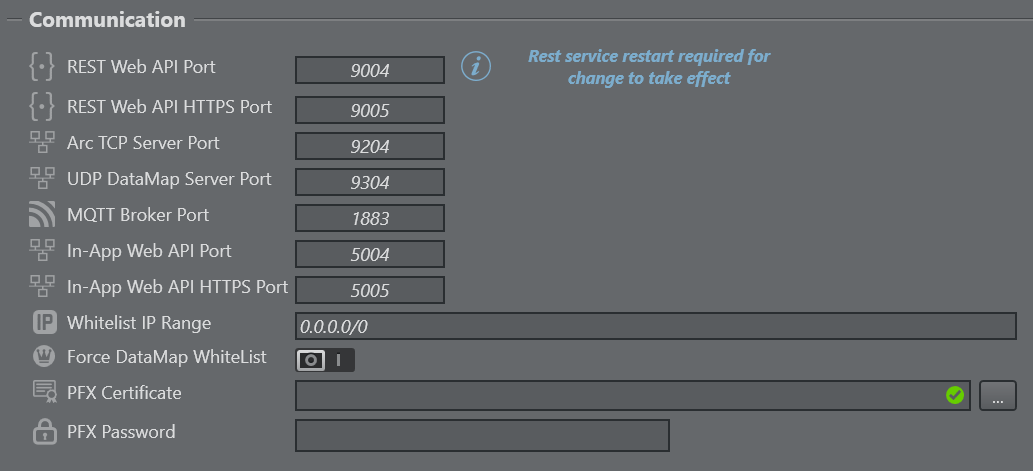

Communication
  • REST Web API Port: The REST port used for listening to incoming requests by the Viz Arc REST server.
  • REST Web API HTTPS Port: Same as above, but for the HTTPS clients. Requires the setup of the PFX certificate parameter (below).
  • Arc TCP Server Port: The TCP Server port to be used for incoming TCP Connections.
  • UDP DataMap Server Port: The UDP Server port to be used for incoming UDP packets for DataMap updates.
  • MQTT Broker Port: The internal MQTT Broker port to be used. Set to 0 to disable the Broker.
  • In-App Web API Port: The port to be used for the internal web server.
  • In-App Web API HTTPS Port: The port to be used for the internal web server.
  • Whitelist IP Range: Specifies a semi-colon (;) separated list of IP addresses/ranges (in CIDR notation) allowed to access the web server.
  • PFX Certificate: The path to the PFX certificate required to enable HTTPS for the REST service.
  • PFX Password: The password of the PFX certificate.
Note: All settings take effect upon restart of the REST service or Viz Arc.

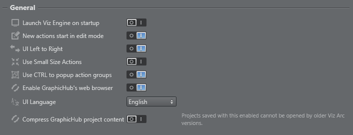

General
  • Launch Viz Engine on startup: Launches Viz Engine on Viz Arc application startup, when enabled.
  • New actions start in edit mode: Starts new actions in edit mode when created when set to On.
  • UI Left to Right: Switches the UI to right to left mode (experimental) when set to Off.
  • Use Small Size Actions: Uses smaller buttons for Actions when set to On.
  • Use CTRL to popup action groups: Hold CTRL while left clicking on the Expand button of a Group Action to expand the group temporarily as a popup. Disable this option to make this the default behavior without holding the CTRL button.
  • Enable Graphic Hub's web browser: Uses web view based Graphic Hub browser for scene browsing.
  • UI Language: Determines the language to be used for the UI (feature under development).
  • Compress GraphicHub project content: Compresses large projects before saving them to a GraphicHub, so they store successfully and upload faster. Off by default. Projects saved with this enabled cannot be opened by older Viz Arc versions — see below.
Compress GraphicHub Project Content
A GraphicHub limits the size of a single project-content field, so very large projects can fail to save. When enabled, Viz Arc compresses (gzip) project content above ~1 MB before uploading it, keeping it under the limit and speeding up saves — a 50 MB project typically stores as a few MB.
  • Automatic reads: compressed projects are always detected and opened transparently, even with the option off, and also via the REST/web interface. Toggling it on/off takes effect immediately (no restart).
  • Scope: only large project content is compressed; small projects and already-compact content are left as-is, and project metadata stays readable.
  • Compatibility: existing projects are unaffected, but projects saved compressed cannot be opened by Viz Arc versions that predate this feature. Enable it only once all installations sharing the GraphicHub are updated.
  • Exports: .arc exports always store plain content and stay portable across any version.

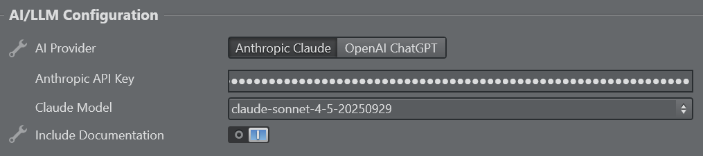

AI/LLM Configuration
For the AI feature(s), choose between the two AI providers Anthropic or OpenAI.
  • AI Provider: Selects either Anthropic Claude or OpenAI ChatGPT.
  • API Key: Uses the API key provided by the AI provider.
  • Model: Selects the model to be used for AI based on the provider.
  • Include Documentation: Determines whether to send Viz Arc` documentation along with AI prompts. Disable this to reduce token usage, enable it to get better results.
This configuration section is only to be configured for users intending to use the Template Builder’s built in prompt. When external applications using the MCP server are going to be used, this section can remain empty/unconfigured.

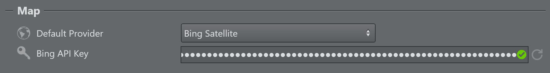

Map
A key Viz Arc feature is the ability to set up augmented reality elements, tracked cameras and polygon masks in outdoor productions directly over a map.
To use Bing maps and the search feature, please create an API key, read more here.
Select a Default Provider for map imagery using the Map menu below:
  • Default Provider: Selects the default map provider for the map section
    • Bing Satellite, raw satellite view.
    • Bing Hybrid, satellite including boundaries/places, street names and roads as overlay.
    • Bing Just the map view showing boundaries/places, street names and roads.
  • Bing API Key: The API Key used to download map tiles and location searches on the set view. Use the refresh button to check the entered API Key. A restart of the application is required to use the new API key.

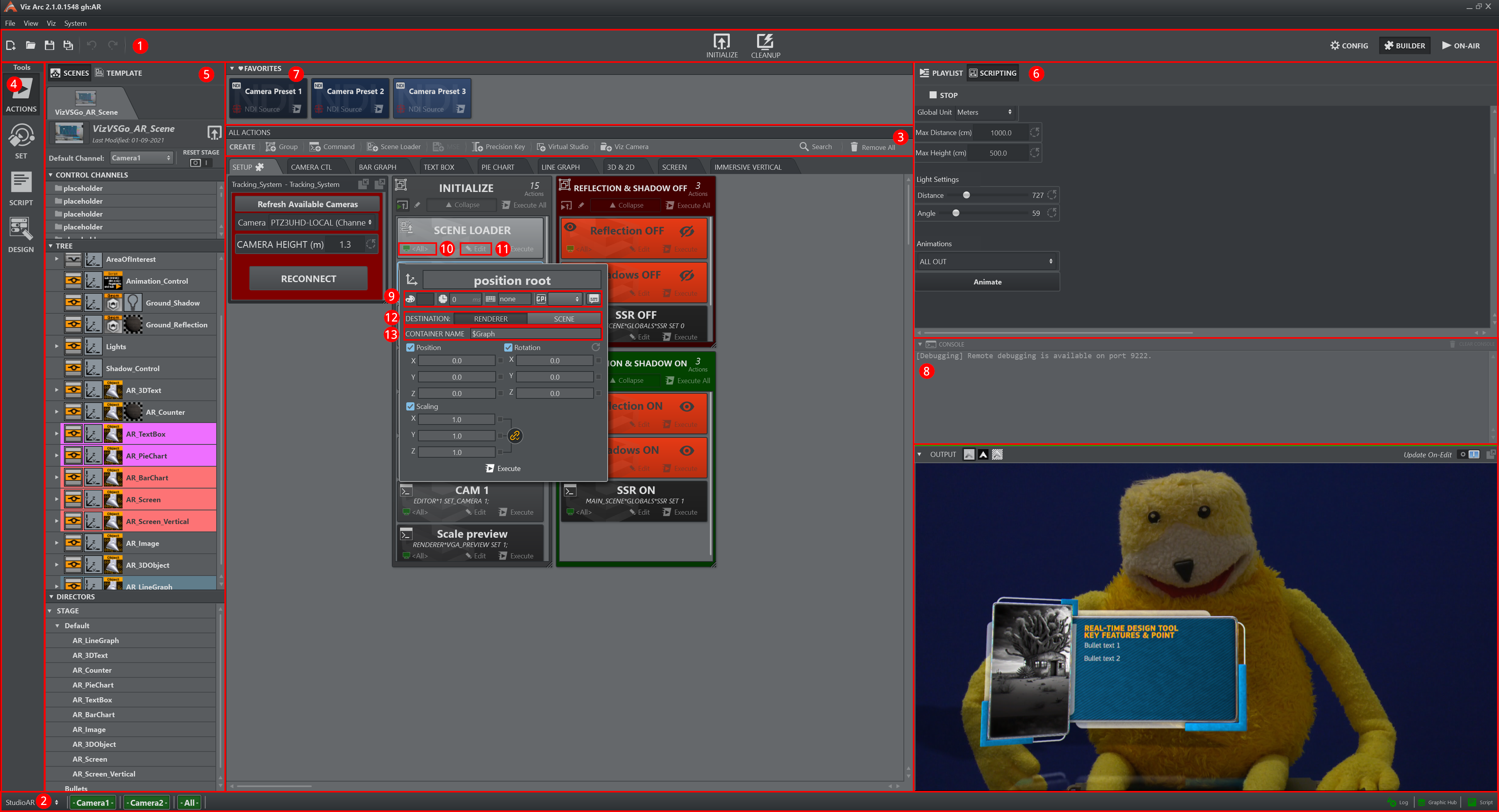

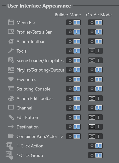

User Interface Appearance
Use these settings to customize the UI appearance for builder and On Air mode.
  1. Menu Bar: Toggles the menu bar containing the new, open, save, save as, undo/redo initialize and cleanup shortcuts. Most items still be reached through shortcuts or the menu.
  2. Profiles/Status Bar: Toggles the bottom bar containing the profiles selection and the channel status information.
  3. Action Toolbar: Toggles the toolbar containing shortcuts to create actions.
  4. Tools: Toggles the left hand side tool bar. Tools can still be reached through the View menu.
  5. Scene Loader/Templates: Toggles the left hand side of the UI containing the scene loader and the templates.
  6. Playlist/Scripting/Output: Toggles the right hand side of the UI containing the script, playlist and output panel.
  7. Favorites: Toggles the favorites bar.
  8. Scripting Console: Toggles the scripting console.
  9. Action Edit Toolbar: Toggles the action toolbar containing color selection and more when editing an action. Most properties can still be changed through the context menu.
  10. Channel: Toggles the channel visibility on the action.
  11. Edit Button: Toggles the action’s edit button. The action can still be edited using the context menu.
  12. Destination: Toggles the Viz scene-specific action’s destination property.
  13. Container Path/Actor ID: Toggles Viz scene-specific action’s scene path and Unreal specific actor IDs.
  14. 1-Click Action: In case the Action Toolbar is switched off in On Air mode, this options allows you to toggle the 1-Click action behavior.
  15. 1-Click Group: In case the Action Toolbar is switched off in On Air mode, this options allows you to toggle the 1-Click group behavior.

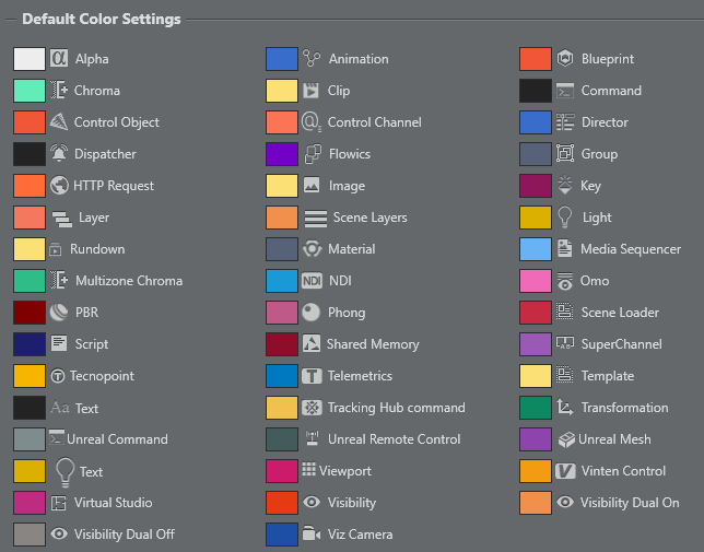

Default Color Setting
You can assign a default color for each action, such as transformation, alpha, visibility and so on. You can still assign a different color in the main area.
