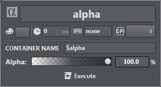

Alpha
Alpha lets you set the opacity to the referred object, from 0.0 (not visible) to 100.0 (fully visible).

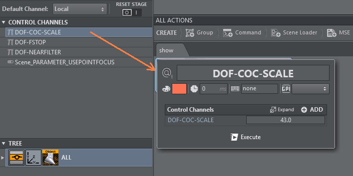

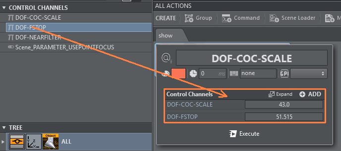

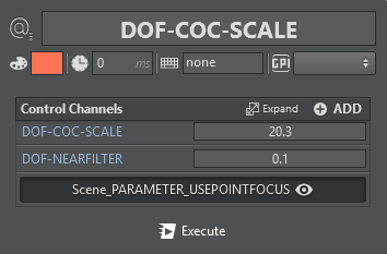

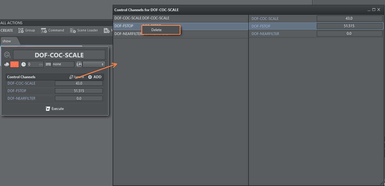

Control Channel
Control Channel lets you control basic Control Channel types such as floats, integers, and Boolean values. This can be particularly handy in conjunction with the Viz Engine 4 Render Graph.
To create a Control Channel action, drag and drop a Control Channel to the action canvas:

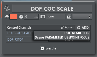

If more than one parameter needs to be controlled by the same action, edit the action and drag more parameters into the designated area:
or use the ADD button to select from a list of available Control Channels to be added:
To remove Control Channels from the action, click the Expand button and use the context menu to delete single Control Channels in the newly opened window:

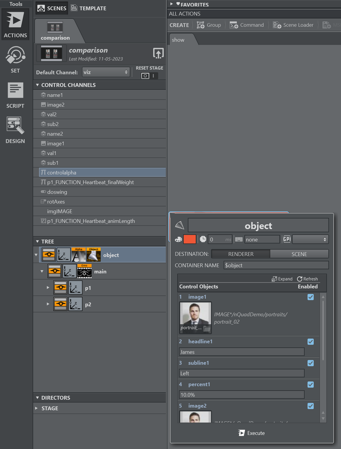

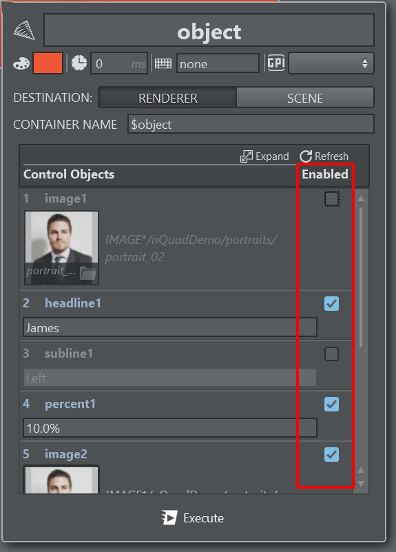

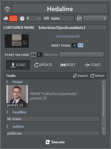

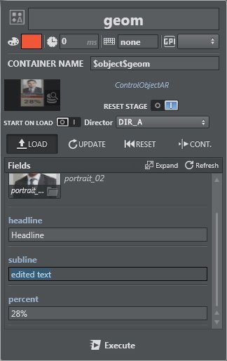

Control Objects
Control Object actions can be used by dragging a Control Object plug-in from the scene tree into the action canvas. It gives you a list of the Control Objects under the respective tree structure.
Expand the controls clicking the Expand button for a better overview and to enable deletion of single or multiple Control Objects. Select all the controls that shall not be set by this action, then select Delete from the context menu.
Use the Refresh button to update the list from the associated scene, in case the scene has been modified after the action's creation.
In some cases you might want to send only a subset of the entire Payload. Use the Enabled toggle flag for each Control Object to enable or disable setting the specific property on the Viz Engine. It behaves similar to the delete option described above, but in this case you can re-enable the disabled Control Object easily.

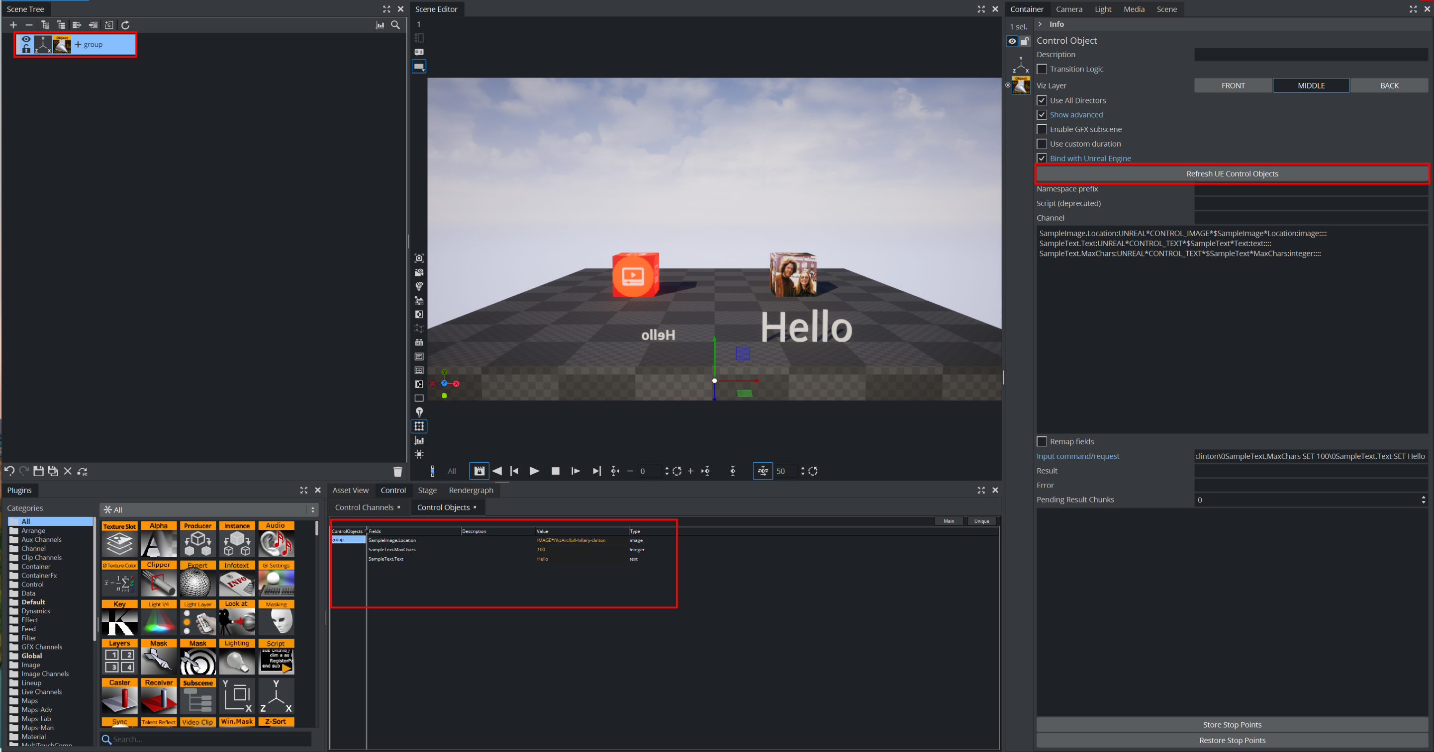

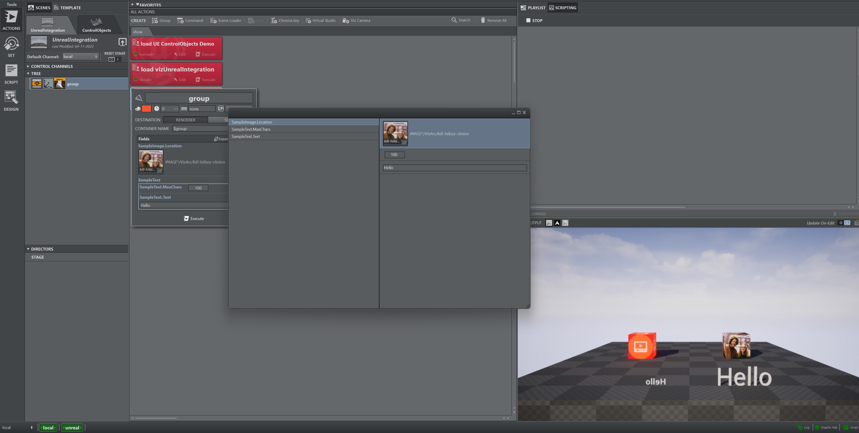

ControlObjects in Unreal Engine
The Viz Engine's Control Object integration allows you to control aspects of the Unreal scene using Control Objects. Viz Engine's Control Objects can be used to ingest images from the Graphic Hub to the Unreal Engine.
Control Objects can be refreshed within the Viz Engine by using the Refresh UE Control Objects fetching the exposed controls of the currently loaded Unreal Level.

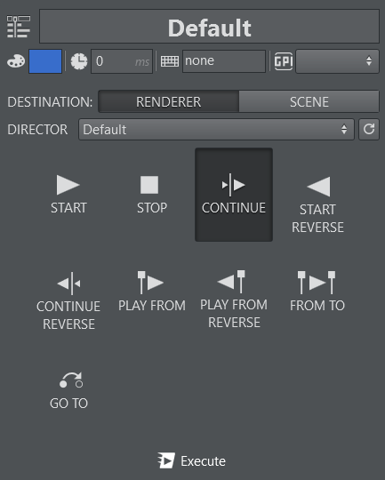

Director
Director lets you handle stage animation of a specific stage director or ALL stages.
It’s possible to:
START an animation.
STOP an animated director.
CONTINUE an animation to the next step.
START in REVERSE mode.
CONTINUE in REVERSE mode.
PLAY FROM a specific KEYFRAME.
PLAY FROM a specific keyframe in REVERSE mode.
PLAY an animation FROM a specific KEYFRAME TO another.
SET an absolute time in seconds and jump (GO TO) tag/stop points.
This menu lets you set the Stop/Tag for PLAY FROM, PLAY FROM REVERSE and GO TO options, and the Frame Time for the CUSTOM option.
This menu lets you set the From stop/Tag and To Stop/Tag for playout of an animation for the FROM TO option.
PLAY FROM…TO (From/To)
The From Stop/Tag dropdown offers:
  • <CURRENT>: Start from the current stage/director position (the playhead's current location).
  • <START> / <END>: The director's start and end.
  • Any named tag or stop keyframe in the director.
  • <CUSTOM>: A manual start time, entered in Frame Time (s).
The To Stop/Tag dropdown offers named tags/stops and <END>. There is no <CUSTOM> option for the To point, because the engine does not support a custom target time.
How PLAY FROM…TO plays: The From/To operation jumps to the From point and then continues playing toward the To point. It continues across tags. Tag keyframes do not halt playback. Playback stops only at the next Stop point, or at the director's Start / End.
The Director Action shows the number of stop points when a specific director is selected (for example, not the <STAGE>). When the action is selected, a progress bar on top alongside with the currently reached stop point (for example, 2/3) is visualized. The number of stop points is read on the creation of the action and when the action is explicitly refreshed.

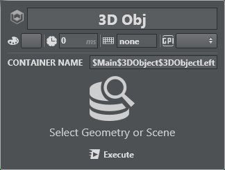

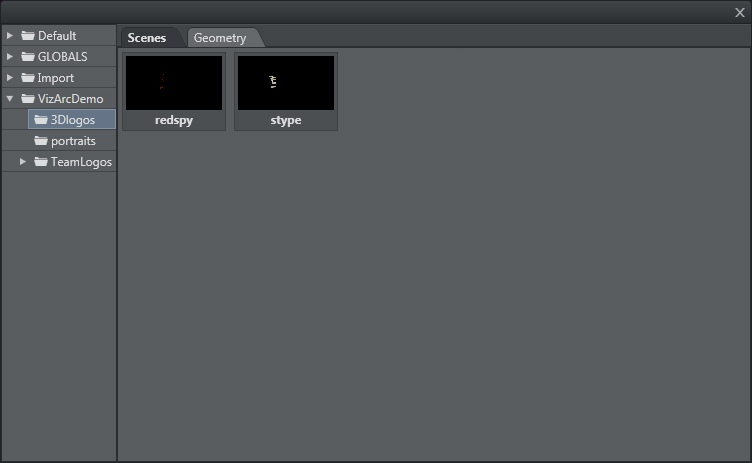

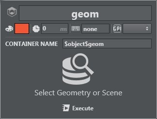

Geometry
Use this menu to set an OBJ or SCENE element in a specified container.
Clicking Select Geometry or Scene makes all GH trees appear in a new window, where you can select a new GEOM.
Selecting OBJECT makes the relevant thumbnail appear in the action box.
It’s also possible to select a SCENE instead of GEOM. Once the scene is loaded in the geom plugin, a separate edit section appears where it's possible to handle control object (if applicable) of the selected scene.

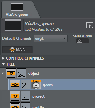

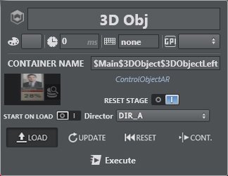

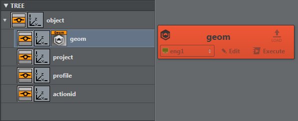

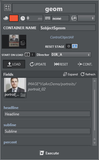

To Import a Geometry
In Viz Arc, it's possible to import objectified scenes (GEOM) into another scene through the GEOMETRY element. Once the selected object is imported in the right GEOM, it's possible to load, update, refresh and continue. A step-by-step example of importing and playing an objectified scene follows below:
Load a main scene that contains at least one GEOM element.
Drag the GEOM element into the main area.

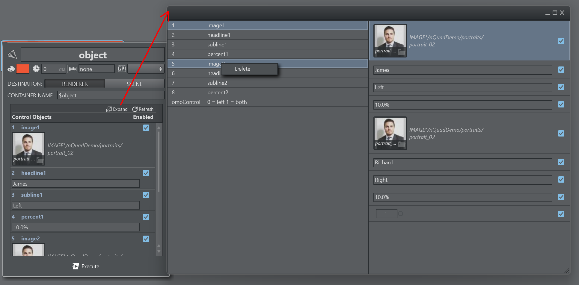

Press Edit and select the scene.

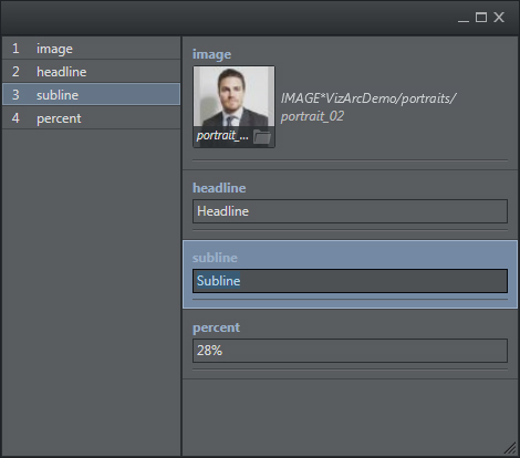

Once you select the scene, a list of control objects appears (if applicable). You can enable the RESET STAGE option to have the scene placed on the 0.0 frame in the stage.
You can edit every control object listed in the scene.
You can use the  icon to open a popup window that contains a detailed list of control objects, where you can modify each field by clicking it.
Once you have created your action box, you can duplicate it by pressing CTRL +D and assign a different action (LOAD, UPDATE, RESET, CONT) to each box. Follow the steps below to play the GEOM scene in the main scene:
This command loads the scene/object in geom.
If  is enabled, the scene/object is loaded with all its stage animation set to frame 0.
If  is disabled, it works like a Take command, loads and start stage.
This command updates all changed control objects On Air.
This command initializes the stage (frame 0.0).
This command plays the scene. If the scene has multiple animation steps, you can continue the animation by clicking it multiple times.
For LOAD, RESET and CONTINUE, you can choose a specific director instead of the full stage.

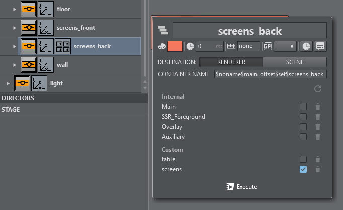

Layers

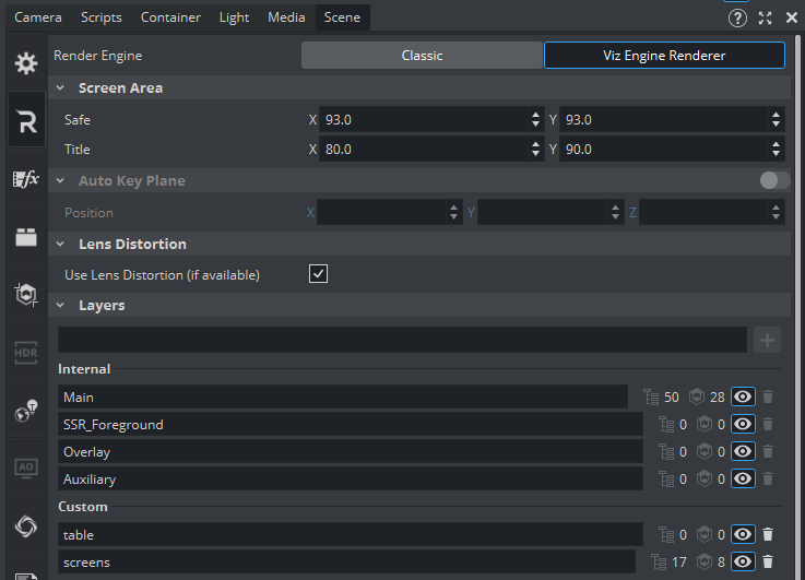

Viz Engine 5 composites a scene from a stack of layers. Each layer holds part of the render (for example, a background, an on-screen graphic, or a set of screens) and can be shown, hidden or re-ordered independently. Layers come in two groups:
  • Internal: The four built-in layers every scene has: Main, SSR_Foreground, Overlay and Auxiliary.
  • Custom: Any additional layers the scene designer has created (in the example below, table and screens).
Viz Arc exposes layer control through two related actions. They look almost identical in the editor, but they act on different things:
Action
How it is created
What it controls
Scene Layers
Right-click the action canvas and choose Create Scene Layers from the context menu.
The scene-wide visibility of every layer in the current scene. It talks to the renderer directly, so it needs no container.
Layer
Drag and drop a layer plug-in container from the scene tree onto the action canvas.
Which layers a single container's layer plug-in renders into. It is bound to that one container.
When either action is created (or whenever you press its Refresh button), Viz Arc reads the current layer set from the Editing Engine and rebuilds the list, so what you see always matches the scene that is loaded. If the Engine is disconnected or the scene does not answer, the existing list is kept rather than wiped.

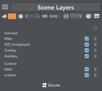

Scene Layers Action
The Scene Layers action mirrors the Engine's own layer list. Below, the same set of layers is shown in the Viz Engine Scene > Layers panel and in the corresponding Viz Arc Scene Layers action.
Each row has an enabled checkbox that represents the visibility the layer is set to when the action executes (ticked means the layer is shown, unticked means it is hidden). On Execute, the action sends the visibility state of every layer still in the list to the selected channel's Engine(s). Layers are addressed by name, which stays valid even after the scene or Engine is reloaded (unlike the internal layer id, which is reassigned each time the scene is opened).
Use the trash icon to remove a layer from the list. A removed layer is no longer touched by the action, its visibility is left exactly as it is on the Engine. This is the key to building focused actions: Keep only the layers you actually want the action to change.
Layer Action
Create a Layer action by dragging a layer plug-in container from the scene tree onto the action canvas. Unlike the Scene Layers action, this one is tied to the container you dragged in, so it also shows the Container Name it addresses.
The row checkboxes here mean something slightly different: Each one toggles whether that container's layer plug-in renders into the corresponding layer. The layer list itself is still read from the scene (both Internal and Custom layers appear), but the on/off state belongs to this plug-in instance. As with the Scene Layers action, use the trash icon to drop any layer you don't want the action to affect, and Refresh to re-read the current state from the Engine.

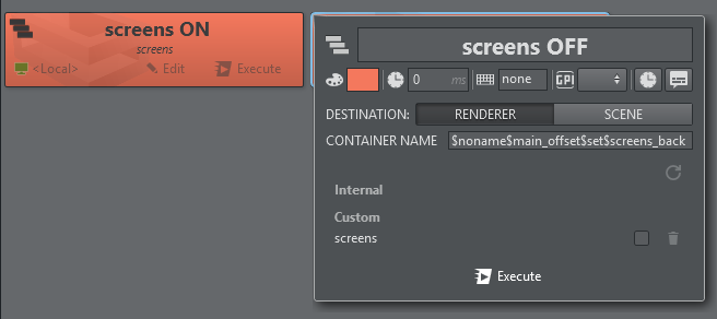

Building On/Off Actions
Because removed layers are ignored, you can reduce a layer action down to a single layer and use it as a simple switch. In the example below, every layer except screens has been removed, leaving two small actions that turn one layer on and off:
  • screens ON: screens enabled.
  • screens OFF: screens disabled.
The same technique works for any layer. Keep the one you care about, remove the rest, and duplicate the box to make the opposite state.

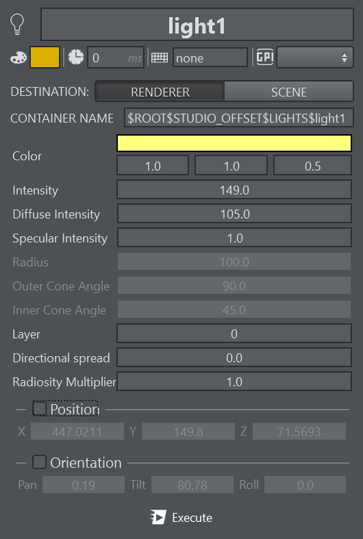

Light
The light action works together with Viz Engine V4 lights. All light types are supported (directional, area, spot, point).
The Position and Orientation settings can be optionally set and act on the container transformation.

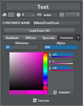

Material
The Material menu lets you set the material of an element and its Shininess and Alpha. Set a unique color or set every color to Ambient, Diffuse, Specular, Emission lighting by enabling/disabling the E button next to the lighting tabs.
  • Ambient: Determines the color that the object reflects when illuminated by a natural ambient light.
  • Diffuse: Determines the real color of the object, revealed when the object is illuminated by a neutral light.
  • Specular: Determines the color that the object has when the light meets the object surface and reflects in the camera.
  • Emissive: Determines the self-illumination color.

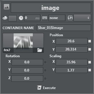

Image lets you select an image, both from GH tree and external explorer files, and set basic transformation parameters like Position, Rotation, and Scaling of the image texture.
Once in edit mode, click image to browse the database and select an image from Graphic Hub.
Once in edit mode, click the folder icon  at the bottom of the image box to browse the file system and select an image from your PC or device.
To see the image path, hover your cursor over it.

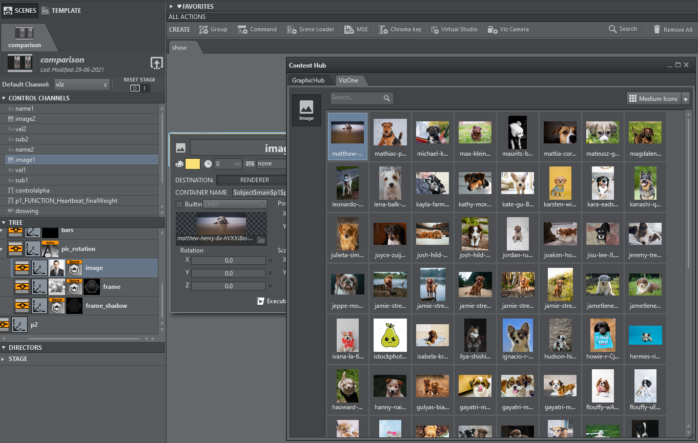

With a properly configured Viz One or Viz Media Service, assets can be picked from those sources in addition to local files or Graphic Hub. It is possible to search for assets within Viz One using the search box.

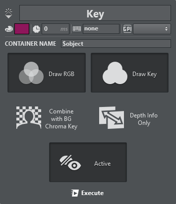

Key
Use the Key menu to handle Key options for a container:
Draw RGB
Draw Key
Combine with BG Chroma Key – combines the alpha of the container with the alpha of the background before blending the foreground with the background.
Depth Info Only – depth only for occlusion rendering with Live Video.
Active - shows if the Key plugin is active or inactive. Typically used in a green screen scenario to determine whether an object should appear in front of or behind the talent.

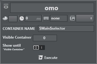

Omo
Use this menu to adjust the Omo plug-in settings:
This plug-in displays all sub-containers, either one at a time or by keeping the previous container visible until the selected container appears (by enabling the Show until parameter). The Visible Container parameter determines which sub-container is displayed.
Note: For more on the Viz Omo Plug-in, see the Viz Artist User Guide.

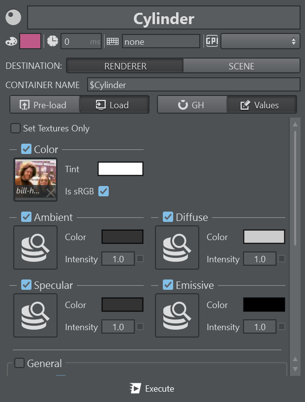

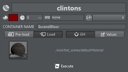

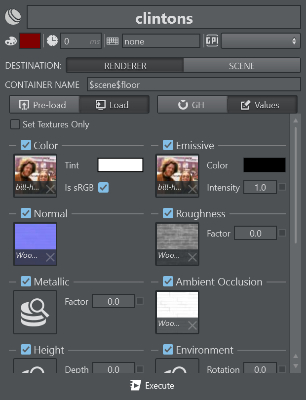

PBR Material
The PBR Material action works together with Viz Engine V4 materials.
The action offers a subset of Viz Artist's PBR settings, exposing only the most prominent features, such as all textures and colors defining the PBR material.
Enable the Set Textures Only checkbox to send texture information only, use the respective checkboxes on the various attributes to send to enable or disable them.
Use drag and drop from any image assets to copy and paste a texture asset to another slot.
When the GH Mode is selected, you can browse Graphic Hub for PBR materials and load them through this action.

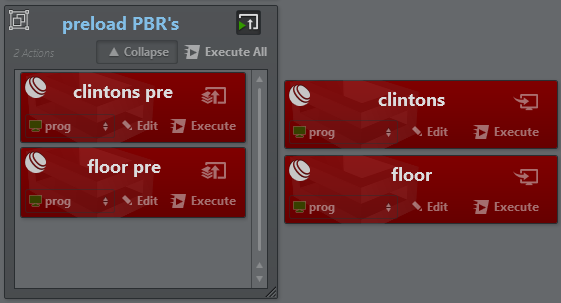

The action can be executed in two modes: Pre-Load or Load. Pre-Load preloads all the images present in the action on the Engine. Load effectively loads the PBR Material onto the Engine. Typically, you group all Pre-Load actions and execute them on Initialization, then trigger only the Load actions. Right clicking the action execute button always sends Pre-Load commands.
The screenshot above shows two PBR actions in an initialization group as pre-loading and the same actions on the right for loading.

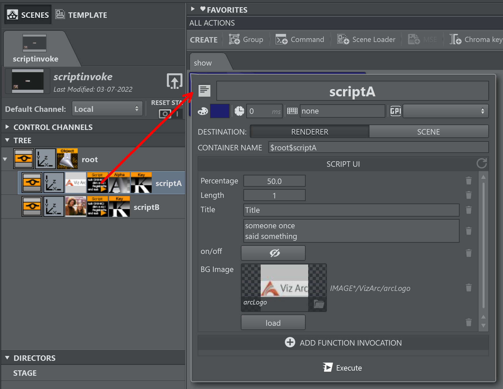

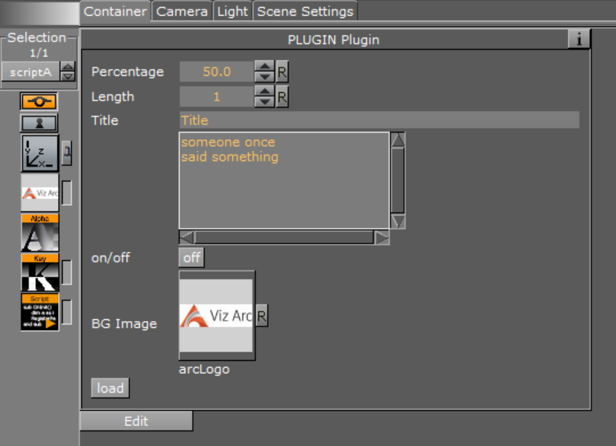

Script
The Script action lets you modify the registered UI parameters of a Viz Engine container script. Additionally, it lets you invoke any of the script's functions with its respective parameters.
An example of a container script UI in Viz Artist.
Drag and drop a Script container plug-in from the tree view into the action canvas to create a Script Action.

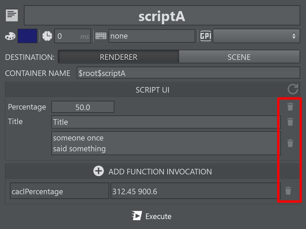

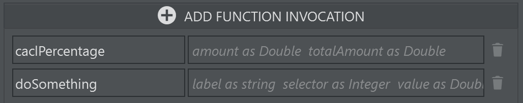

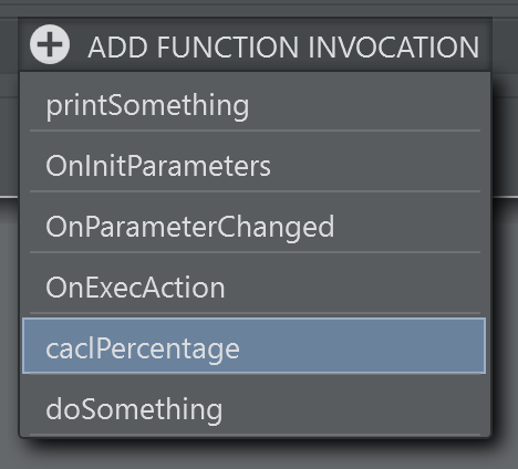

Click on the ADD FUNCTION INVOCATION button to add any of the script's functions to the action.
After adding the functions you whish to invoke, enter the parameters where necessary. A hint in the parameter's text box in the parameter gives you the signature of the function.
Note: Parameters need to be separated by a space character. When strings containing spaces are passed as parameters, use the quote " character as a delimiter of the string as in the "Hello World" sample above.
On execution of the Script Action, all UI parameter values and function invocations listed in the action are sent to the selected channel's Viz Engine(s).
Use the small trash icons on the right hand side of each row to remove parameters that you don't want to send to the Viz Engine. Press the refresh icon to reload the script from the Viz Engine's scene. Make sure the scene is loaded on the Editing Engine.

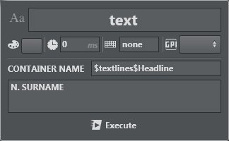

Text
This menu lets you set text in the selected container. The action supports standard text geometry as well as Text introduced in Viz Engine 4.3.

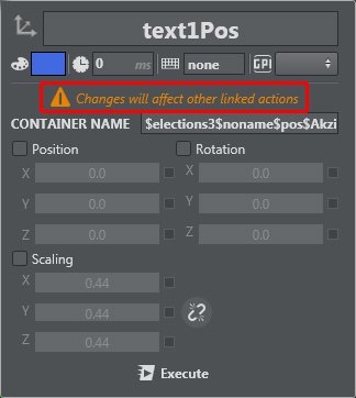

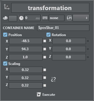

Transformation
Transformation lets you set position, rotation and scaling of the selected container. You can also scale in proportion by clicking the Lock icon  next to the scaling panel. Position, Rotation and Scaling can be disabled using the check boxes. When disabled, those parts are not being sent to the Engine on execution. For example, when selecting Rotation only, only the rotation of the target container is affected on execution.
It's possible to create a linked action for TRANSFORMATION actions. This option is useful for controlling different scenes with the same tree structure, for example.
To Create a Linked Action
Linked actions are useful for controlling different scenes with the same tree structure, for example.
Right-click on the panel and select Create Linked Action (or ALT + drag on an action box).
A new action box, cloned from the original one, is displayed. Both boxes have the linked icon at the top left corner.
The linked icon also appears on the box saved in the favorite area, if applicable.
Any changes that are now made to one of the related boxes affects them all, until the clones are removed.

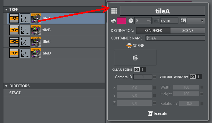

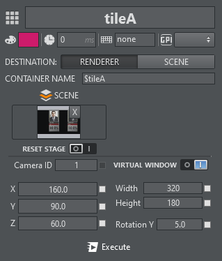

Viewport
Drag and drop a Viewport container plug-in from the tree view into the action canvas to create a Viewport Action.
Specify the Scene to be loaded to be loaded into the viewport or Clear Scene to clear the currently loaded scene of the viewport. Select Reset Stage to reset the stage on scene load. Camera ID selects the camera to be used within the viewport scene.
When Virtual Window is checked the selected position, rotation and width and height are sent to the viewport plug-in.

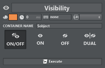

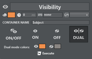

Visibility
Use the visibility menu to toggle a container on or off. The container can be set to ON, OFF, DUAL or toggled (switched to the opposite of the current state).
When DUAL mode is selected, left clicking Execute switches the container on and right clicking switches the container off. In the Dual mode colors section, two distinct colors can be defined for on and off states in order to make the state of the container more visible.
