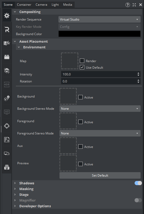

Global Settings Properties
In the Global Settings panel, the basic parameters for a Scene can be modified:

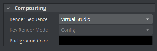

Compositing
Render Sequence: Defines how the alpha key signal must be generated (default is Overlay). These settings define how the compositor of Viz Engine generates the final fill and key signal.
Warning: Caution is advised when changing these settings.
The following render sequences are available:

Key Render Mode: (Classic Render Pipeline only)
Config: Renders the key according to the settings in the Viz Configuration (see the Configuring Viz section of the Viz Engine Administrator Guide).
Single Pass: Uses one rendering step. Use this for all new scenes and for scenes imported from version 2.8, as it is much faster.
Double Pass: Uses two rendering steps. Use for backward compatibility in scenes created in Viz Artist versions 3.0 to 3.3.

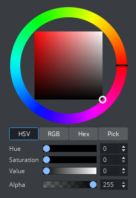

Background Color: Sets the color of the background.
Asset Placement
Environment Settings
The Environment Map for Viz Engine Rendering is defined in this section. It requires a prefiltered HDR Environment Map to be placed here. If no suitable map is available, Use default renders a blue sky environment map. This map defines how much environment map lighting is used as well as how "metallic" your objects are, the intensity may vary the output of your design. your environment can also be rotated, for example to put more specular light on your object.
Image and Media Asset Placement
Background: Adds an image or Media Asset as the Scene background.
Foreground: Adds an image or Media Asset as the Scene foreground.
Note: In the Viz Engine Render Pipeline, Post Processing Effects need to be turned on to see the Foreground in the Scene editor.
Preview: Adds a fixed layout to the Scene. This visualizes how the total preview (camera picture and/or graphics/Media Asset) looks. To set the image as global default, click the Set Default button.
Tip: It is possible to drag results from a database search onto the Background, Foreground, and Preview drop zones.

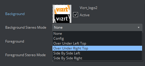

Stereo Mode: (license required) Selects the correct stereo mode for the inserted image (not available if Stereo Mode is set to
Offin the Viz Configuration (see the Camera page in the Configuring Viz section of the Viz Engine Administrator Guide):None: No Stereo mode.
Config: Images are drawn as set in the Viz Configuration (see the Camera page in the Configuring Viz section of the Viz Engine Administrator Guide).
Over Under Left Top or Over Under Right Top: Two images are stored, one over (top) and the other under (bottom), left or right eye (top) first. The image height is halved, providing half resolution.
Side by Side Left or Side by Side Right: Two images are stored, side by side, left or right eye first. The image width is halved, providing half resolution.

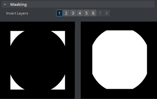

Masking
Invert Layers: Makes it possible to set one or more of the mask layers in a Scene to be inverted. With no mask inverted (1), the mask cuts out a hole where it covers the mask target object. With mask invert enabled (2), the mask target is only visible where the mask covers it:

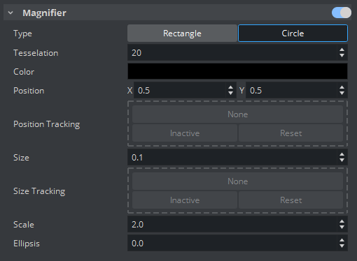

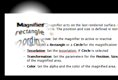

Magnifier
The magnifier is mainly used by Viz Sports products like Viz Libero or Arena. It acts on the last rendered surface. It can be either a rectangle or a circle. The position and size is defined in normalized view-port coordinates.
Compatibility Info: The magnifier works in the Viz Classic Render Pipeline only and only is available if the Render mode is set to Classic.
Active/Inactive: Sets the magnifier to active or inactive.
Type: Selects a Rectangle or a Circle for the magnification area.
Tesselation: Sets the tessellation, if Circle is selected.
Transformation: Sets the parameters for the Position, Size, Scale and Ellipsis of the magnified area.
Color: Sets the alpha and the color of the magnified area.
Container: Selects a Container to control the position and, or, the size of the magnifier. Drag the Container to be tracked in the desired box.

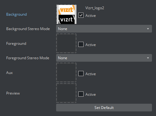

Images as Background or Foreground
This section details procedures with images use as background, foreground and preview.
To Add an Image
Click Asset View.
Click the I tab for Images (1).
Drag the required image onto the drop zone (2). A thumbnail of the image is shown in the drop zone button. Dragging a new image onto the drop zone automatically replaces the old image.
To Remove an Image
Drag the image from the drop zone to the trash can or double click on the blue label.
To View an Image Source Project or Folder
Click the image on the drop zone. The project or folder it is placed in is visible. If the image is linked, the first project or folder is selected.
To Show/Hide an Image in the Scene Editor
Click the Active/Inactive button next to the drop zone (3). If the image has a different aspect ratio than the screen resolution, the image is stretched to fit.
