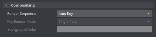

Select Arena Image-Based as Render Sequence in the Global Settings Panel.
During scene design, the Foreground Image can be set to Active, however, when the scene is completed and ready to be taken On Air, the Foreground image must be set to Inactive to allow only the key information to be applied. This procedure works with both Fast Texture Mode and Normal Texture Mode, and requires Arena/Libero to be set as Render Sequence in the Global Settings Panel. Viz Arena can be used to deactivate a currently activate image mask, transfer new image masks, or activate one of the previously transferred image mask using the corresponding mask ID.

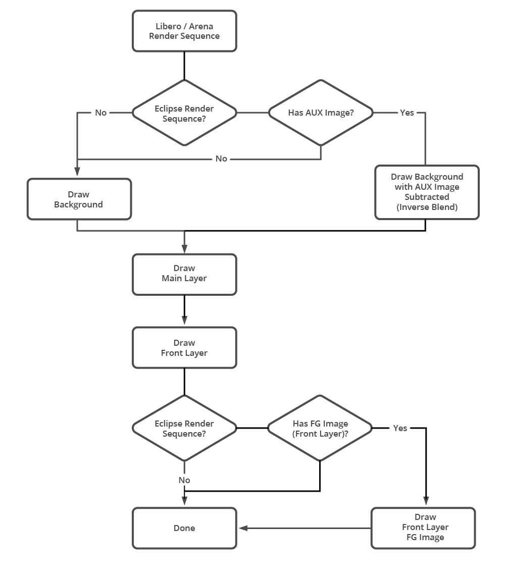

Eclipse Render Sequence (based on the Arena Image-Based Render Sequence)
This render sequence's logic is equal to that of Arena Image-Based (formerly known as Arena/Libero) Render sequence, except for the changes depicted below.
