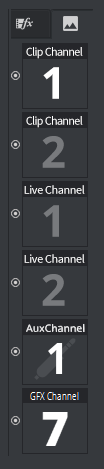

The Media Asset overview lists all Media Assets being used either as DVE, Texture or as Hybrid Surface.

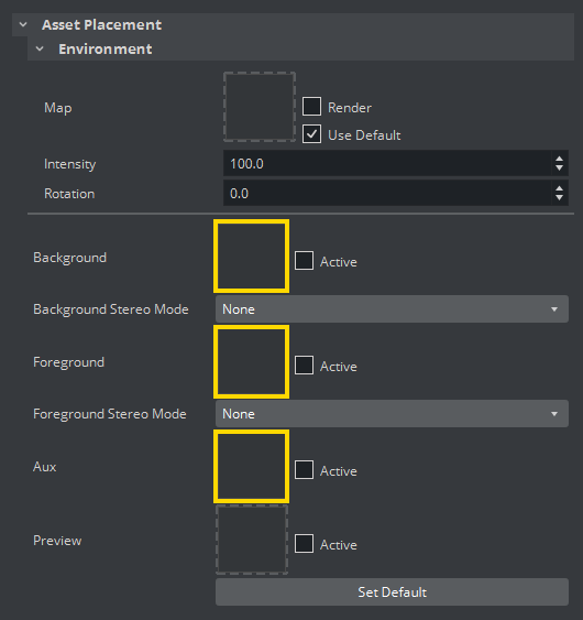

or drag a Media Asset to the Background, Foreground or Aux drop zone in Scene > Asset Placement.
If a Media Asset is dragged to the Background or Foreground drop zones, it is applied in the Scene as a full screen texture.

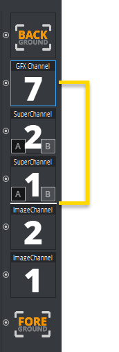

The Media Manager lets you set the rendering priority of Media Assets, by the way they are ordered. To change an asset's priority, drag it to a new position, a white line indicates the final destination. The asset with the highest Order value is rendered on top, with declining Order values below it.
Information: Reordering is available for Media Assets as DVE only.

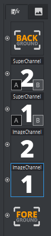

The Background and Foreground Media Assets are, by default, added as DVE layers. The Background Media Asset is always the first Media Asset to be rendered. The Foreground Media Asset can be ordered the same as other Media Assets.

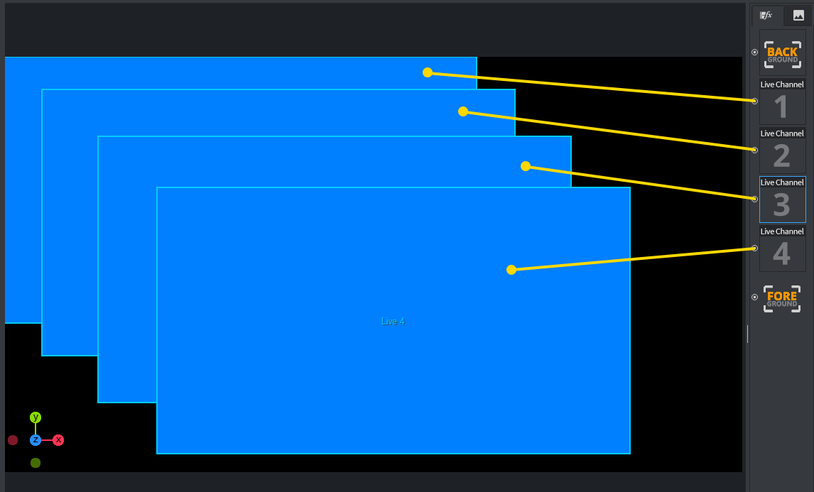

The order of each DVE Media Asset determine the order how each Media Asset is rendered. The first Media Asset in the list is rendered first, the second is rendered next, and so on. See the image below:
Example 1: The Live Input order is 1, 2, 3 and 4. So Live Input 1 is rendered first and Live Input 4 is rendered last.

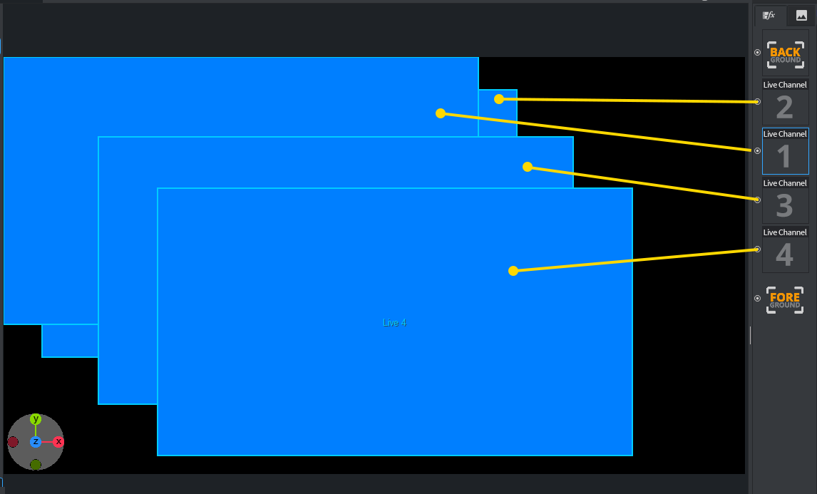

Example 2: The Live Input order is 2,1,3 and 4. So Live Input 2 is rendered first and Live Input 4 is rendered last.

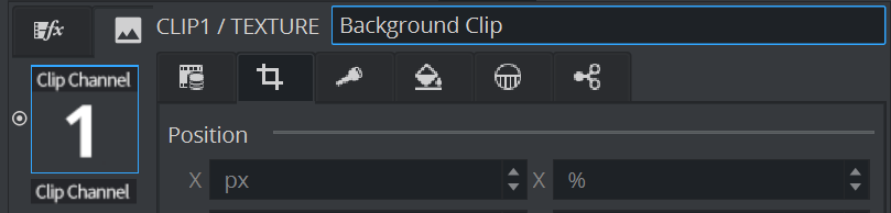

To Name Media Assets
Media Assets can be named.
