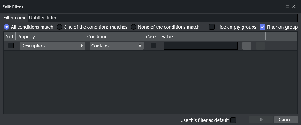

Playlist Filters
Playlists can be filtered to quickly sort the list of events.
Adding a Playlist Filter
To add a playlist filter
  1. Click the Funnel icon, and click New.
    • The Edit filter window opens.
  2. Enter a Filter name.
  3. Select whether the filter should apply if:
    • All conditions match.
    • One of the conditions matches.
    • None of the conditions match.
  4. Select whether or not to Filter on Group.
  5. Continue to define your filter by adding conditions.
    The list of events is filtered as you define your conditions, allowing you to verify that the filter is configured correctly.
Managing a Playlist Filter
To manage a playlist filter
  1. Select your filter.
  2. Click the Funnel icon and from the menu click Edit or Delete.
