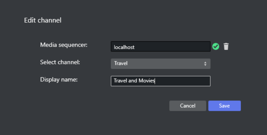

Working with Channel Connections
Creating a new channel connection
To create a new channel
  1. Fill in the Media Sequencer textbox with a valid sequencer hostname in the connection form.
  2. Press the checkmark to establish the connection.
  3. From Select channel, choose a playout channel.
  4. Adjust Displayed name for the channel if it is not sufficiently descriptive.
  5. Press Connect to start monitoring.

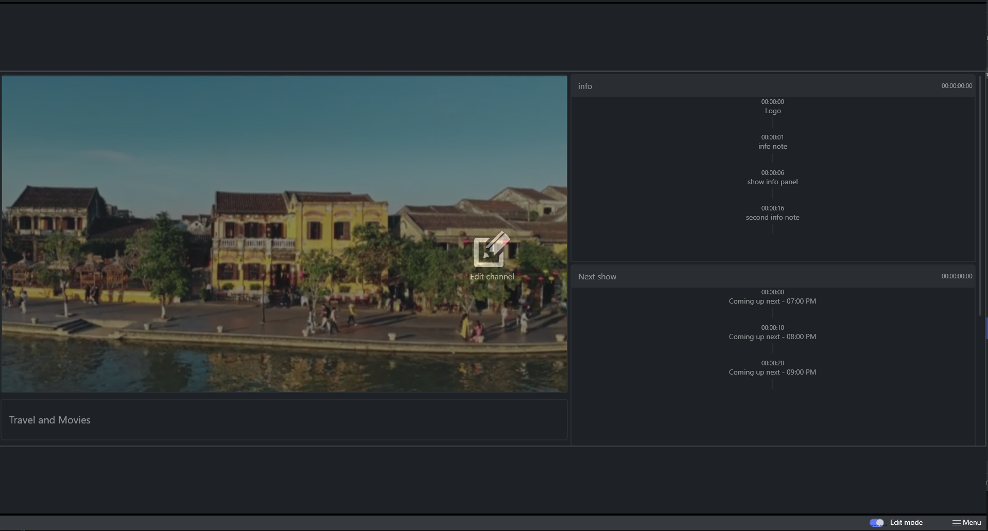

Edit Mode
Edit mode allows setting up a new channel connection, and editing an existing one.
To edit an existing channel
  1. Toggle the Edit Mode slide button.
  2. If a channel already has a connection, hover over the channel and click Edit channel.
  3. This opens the Edit channel form.
  4. You can change values for:
    1. Media Sequencer
    2. Channel
    3. Display Name.

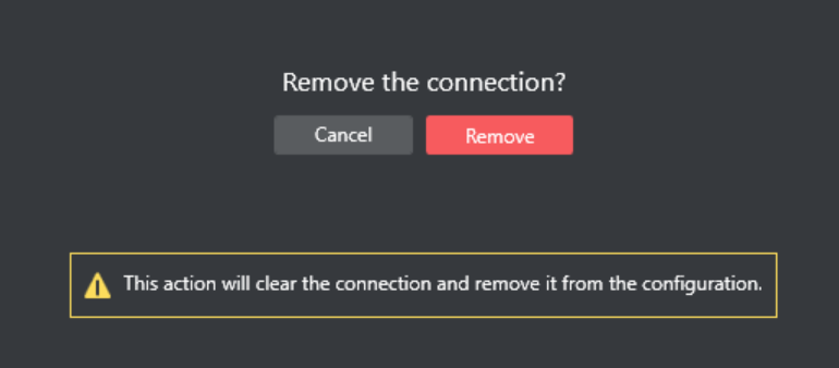

To remove an existing channel
  1. Open the Edit channel form.
  2. Click on the Trash can icon.
  3. Click Remove.
  4. This removes the channel from the configuration and closes the connection.
    (Click Cancel to return back to the Edit channel form).
