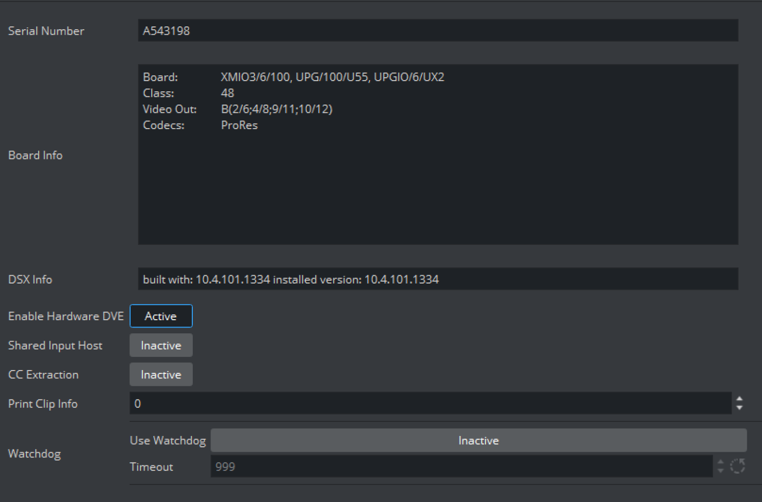

The General Properties Panel shows information about the installed hardware.
  • Serial No.: Shows the serial number of the installed Matrox board.
  • Board Info: Shows the model and type of the Matrox board.
  • DSX Info: Shows the software version and driver version.
  • Enable Hardware DVE (former Fast Texture Mode): Disable to shorten the ’in out’ delay in Texture Mode to a minimum.
Note: If Enable Hardware DVE is set to Inactive, DVE does not work (see Video Clip Playout Considerations and Video Playout in the Viz Artist User Guide).
  • Shared Input Host: Used to share the input with other Viz Engine instances.
  • CC Extraction: Enables or disables the closed captioning extraction for Matrox X.mio3 - DSX LE 4.
  • Print Clip Info: Enables printing of clip information to the console when activated. However, such information may cause the render loop to stall. Default mode is Inactive.
  • Watchdog: Sets a timer that allows a system to continue video pass-through during an application crash or system failure (see also Watchdog (Matrox X.mio3 Series) and Video Board):
    • Use Watchdog: When set to Active enables the Matrox X.mio watchdog feature. It passes the input signal to a hardcoded output port as soon as Viz Engine is unresponsive. Default mode is Inactive.
    • Timeout: Sets the time, in milliseconds, until the watchdog takes over control. This value should not be smaller than the time of two fields/frames. Default value is 999 ms.
Note: Use Watchdog and Timeout can also be set and changed in Video Board.
  • Genlock
    • Use Flywheel: Adopts a tracking mode if the genlock signal is interrupted or lost that maintains the signal frequency until the source genlock signal is regained when activated. Default mode is Active.
    • Max Recovery Time: Represents the time in milliseconds (ms) provided to the flywheel to attempt to regain the genlock before an abrupt jump to the locked state is performed. Default value is 15.
    • Max Unclock Time: Represents the time in milliseconds (ms) provided to the flywheel to remain in the unlocked state before switching to the free running state. Default value is 15.
