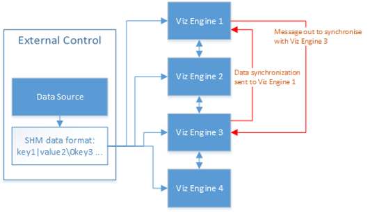

If a Viz Engine is restarted or added to the cluster of Viz Engines for playout, the VizCommunication.Map data is not available on this Viz Engine. The local map on a new or restarted Viz Engine can be synchronized with the local map on another running Viz Engine in the same cluster.
A start-up Viz Engine can be synchronized through:
TCP
UDP
An External Control Application
Commands
Example: If Viz Engine 1 restarts it looks to Viz Engine 3 to update its local VizCommunication.Map.

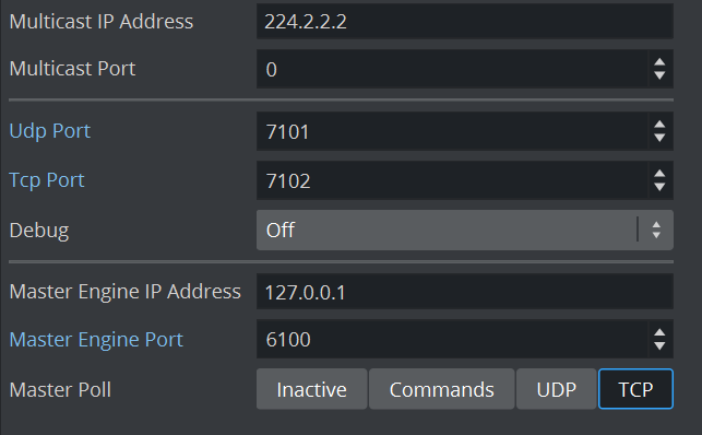

To Synchronize a Viz Engine with TCP or UDP
Go to Viz Configuration.
Click on Communication.
Click on the Shared Memory Properties tab.
Enter the TCP or UDP port number.
Note: Always make sure that the selected port number is not in use by any other program on the same subnet. This is important for systems running multiple instances of Viz Engine.
In Master Engine IP Address, type the IP address of a running Viz Engine to synchronize with. Example <IP/hostname of Viz Engine 3>.
Note: Must be the IP address of a running Viz Engine in the same cluster system.
In Master Engine Port, type the port number to be used (default
6100).This port sends the single startup synchronization command to start synchronizing. It should be the same as the general communication port of the Viz Engine set in Master Engine IP Address.In Master Poll, select UDP or TCP as selected in step 4.
Click Save.

To Synchronize a Start-up Viz Engine with Commands
In the Shared Memory panel set these parameters:
Master Engine Port: Enter the communication port of the primary Engine (default is
6100).Master Poll: Click on Commands.
Click Save.
