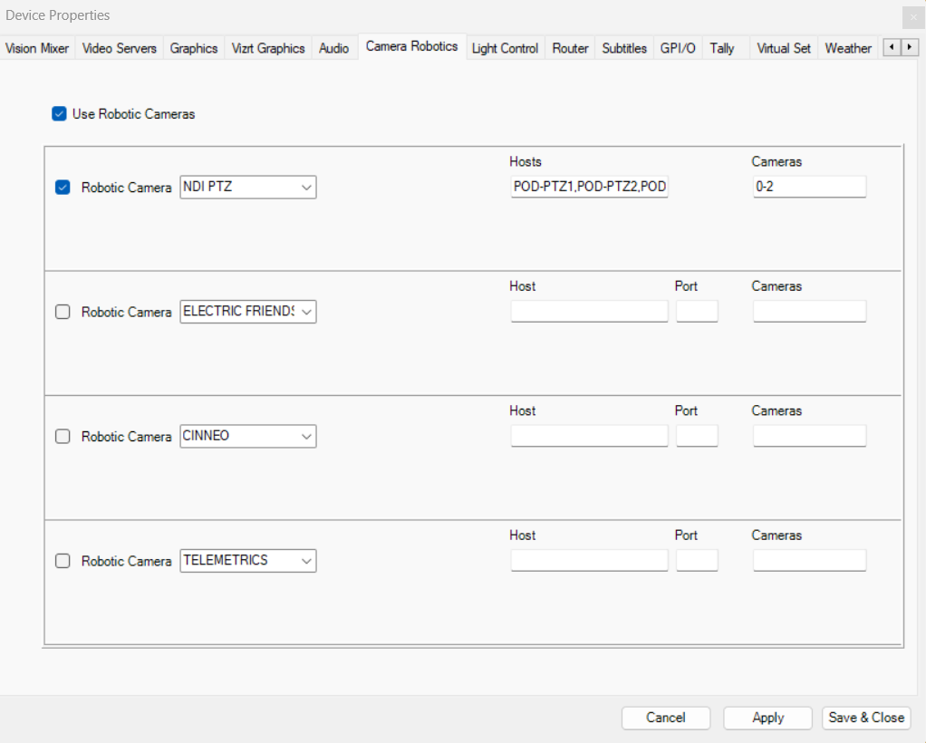

Examples:

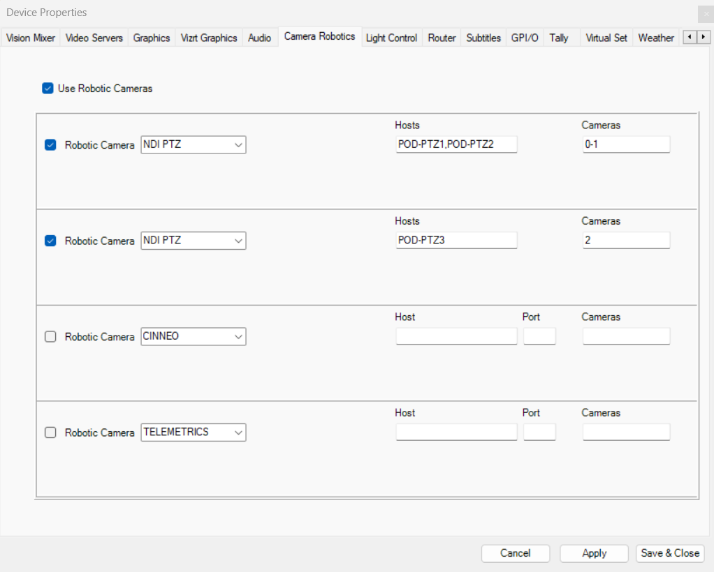

For NDI PTZ, you can configure multiple controllers each with one host:
or a controller with multiple hosts. This allows you to use the remaining controllers for other types of robotic cameras:
Or you can have combinations like following:
If multiple hosts are configured for a controller, the cumulative status will be shown in AV Automation and Mosart UI. If at least one host which is not in stand-by is not connected, the overall status will show disconnected (red). In the Standby menu in AV Automation however, you can see the status per device.
If, on the other hand, only a single host is configured for a controller (like the second controller in the figure above with Hosts PD-PTZ3 and Cameras 2), the status of that host is shown in AV Automation and Mosart UI.
