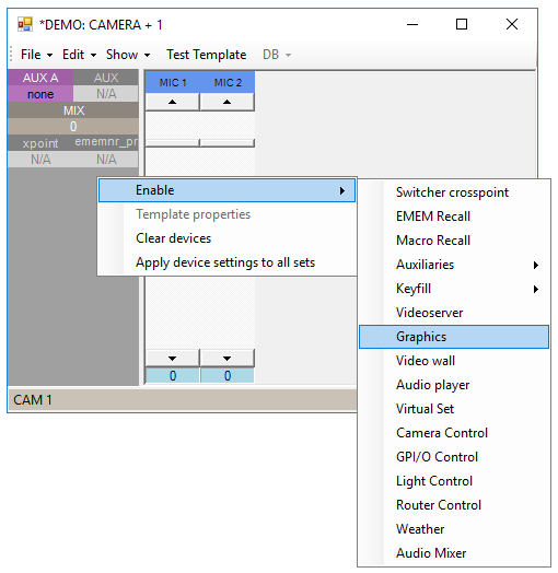

Right-click inside the device function area to open a menu containing the following options:
  • Enable: These commands are described in more detail below.
  • Template properties: Opens the current template's properties page, see Template Properties in section Working with Templates.
  • Clear devices: Removes all devices from the device function menu, after confirming in a pop-up message window.
  • Apply device settings to all sets: Applies all the device settings to all templates of same type and variant throughout all template sets.
  • Mark as intentionally empty: This option is available for empty templates only and shows up when the Use ‘Mark template as empty’ feature is enabled in Settings Editor MOS-General. See Empty Templates for more details.
To Enable Device Functions
  1. Right-click in the device's Function area (black row).
  2. Select the device to configure from the Enable menu.
    This opens the edit box for the selected device.

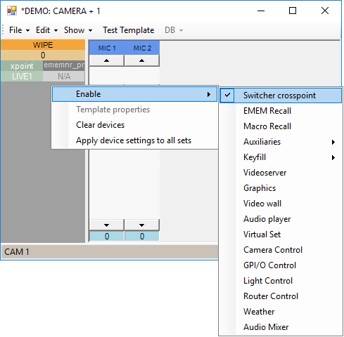

Video Switcher Crosspoint
The video switcher crosspoint enables switching on the video switcher. The A or B bus assignment of the mixer effect (PP/MEx) is automatically handled by the automation.
Guidelines for Video Switcher Crosspoint Configuration

Video Switcher Transition
The transition device is only available when video Switcher crosspoint is enabled.
To Define Video Switcher Transitions
This procedure is based on the example in the screenshot.
  1. Click on MIX/WIPE/EFFECT to cycle through these three transition types.
  2. Click directly on the selected value (in the screenshot above, this is either 0 or 1).
  3. Enter
    1. The default duration (in frames) for the Mix/Wipe transition, or
    2. The effect number for the effect transition.
The transition is performed with the auto-transition functionality in the video switcher.
Usage and Tips
  • To do a cut, use a MIX transition with 0 frames duration.
  • To add a mix delay, right-click on the device (MIX/WIPE/EFFECT), select the number (below Disable), and enter another number (in frames).
    Adding a mix delay delays the start of the transition, compared to other device commands, when the template goes On Air.
  • To disable the transition, right-click over the device and select Disable.

Graphics
The Graphics device enables recall of graphic elements.
  •  Graphic elements are cued (loaded) in Preview and played (started) when taken to Program.
Guidelines for Graphics Configuration
Engine
Selects the engine to operate on when using this template, based on your configuration.
See section Graphics.

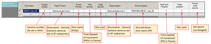

Robotic Camera Control
The camera control device allows for recalling camera shots (and pre-programmed moves) when the template is cued in preview or aired in program. The device editor supports salvo recalls of shots by adding multiple lines for each shot recall.
The Standard Robotic Camera Control Properties are described below, as well as exceptions for specific camera types.
Guidelines for Standard Robotic Camera Control Configuration

Electric Friends Robotic Camera
For Preview use:
  • Page Preview: Show and Robotic camera name separated with a colon (e.g.: ShowName:Cam 1).
  • Preset Preview [Optional]: Shot name. Shot attributes: prepare, prepareplay and loop. Separated with a colon (for example, prepare:ShotName and prepareplay:ShotName).
  • Time Preview [Optional]: Duration for move in frames. The time is rounded up to the nearest second.
For Program use:
  • Page Program: Show and Robotic camera name separated with a colon (e.g.: ShowName:Cam 1).
  • Preset Program [Optional]: Shot name. Shot attributes: prepare, prepareplay and loop. Separated with colon (for example, prepare:ShotName and prepareplay:ShotName).
  • Fade time Program [Optional]: Duration for move in frames. The time is rounded up to the nearest second.
