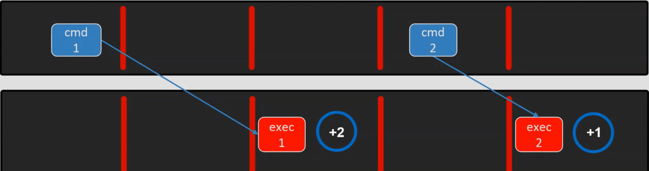

Unless it is known where in the frame the Viz Mosart command is issued, the response from the equipment will always be arbitrary.
In the figure below, the red bars represent the start of a frame. The outgoing Viz Mosart commands (cmd 1, cmd 2) are now aligned with the start of the frame grid (frame accurate).
Tip: The illustrations in this section are animated. If you are viewing a PDF, we recommend the online version.
This provides deterministic behavior from the controlled equipment, as the equipment is always given exactly the same amount of time to respond (in the above figure, after one frame).
Without frame accuracy, cmd 1 might be fired already somewhere in the first or second frame above, and the gear will not operate at the anticipated frame, giving unpredictable results.

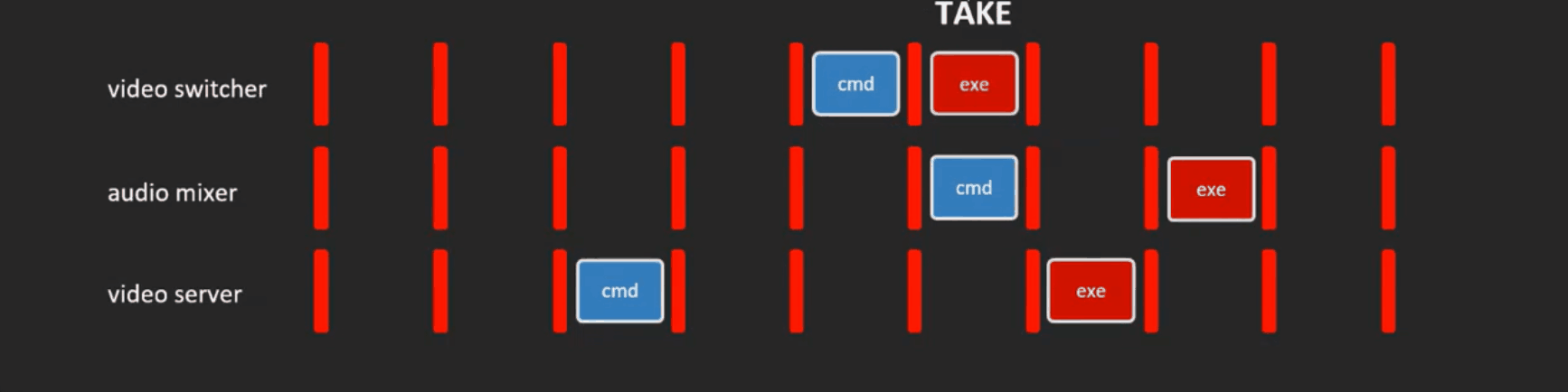

Latency Compensation
In non-frame accurate systems, Viz Mosart only compensates for delays in the behavior of the playout video server.
With frame accuracy, Viz Mosart can compensate for any latency of the controlled equipment.
As a pay-off of Predictable Behavior of Equipment, a calibration process can reveal the latency of each piece of gallery equipment.
Viz Mosart can then compensate for these delays, by always executing commands earlier.
In the figure above, the three devices (video switcher, audio mixer and video server) have millisecond latencies of 1, 2 and 3 frames respectively.
After compensating by executing each command specifically earlier, Viz Mosart can now successfully perform the TAKE command, synchronized for all three devices, from the same frame.

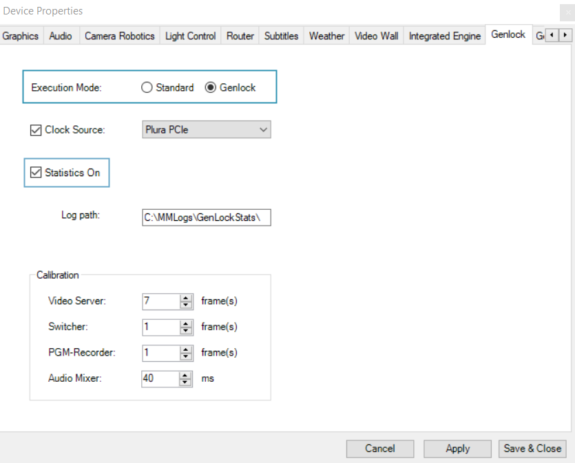

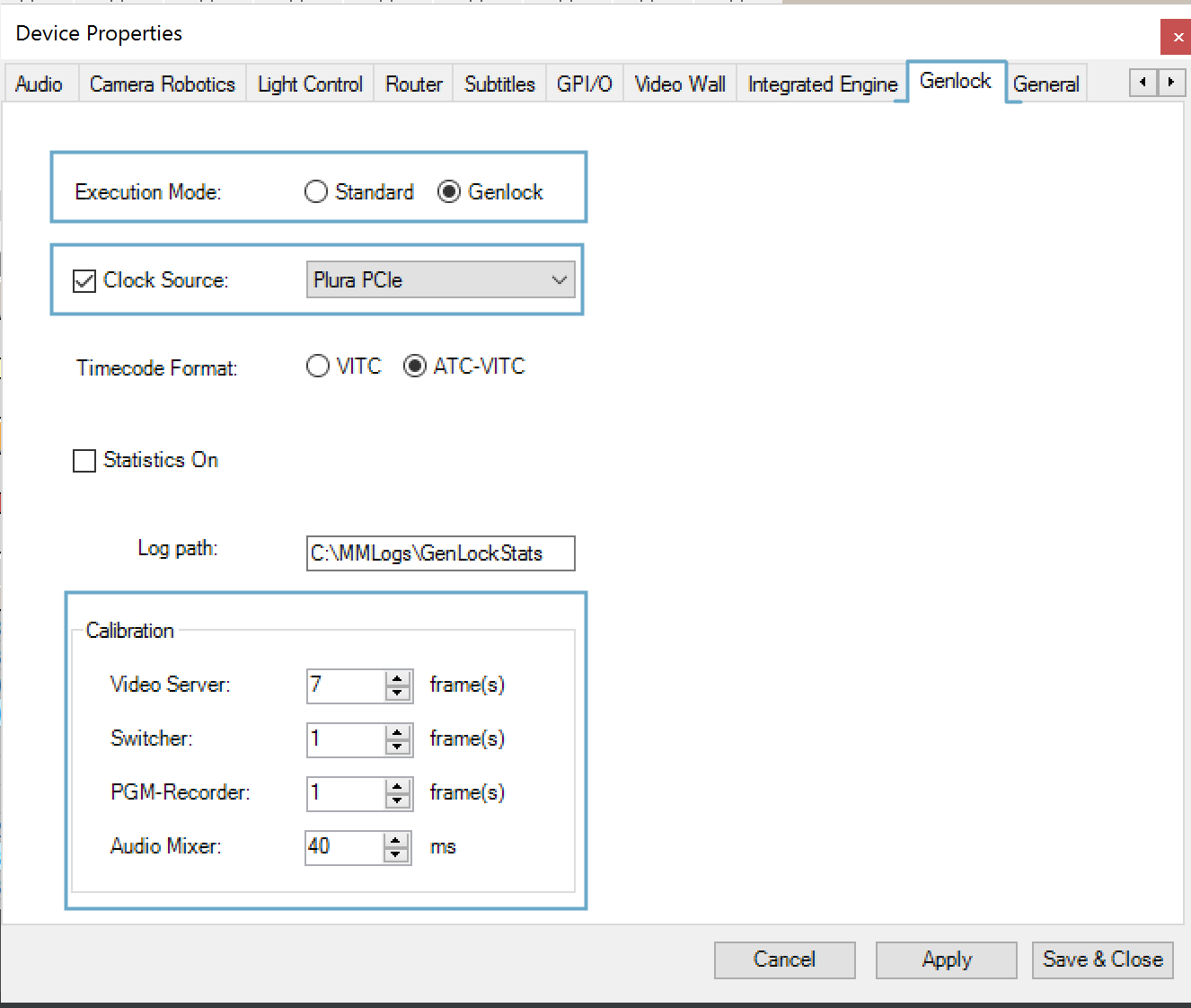

To activate frame accurate operations
Frame accuracy related settings and options are made in Av Automation.
Navigate to Devices > Properties > Genlock tab.
Select
Execution Mode: Select Genlock mode.
Clock Source: When checked, select which genlock / timecode card is installed, if any. By default, this is Plura timecode reader card (and for time being, the only option).
Calibration: These are the individual latencies of the gear being controlled, as derived when calibrating the system.
Click Apply, then Save & Close.
Combinations of the configuration above for Execution Mode and Clock Source settings:
Execution mode | Clock Source | Logic |
Standard | Not selected | Classic mode. No timecode in the Viz Mosart logs. No statistics can be performed. |
Standard | Selected | Classic mode. Timecode from the selected clock source (by default, this is Plura PCIe and the only supported option) is written in the Viz Mosart logs generated from AV Automation. |
Genlock | Selected | Frame accurate behavior when executing Viz Mosart templates during a show. A clock source is required. Timecode from the selected clock source (Plura) is written in the Viz Mosart logs, generated from AV Automation. Viz Mosart falls back to the internal clock source if the selected clock source is detected as inaccurate. |
Genlock | Not selected | Not allowed. Viz Mosart will fall back to Standard execution mode, with no timecode. |

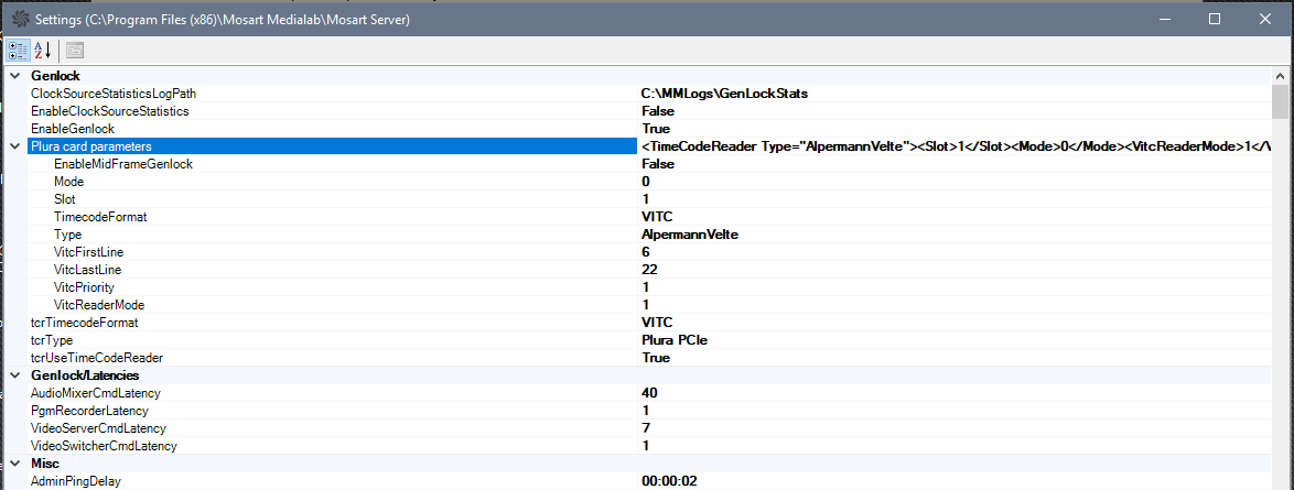

Open the AV Automation Settings (user.config file).
Use keyboard shortcut Ctrl+Shift+S in AV Automation.If any changes have been done on the Genlock tab in AV Automation properties (see To activate frame accurate operations above),
click the Apply button or close the Properties window and enter Ctrl+Shift+Q for the changes to take effect.

To start clock source statistic gathering
You start/stop statistics in AV Automation.
Execution Mode: Genlock
Clock source checked and a clock source selected.
Statistics On: Selected
Specify the location where you wish to save the stats in field Log path.

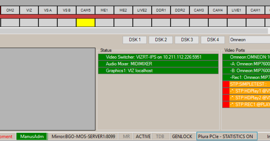

Check the indicator in the AV Automation status bar at the bottom of the screen, that statistics are on:
Measurements will be performed for about 8-10 minutes
