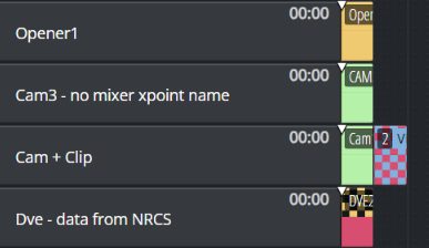

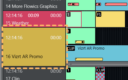

Each story line consists of a Story info area to the left and a representation of the Viz Mosart templates and secondary elements (extracted from Viz Mosart commands in the NRCS), in the Timeline view to the right.

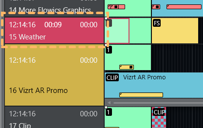

Story Info
The left Titles and Timings area (also called Story Info area) displays the following details:
  1. Top left hand corner: Estimated On Air time (11.53.23 in this example).
  2. Timer in the middle of first line: When the story is on air, how long the story has been running.
  3. Top right hand corner: The editorial duration of the entire story, as entered in the NRCS.
  4. Second line: The story title as entered in the NRCS.
  5. Red marking: The story currently on air.
  6. Yellow marking: The next story that will be taken to air.

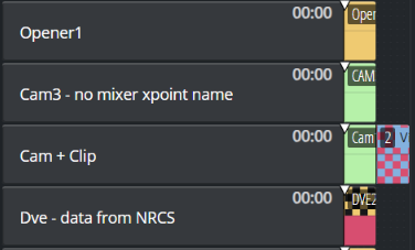

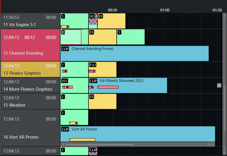

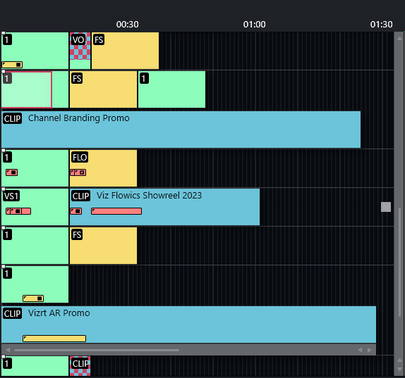

Timeline
The Timeline provides a story-by-story chronological, controllable, real-time monitor of the current rundown.
For an explanation of the details presented in this view, and the operations available, see section Operating from the Rundown View.
Story Elements
Templates are represented in the right hand, Timeline area using color-coded elements. The length of each element reflects the calculated or exact duration of the template, depending on the template type.
  • An identifier in the top left corner denotes the variant name of the template type.
  • A story using a recognized template type but an invalid variant displays the variant title in red:
  • When a story contains several elements with long duration, a vertical scroll bar appears to the right (one story will not display over more than four story rows in the Viz Mosart GUI).
  • Stories with no corresponding Viz Mosart commands appear as empty lines in the timeline.
Story elements are described in detail in the following sections:

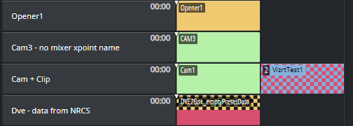

Template Types: Primary Story Elements
A story element corresponds with a Viz Mosart template type. From each basic template type, a show designer creates clones with show-specific commands. Each clone is called a variant
Camera
A Camera template is displayed as a green colored element in the GUI. The variant of the template type (often the camera number) appears in the top left hand corner. The duration of the template is automatically calculated based on the presenter's script as entered in the NRCS (see Story Editorial Time below).
Package
This template type is for playing (or recording) a video clip.
The package template type is displayed as a light blue element in the GUI. The variant identifier appears in the top left hand corner. The length of the package element is calculated from the actual clip length, if available on the video server.
Info: Error Situations
  • If the package clip is not available from the video server, the template representation appears with a blue/red checkered pattern.
    Similarly, placeholder clips are displayed with a white/blue-checkered pattern.
  • Zebra-stripes mean that the video server has failed to cue clip for playing.
Keyframes
In some systems, Keyframe markers are displayed with grey semicolon markers:
Voiceover
A Voiceover template is displayed as a light blue and green element in the GUI. The variant of the template type is indicated in the top left hand corner of the colored element. The small notch in the green bar shows the calculated duration of the presenter text. The light blue represents the clip as with the server template type and the green represents presenter text as with the camera template type. If the clip is not available from the server, the clip section of the element has a checkered pattern.
The length of the voiceover element is calculated from the actual clip length when available on server.
Live/external Source
A Live template is displayed as a red element in the GUI. The variant of the template type is indicated in the top left hand corner of the colored element.

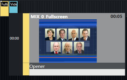

Graphics
A Full screen graphics template is displayed as a yellow element in the GUI. The variant of the template type is indicated in the top left hand corner of the colored element. Duration of the element is timed from the presenter text entered in the NRCS.
For graphics systems which support this feature, the element has a checkered pattern if the attached graphics content is not available for playout from the graphics system.
Info: If back-to-back full screen graphics are within in the same story (and use the same engine), the scene is not retaken for each graphic, but just kept playing. As the show advances, and one story is left, a new story entered, the graphics are taken again (the engines are ejected) so that any other graphics that are using the same engine are taken normally.
Digital Video Effect (DVE)
A DVE template is displayed as a yellow and red element in the GUI. The variant of the DVE template type is indicated in the top left hand corner of the colored element.
Telephone
A Telephone interview type is displayed as a yellow and white element in the GUI. The variant of the template type is indicated in the top left hand corner of the colored element.

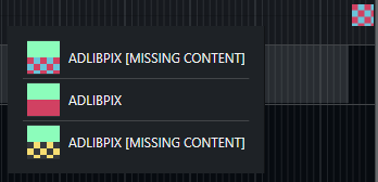

AdLib Pictures/Floats
An Adlib pictures template is represented by a symbol at the right end of the story line on the timeline. If the associated media object is not on the server, the symbol is checkered.
The element also appears in the Assets window as a colored slug with a green top half and light blue bottom half for clips, and orange bottom half for graphics. They can be taken on air or to preview either by right-clicking and using the context menu in the Timeline or the Assets pane.
Adlib picture templates adds the audio faders specified in the template to the current audio fader set. The faders are subtracted when returning from the Adlib pictures. Adlib pictures are typically used in live external or studio interviews.
Adlib pictures pause when it is taken off air. If the Adlib picture is inserted again, the clip continues from the paused point.

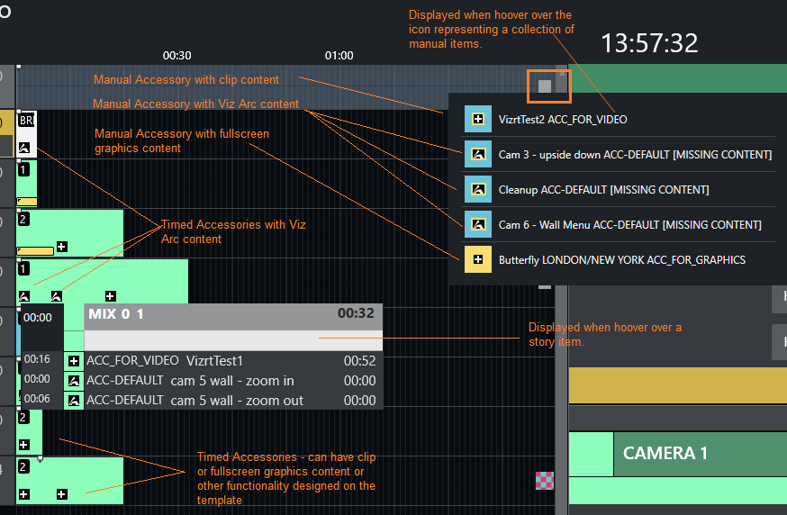

An Audio Player secondary element is displayed as a small speaker symbol on top of a primary template. Its position represents the time code given in the NRCS. The audio starts to play when the timeline reaches this position. If no in-time is defined for the sound, it appears as a manual element in the symbol in the right hand area of the rundown (where manual lower thirds and adlibs are shown).

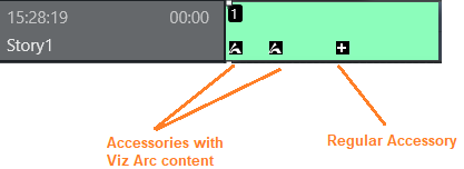

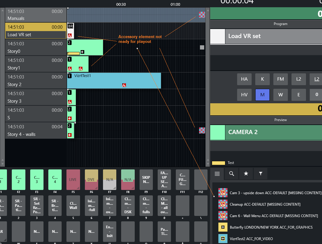

Accessory Elements

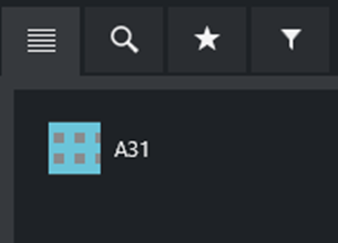

Accessory secondary elements are usually displayed as a small, black background plus (+) icon, on top of its primary template .
However, the icon will change slightly to reflect the content type driven from the newsroom system. For example, if the Accessory item holds Viz Arc related content (in this example, three items), the icons are visualized as follows:
Taking an Accessory element
There are two ways to use an Accessory element. This relates to how they are taken:
  1. Automatic: (timecode driven) The element's display position represents the timecode provided in the NRCS. The Accessory item is taken when the timeline reaches the accessory icon.
  2. Manual: If no in-time is defined for the Accessory item, it is displayed as a manual element, with its icon to the right of the rundown, similar to where manual lower thirds and adlibs are displayed.
Tip: Mouse-over an Accessory element (manual or automatic) to see further details.
Example of Accessory Elements in a Rundown
Color coding
  • Black background: Normal, the element is available.
  • Red background: The Accessory template does not exist/is unavailable or an error is reported related to the content.
  • Checkerboard background: Content is not available (for example, with clips or full screen graphics).

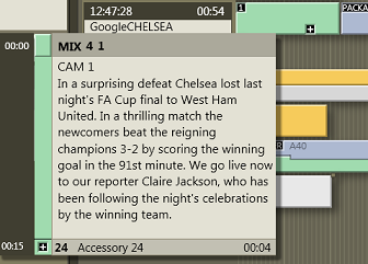

Mouse-over Rundown Info
Hovering the mouse pointer over an element in the rundown displays the NRCS script and timed commands connected with the story element.
In this example, mousing-over the Camera 1 element displays the transition which is used going into the template: A four frame mix and the template variant 1.
In addition, the entire script written into the NRCS story connected with this template is visible, along with details of a secondary Accessory template element.

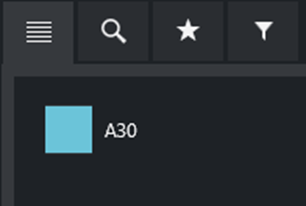

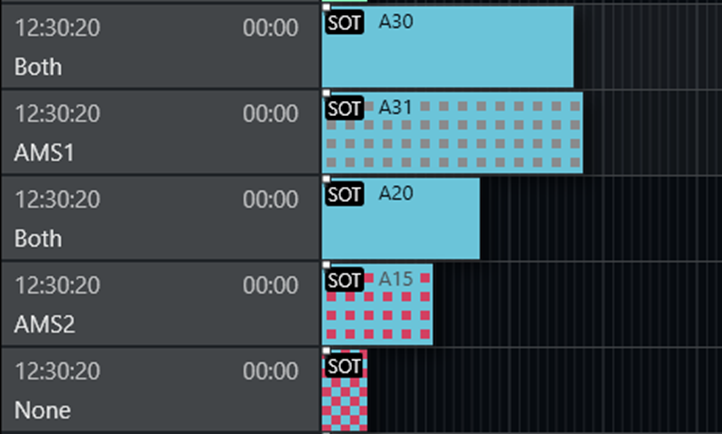

Clip Status on Current and Mirror Server
When a current-mirror server pair is employed for redundancy, a clip will be either available or unavailable on each server in the pair.
Color coding and patterns of the corresponding Package template, report the status of the clip on each server, guiding the operator to switch to the the server where the clip is available.
Appearance of Package template
Clip status
Blue
Current server: Available
Mirror server: Available
(See A30 below). This blue template representation appears in the Script, Rundown and Asset panes.
The coloring is also displayed in any mouse-over Tool tip.

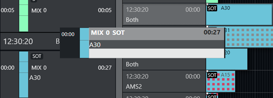

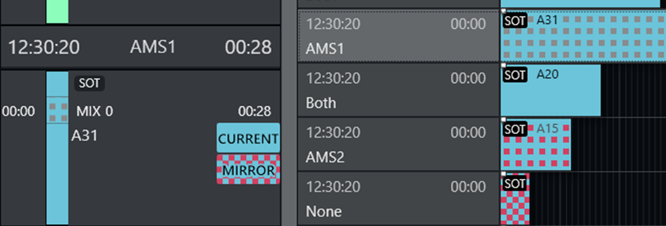

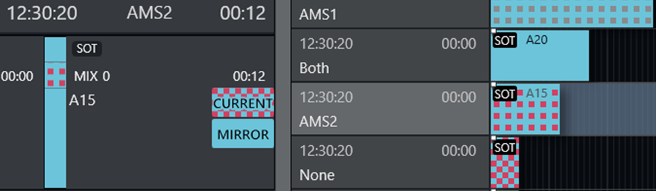

Blue / Gray
Mirror server: Unavailable
(See A31 below). This blue/gray template representation appears in the Script, Rundown and Asset panes.
In the Script and Tooltip panes (see above)
  • the label CURRENT has a blue background, this is the server with the clip available.
  • the label MIRROR has a red on blue checkered background.
    Do not switch to this server, the clip is unavailable!

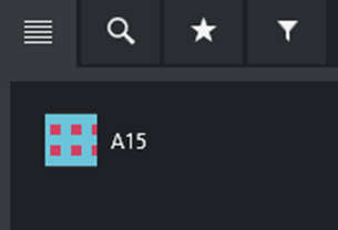

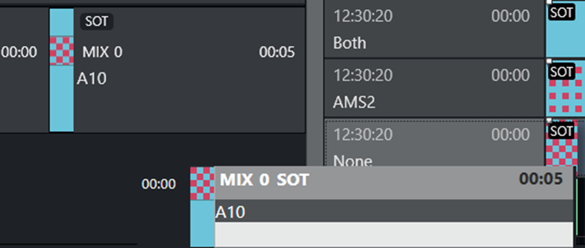

Red on Blue checkered
Current server: Unavailable
Mirror server: AvailableHovering the mouse pointer over an ele
(See A15 below). This blue/red template representation appears in the Script, Rundown and Asset panes.
  • the label MIRROR has a blue background, this is the server with the clip available.
  • the label CURRENT has a red on blue checkered background.
    Switch to MIRROR, the clip is unavailable on this (CURRENT) server!

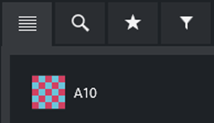

Blue on Red checkered
(See A10 below). This blue/red template representation appears in the Script, Rundown and Asset panes.
This is a potential failure situation that must be addressed, as the clip is not available for playout!

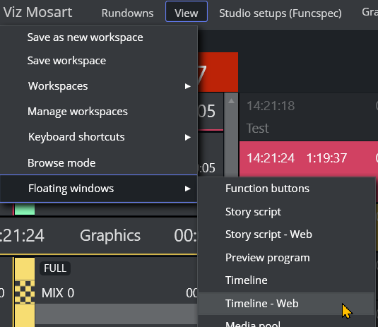

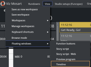

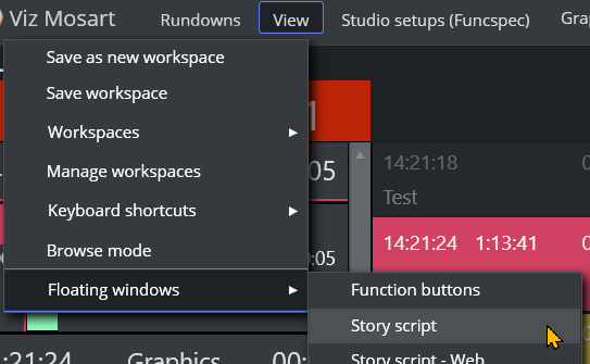

Floating Windows
Timeline
You can open the Timeline as a separate window, either fully operational or as a read-only copy.
To float the Timeline window
All operations are available from the floated window.
  1. From the menu bar select View > Floating windows > Timeline.
  2. Position the floating window by dragging its menu bar and adjustable frame handles.

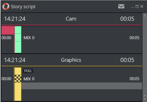

Story Info
You can open the Story script floated as a separate fully operational window or as a read-only copy.
To float the Story script window
  1. From the menu bar, select View > Floating windows > Story script.

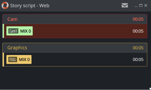

Mosart Web Apps View
As part of a modernization and optimization improvements to Viz Mosart, much of the existing Viz Mosart feature set is also offered as simple web-based apps, that run on any browser in the Mosart network. For further details, please refer to the Mosart Web Apps documentation.
Viz Mosart can display both the Timeline and Story script floating windows with the enhanced appearance and details of the newer Web Apps.
These ‘web’ views offer improved scaling and ability to see truncated details, by resizing the window, and can be docked by using the Workspace editor.
Timeline
You can display a floating window with a read-only copy of the Timeline, similar to its appearance in the Mosart web app.
To view the Timeline window with web app details
  1. From the menu bar, select View > Floating windows > Timeline - Web.
Story Script
You can display a Floating window with a copy of the Story script, similar to its appearance in the Mosart web app.
To view the Story script window with web app details
  • From the menu bar, select View > Floating windows > Story script - Web.
This scalable view offers advantages in readability and clarity when monitoring the ongoing show.
Info: Both Floating windows Story script -Web and Timeline - Web require a once-only installation of the Mosart Web Apps as explained in the Mosart Web Apps documentation.
