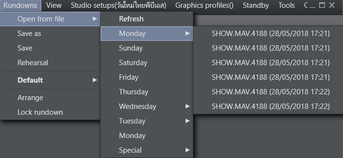

The Rundowns item contains the following options:
Open from file. Lists rundowns found in the folder mentioned above. Normally stored at C:\Manus.
Refresh. Refreshes the list of available rundowns.
Between Refresh and Special there are eight menu options for 'today' (this and similar words not referring to the day of writing or the day of reading, but to the day of Viz Mosart use), yesterday, the day before yesterday, up to the day a week ago. The option names are the names of the days in the language of the user's computer. For each of these eight days, there is a sub-menu containing the timestamped rundown files saved on that day. (If none, there is no sub-menu.)Special. Lists the non-timestamped rundown files.
Save as. Saves the current rundown with a new name in the window that opens.
Note: Do not include an underscore ('_') in the name. Files with underscore in the name will be automatically deleted once Manus expiration time has been reached. See the Viz Mosart Administrator Guide, section Manus Administrator Configuration
Save. Saves the current rundown.
Info: By default, the location where rundowns are saved is C:\manus, but this may be overridden by the Manus Directory setting in the Settings Editor. Refer to the Viz Mosart Administrator Guide, section Manus Administrator Configuration.
Rehearsal. Enables rehearsal mode when selected. Click Rehearsal again to switch back to On Air mode. See Rehearsal and On Air Mode.
Info: Between Rehearsal and Arrange there may be additional options depending on the connected NRCS. For more information, see Managing NRCS Rundowns.
Arrange. Opens the Arrange rundowns panel.

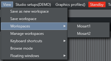

Workspaces. Selects from the available workspaces.
Manage workspaces. Opens the Manage workspaces window.

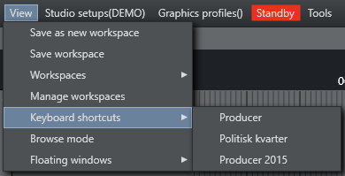

Keyboard shortcuts. Determines which Keyboard Layout to be used.

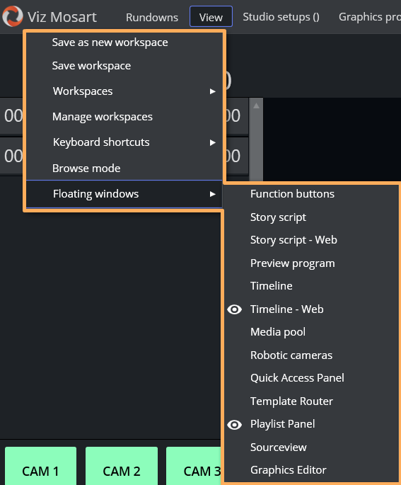

Floating windows. Lists both the different parts of the main window that can be released as separate windows, as well as windows that can be opened that are not part of the main window:
Note: The 'eye' icon indicates a floated window.
Releasing Windows
Function buttons. Releases the Keyboard buttons panel. See Keyboard Shortcuts.
Story script. Releases the Script panel. See Story Script Window.
Preview program. Releases the Program, Transition and Preview panels. See Program Window, Preview Window, Video Transition Area and Audio Function Area.
Timeline. Releases the Rundown panel. See Rundown View.
Media pool. Releases the Media pool panel. See Media Pool.
Opening Windows
Story script - Web. Displays a web-based, read-only view of the Story Script Window.
Timeline - Web. Displays a web-based, read-only timeline view of the rundown. See Rundown View.
Robotic cameras. Opens the Individual Camera Controller window. See Robotic Cameras. See also Camera Robotics in AV Automation in the Viz Mosart Administrator Guide.
Quick Access Panel. Opens the Quick Access Panel. See Quick Access Panel.
Template Router. Opens the Video wall manager. See Template Router.
Playlist Panel. Opens a Media Sequence Engine (MSE) panel host. See section Configuring the MSE Playlist Panel in the Viz Mosart Administration Guide.
Sourceview. Opens a Sourceview panel. See Sourceview.

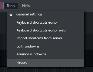

The Tools item contains the following options:
General settings. Opens the General settings dialog. See General Settings.
Keyboard shortcuts editor. Opens the Keyboard shortcuts editor. See Keyboard Shortcuts .
Keyboard shortcuts editor web. Opens the new web-based shortcuts manager. See Keyboard Shortcuts .
Import shortcuts from server. See Keyboard Shortcuts Editor (section Exporting and Importing Shortcuts from Server).
Edit rundowns. Opens Edit Rundowns panel. See Managing NRCS Rundowns. This menu option only appears when having a connection to iNEWS. When using other newsrooms systems, the menu option is not visible.
Arrange rundowns. Opens the Arrange rundowns panel. See Arrange Rundowns.
Record. Opens a recording panel to create a new video recording. See Recording.

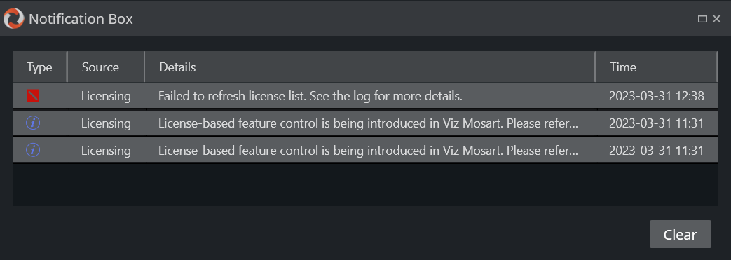

Notifications
The Notifications icon to the right also appears at the top of all menus. A red marker indicates an unread notification.
Clicking the icon. Opens the Notification Box menu, listing important system messages that will usually require action.
