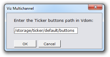

    You may enter the Viz Ticker buttons path in the Media Sequencer’s VDOM structure.
  4. Enter a file name and click Save.

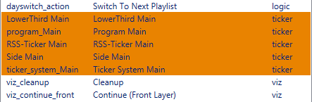

    The ticker actions are displayed in the left pane.

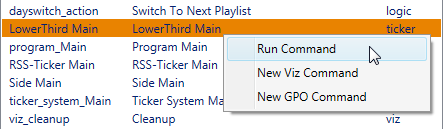

  1. Select your channel.
  2. Click the Actions button.
  3. Right-click the command you want to play and select Run Command.
