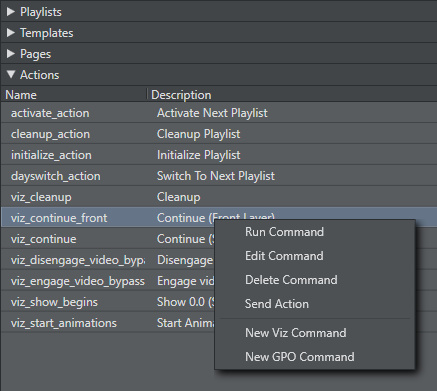

Viz Multichannel’s Actions pane allows you to define General Purpose Output (GPO) commands, Viz Ticker commands and Viz Engine commands. GPO commands are handled by Media Sequencer. Both Viz Ticker and Viz Engine commands can be used in Viz Multichannel to automate certain tasks. The commands behave as secondary events, in that you can also apply rules and schedule them in the playlist. Ticker actions are accessible from the Actions panel seen in the left pane. Ticker actions integrate tickers from Viz Ticker. Once the ticker has been created, it can be imported into Viz Multichannel.
Actions can for example include:
  • Playing specific data elements on air
  • Clearing specific render layer
  • Sending Stop, Continue, Take and other such commands to a specific render layer
  • Associated with playlists as secondary events
