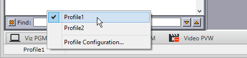

Profile Context Menu
Right-clicking the profile name will open the Profile Context Menu:
Profile(s): Shows the available profile name(s), and indicates the current profile.
Profile Configuration: Opens the Profile Configuration window.

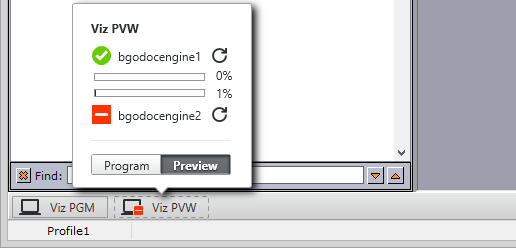

Channel Context Menu
Right-clicking Viz Channel will display a context menu for setting the channel as a program or preview channel. In addition, Viz Engines that are configured for that channel and their current status it will be displayed.
Clicking the refresh icon next to the Viz Engine name refreshes the status indicator and current memory usage bars.
Clicking the Channel indicator when it is disconnected (status: red) makes the system try to reconnect (see the Profile Configuration window).

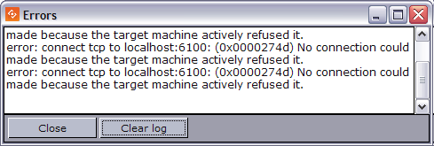

Errors: Turns red when an error occurs. Clicking the button opens the Errors Window. Errors that occur are saved in the Errors log, and displayed in the Errors window. |

Errors Window
Clear Log: Removes all the error messages from the log window, but not from the log file. The Errors window also closes, and the Errors button is hidden until there is new error log information to display.
