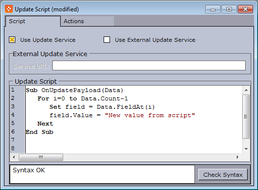

Script
The Script tab lets you select which of the Update Services you want to use. Either Viz Pilot system’s own Update Service or an external (third party) update service.

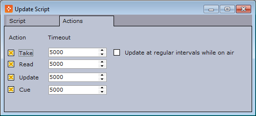

Actions
The Actions tab lets you select which actions are triggered during an update and set the timeout for each action.
Script actions are based on Read, Take, Cue and Update events that are triggered on Media Sequencer.
When the Take action is selected, the Update at regular intervals while on air option is enabled. If this is checked, Media Sequencer will periodically send updates to the update service. The interval is specified by the parameter live_update_interval, and the minimum value is 2 seconds.
Note: Update at regular intervals while on air is only available if Template Wizard is connected to a database with schema Viz Pilot 6.0 or later, and Media Sequencer 3.0 or later.

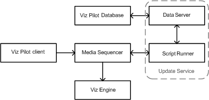

Update Services
Update services are mechanisms that let the template designer decide when to update data in the template, and which fields to update. This is useful for data that must be updated right before going on air. Typical examples are stock prices, player statistics etc.
In Template Wizard you have two options:
Viz Pilot’s Update Service (Script Runner): This mechanism lets you write a script to update the data that will be run by Script Runner during playout.

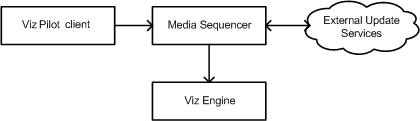

External Update Service: Alternatively, you can point the template (no script) to an external update service (for example third party), that can return updated data using the Viz Data Format (VDF). In order to implement an external update service, you need to parse and return a VDF document to the Media Sequencer. The document is posted to the external update service by the Media Sequencer.

Example
A sample script that updates all the incoming fields and set their values to “New value from script”:
Sub OnUpdatePayload(Data)
For i=
0
to Data.Count-
1
Set field = Data.FieldAt(i)
field.Value =
"New value from script"
Next
End Sub
