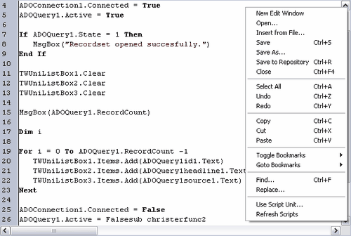

Context Menu
New edit window: Opens a tab with a new script editor.
Open: Opens a script file in a separate tab. See also Reopen used script units.
Insert from file...: Inserts script file, adding it as a script unit to the script that was open at the time of the operation.
Save (CTRL + S): Saves a script unit to the computer (not to repository).
Save As: Saves a script unit with a new name to the computer (not to repository).
Save to repository (CTRL + R): Saves edited script units to the database repository.
Note: When a template with script units is saved, a dialog appears asking for script units to be saved to the existing database. Use the Save to Repository menu option to save script units to the database without saving the template.
Close (CTRL + F4): Closes a script unit.
Note: The options Save, Save As, Save to Repository and Close are only available for Unit scripting windows and are therefore disabled for the Main scripting window.
Select All (CTRL + A): Selects all text in the script.
Undo (CTRL + Z): Undoes the latest change.
Redo (CTRL + Y): Redoes the latest undo action.
Copy (CTRL + C): Copies selected text in the script.
Cut (CTRL + X): Cuts selected text in the script.
Paste (CTRL + V): Pastes content from the clipboard.
Toggle Bookmarks: Adds and remove a bookmark in the script at the line where the cursor is by toggling bookmarks on and off.
Goto Bookmarks: Makes the cursor jump to a bookmark.
Find... (CTRL + F): Searches for a text string.
Replace: Searches for a text string and replace it by another string.
Use script unit..: Makes the main script use a script unit. A string of the form: ‘USEUNIT <myscript>, in the main script shows that a unit is used. The script units are saved back to the repository when a template is saved and the local copies are updated every time the program is started. Script units are often created to be generic and reusable.
Refresh Scripts: Loads updated script units from the database.

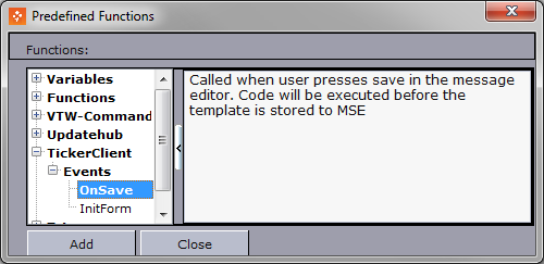

Predefined Functions: Shows the predefined functions and variables that are available, together with a brief description. Use the Add button to add the selected function to the script.

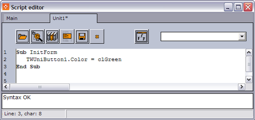

Syntax Check: This button checks the syntax of the scripts and reports errors. Errors are shown below the script pane.

Open the Script Editor.
Right-click the editor, and on the Context Menu select New Edit Window.
Write/Add the script to save to the repository.
Click the Save button (CTRL + R).
In the Save As dialog box enter the File name and click Save.

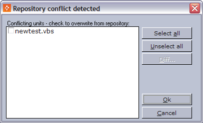

Resolving Conflicts Between Local and Repository Script Units
When new files are uploaded to the client, there might be cases where repository files are different from local files. To handle situations like these, a user can do one of two things:
Overwrite the local file with the repository file,
or -
Rename the local file and then overwrite.
It is also possible to use a file comparison tool (diff tool) to compare the file in the repository with your local file. When specifying which tool to use, add the entry diff_tool in the ContentPilot.ini file. The diff_tool entry must also be followed by the path to the tool itself.
Example: diff_tool=C:\ProgramFiles\Araxis\Araxis Merge 2001 v6.0 Professional\Merge.exe
