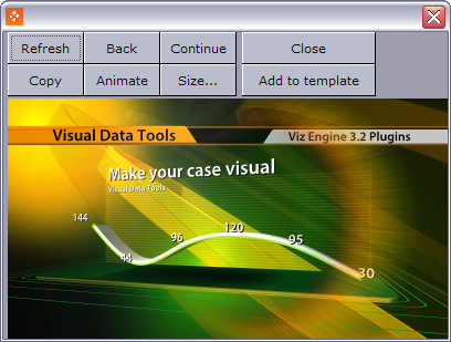

Properties and Parameters
Refresh: Refreshes the scene preview displaying a snapshot of the scene at its current animation position. This enables you to fetch new snapshots of the scene while it is being rendered on a remote Viz Engine without seeing the full animation in the preview window.
Back: Sets the animation back to the last stop point.
Continue: Continues the animation to the next stop point.
Copy: Copies the snapshot to the clipboard.
Animate: Animates the scene in the remote preview window. The animation is based on a series of snapshots of the scene rendered on the remote Viz Engine. Click Animate to start and stop the animation.
Size: Sets the size of the preview window. There are two default settings, one for PAL and one for NTSC, and one custom.
Close: Closes the preview window.
Add to template: Adds a snapshot of the previewed graphics to the template. The snapshot is appended to a Static Image Component component.
