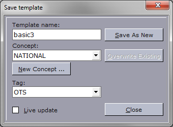

Save Template
Template Name: Sets the template name for the template.
Concept: Sets the concept name for the template.
New Concept...: Opens the New Concept dialog box for creating new concepts.
Tag: Allows the template to be tagged, by selecting from a user-defined list. (See Tags).
Live Update: Enables the template to use Live Update for last-minute updates before playout (for example weather or stock updates). This requires template scripting.
Note: Live Update has been superseded by Update Services. If you need to use Live Update, you must also use the Legacy Playlist.
Save As New (ALT + S): Saves the template and closes the dialog.
Overwrite Existing (ALT + O): Overwrites the existing template with the existing name or a new name.
Close: Closes the save dialog without saving the template.
Note: It's possible to save a template created in Template Wizard and run it as a graphical user interface, including scripts, either:
inside Viz Trio (called "Active TW template") or,
inside Ticker Client, instead of the default message editor (called "presentation file").

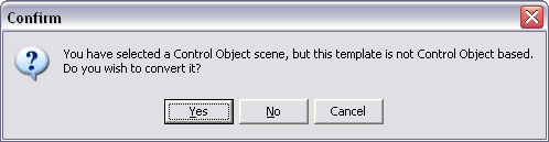

Converting a Template Using a Control Object-based Scene
Select the Change Scene option on the Edit menu.
Select a scene using the Wizard.
Confirm if the template should be converted to a control object based template.
Note: Changing a scene without changing the scene name in Template Manager under the Variants section will only change the scene used during design.

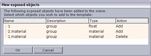

Refreshing Scene Information
When editing a template, it is possible to edit a scene in Viz Artist and make changes to the template’s scene. Any changes made to the scene can be updated directly by the template designer.
The template will be updated when the field identifier for a specific component has been changed through a new component being added to the template. However, the old component with the old field identifier will still be present. The Exposed Objects list is updated correctly, therefore, it is safe to delete any unused components.
Start Viz Artist.
Open the template’s scene, edit and save the changes.
Open Template Wizard, and click Main Menu > Tools > Refresh Scene Info.
Note: Clicking Refresh Scene Info updates the template with changes to control objects and background scenes. Since existing data elements refer to the background scene in the template, these will also change. The background scene will be updated for the template and all of its data elements every time this menu option is selected.
Click OK to add or delete exposed objects.
Optional: Remove any unused components that may have been made obsolete by the update.

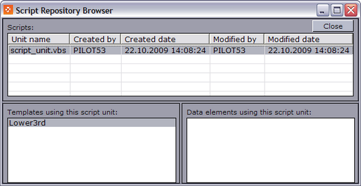

Script Repository Browser
This panel provides an overview of available scripts, the templates and data elements that are using the scripts. It is also possible to delete script units from the repository browser, but this affects the templates that use the scripts. A warning appears if the script is used by a template.
