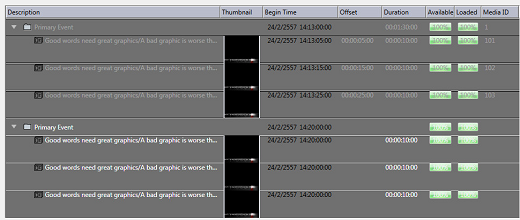

The playlist currently has six states for elements that reside inside the playlist. Each of these states uses a color on the playlist elements to provide a visual indication of their state:
  • Normal state: The state of an un-played element. Elements are shown in White text.
  • Played state: The state of an element that has been played out at least once. Elements in are shown in Gray text.
  • Cue state: The state of an element in a group has been called by MSE, to prepare for playing. These elements are shown in Yellow.
  • Pre-queue state: The state of a next element that will start playing within 5 seconds. Elements are shown in Orange.
  • Playing state: The state of an element that is currently playing. These elements are shown in Green. The cue state of a playlist that is activated by an external trigger has a yellow arrow in front of its element, otherwise the playing state has a green arrow in front. External triggering can be a VDCP-signal from the automation system, for example.
  • Error state: The state of an element where it has been set incorrectly and cannot be played. Elements in error are shown in Red and will also have a tool-tip indicating what caused the error, if the error condition provides this information, which most errors do.

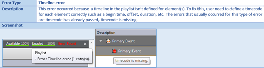

Playlist Errors in the playlist will most likely stop the playlist instantly or make the playlist work incorrectly. All indicated errors should therefore be treated as severe. The cause of the error must be investigated and corrective action must be taken to prevent the error from happening again. Errors can occur if the playlist was set incorrectly, if the elements residing in the playlist aren’t created correctly, or as a result of other circumstances. Errors are separated into six groups as shown in the list below. There is one additional error type if the MAM system Viz One is enabled:
  • Timeline error:

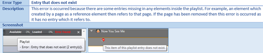

  • Entry does not exist:

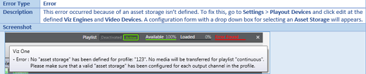

  • Available error for playout devices:

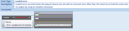

  • Loading error:

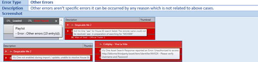

  • Other error types:
  • Viz One specific errors: A Viz One Error is an error related to an asset storage. There are specific details on the solution in the tooltip.
