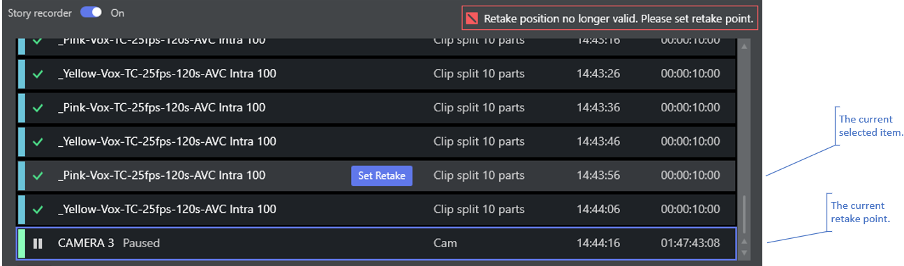

Paused | Recording is paused. A retake point can be selected and the recording can be delivered. |

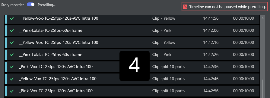

Waiting for recorder to pause. Please try again. | A retake was requested while the recorder was still stopping. Wait for the Paused state, then retry. |
The recording has not yet started. Please try again after the system has paused. | A retake was requested before recording began. Wait for the Paused state, then retry. |

The retake point is no longer valid: the take it pointed to was replaced by an earlier retake. Select another retake point. | The selected retake point was superseded by an earlier retake. Select another retake point. The recorded items and EDL entries are kept. |

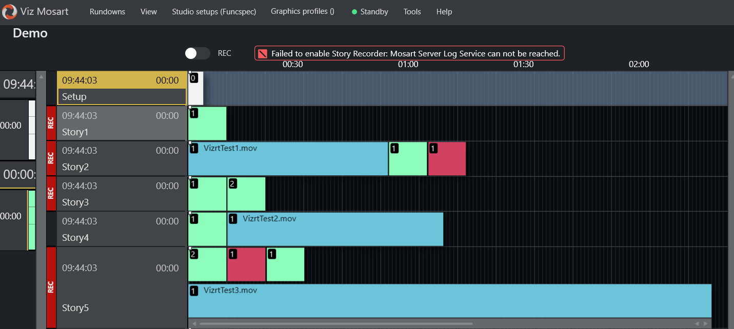

Story Recorder did not start: the Mosart Logging Service is not responding
Symptoms: the switch shows ON but the status stays SR Off, the item list stays empty for the whole show in the Story Recorder Panel, and a few seconds after enabling, the panel shows:
Story Recorder did not start: the Mosart Logging Service is not responding. Check that the service is running on the Mosart server, then switch Story Recorder on again.
A related message, Story Recorder did not start, although the Mosart Logging Service is responding, means the service answered but the Story Recorder adapter failed or was slow to start: switch Story Recorder on again before working through the list below. Note also that when logging is off there will be no Mosart logs to check.
Story Recorder builds its panel entirely from AsRunLog events. Anything that stops those events from being written stops Story Recorder, so work through the checks below in order.

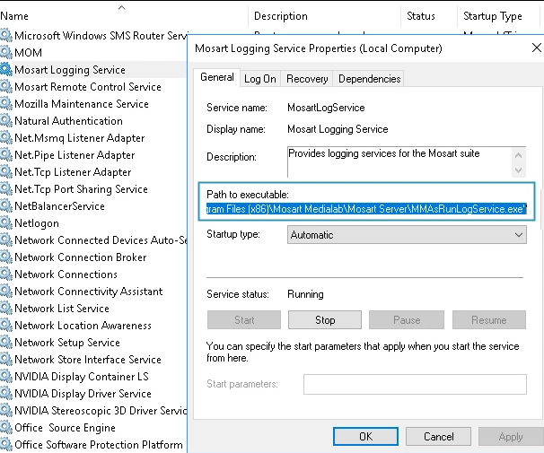

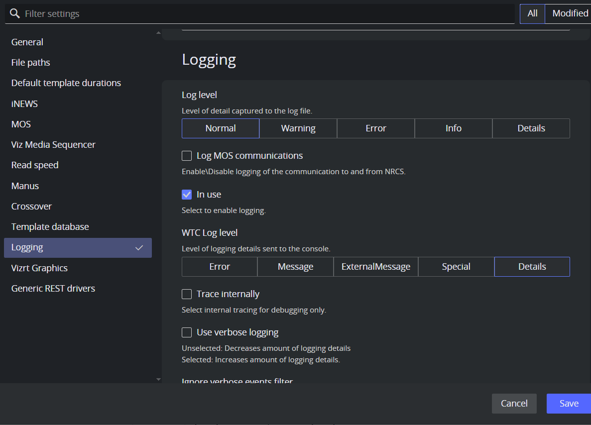

Verify in Viz Mosart Manus Administrator that logging is enabled: type settings, open the Logging section, and check that In use is selected.
The Logging Service is not running. Check the Windows service, or run it as a console application.
The Logging Service points at the wrong installation. This is the most common cause. When the Viz Mosart client, Audio Player, and Server are installed on one machine, the Server must be installed last, because the Logging Service has to point at the Server installation folder. If it points at the client or Audio Player folder instead, the Story Recorder adapter is not loaded. Run

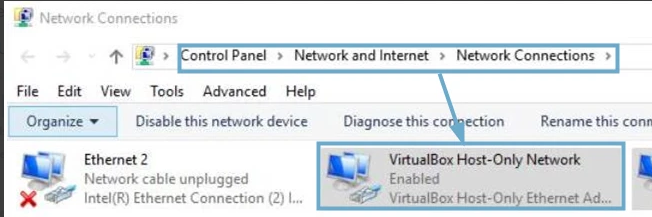

A virtual network adapter is interfering. If the client connects to a remote server, make sure no VirtualBox or comparable virtual adapter is installed on the server machine.

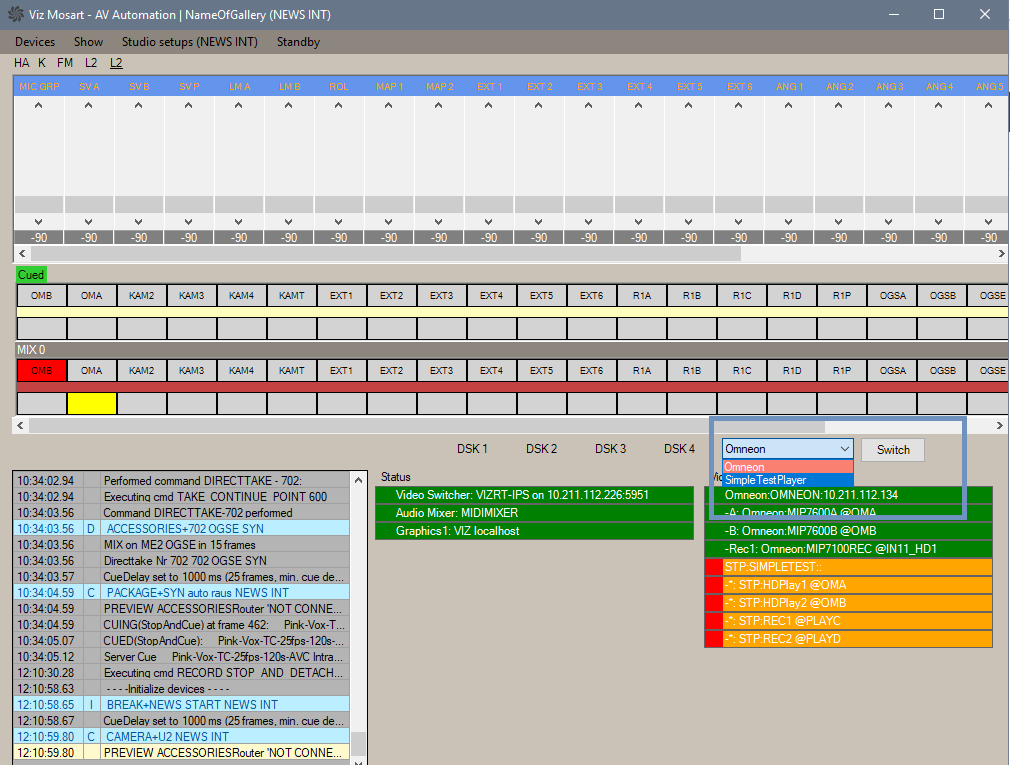

Recording ports not found
The message No recorders configured for Story Recorder means no usable record port was found.
Check the recorder port configuration in AV Automation, under Devices > Properties > Video Servers, and confirm that the port is enabled in the Story Recorder section.
Add a record port to the current salvo if none is present. Recordings are prepared on the record port of the current salvo, so if the message appears after a salvo change, check that the new salvo has a record port.
After changing the port configuration itself, force a reconnect with Ctrl+Shift+V, or restart AV Automation.

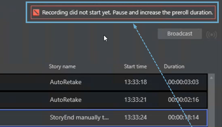

Recording not starting
If starting a recording produces
the pre-roll time is not long enough for the recording hardware to prepare itself.
At the top of the Story Recorder panel, increase Preroll (seconds) to the hardware start time plus one or two seconds, typically 10 to 15 seconds in total.
The pre-roll can never be shorter than the re-arm time of the video server.

Confirm that logging is enabled in Viz Mosart.

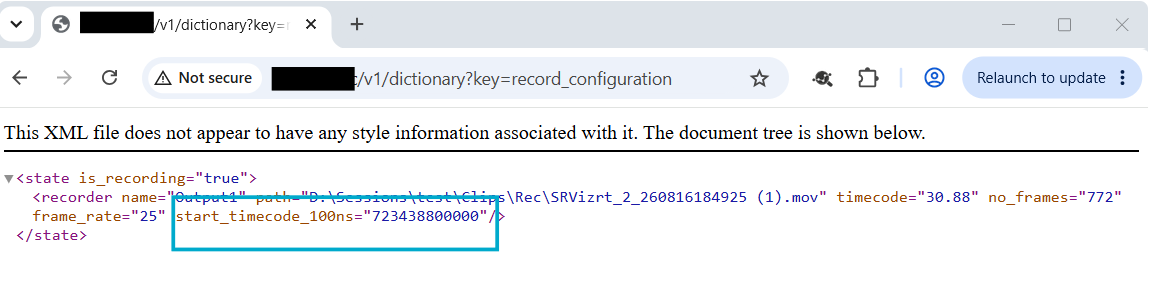

Around a second, or an exact number of hours
Too large for equipment latency, and calibration cannot correct it.
A whole number of hours is a time convention mismatch: the recording carries UTC while Viz Mosart works in local time, or the reverse. See Time sync issue between the video server and Viz Mosart, and on TriCaster, TriCaster start of media is UTC.
Around a second, with the timecode feed healthy, usually means Viz Mosart is reading the start of media from a different recording than the one it is cutting. See Viz Mosart is reading the wrong recorder output.
On TriCaster the start timecode of a recording comes from the NDI recorder, and it is UTC by default. Enabling LTC in TriCaster overrides that default. When Viz Mosart is configured for local time while the recording start timecode is UTC, every mark carries a whole-hour offset.
Fix. Enable LTC in TriCaster so the recording carries the house timecode rather than UTC, then set Use local time in Manus Settings to match the convention that timecode uses. External clock is local time in AV Automation describes the incoming timecode signal and is independent of this; it does not have to match Use local time.
TriCaster stops reporting start of media
Viz Mosart asks TriCaster for the start of media of a recording over the REST API, and computes every mark from it. TriCaster can stop answering that request while it otherwise keeps recording normally, and it never answers when it has no timecode source at all.
Symptom. The export job fails, or the story clip is cut at the wrong point in the recording. No start of media for the recording appears in the Mosart log. TriCaster itself looks healthy.
Fix. Restart TriCaster. That clears the case where TriCaster answered earlier in the session and then stopped. Start the recording in TriCaster, wait few seconds and then open this URL in a browser: http://tricaster-server/v1/dictionary?key=record_configuration. The attribute start_timecode_100ns should have a value:
If TriCaster still reports nothing after a restart, it has no timecode source. Open Timecode Configuration in TriCaster, select LTC, and set Source to Local (Silence). Configure this even when the system does not run in frame accurate mode. See Preparing TriCaster in Story Recorder Setup.

Invalid retake position
If you get the error notification Retake position no longer valid. Please set retake point this means that you restarted the show after a pause, but the selected story item is not the retake point (the story item with the Set Retake button):
To fix, do one of the following:
Select the current retake point, if this has changed by mistake, or
Make the selected story item the new retake point by clicking the row's Set Retake button.
If you choose (2), remember that all the recorded story items after the retake point, including the story item set as retake point, must be re-done once the show is restarted after pause (see Working with Story Recorder).

Error when pausing the story
If you get the error notification Timeline can not be paused while pre-rolling, this means you are trying to pause while the system is in pre-roll mode. The pre-roll process can not be interrupted.
If this action was done intentionally, let the pre-roll time out and auto-take the item to be retaken, and then pause again.
Retake requested too early
The messages Waiting for recorder to pause and The recording has not yet started both mean the session is not yet in a state where a retake can be set. Wait until the panel shows Paused, then try again.

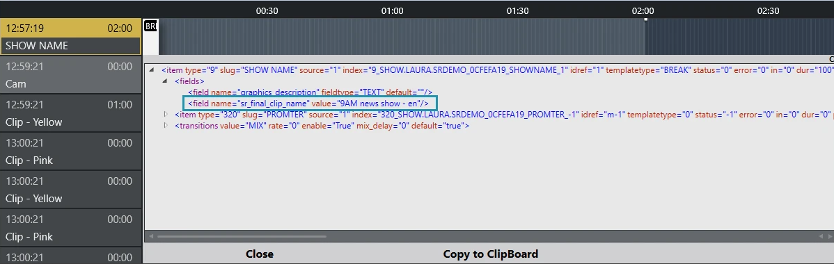

If a final clip name supplied by the NRCS does not appear in the Story Recorder panel:
The name is read from the first story in the NRCS rundown. Check the status of the first story. If it has been set to float and is not displayed in Viz Mosart, add the name to whichever story is now first.
Check whether another story has been set as next, which changes which story is treated as first.
A name changed in the NRCS during a session takes effect only at the next session. Disable Story Recorder mode and enable it again.
To inspect what the NRCS actually sent, hold Ctrl+Shift+Alt and double click the first story item to view the MOS XML.

Timing problems cannot be diagnosed from a description alone. Collect the following before contacting Vizrt Support.
Files
Item | Where | Why it is needed |
Viz Mosart technical logs |
| Crosspoint events, start of media, cue and play commands, with timecodes. |
EDL files | The configured EDL folder, by default | The mark in, mark out, and start of media values actually produced. |
Genlock logs |
| Genlock behavior for the session. |
Clock source statistics | The configured statistics folder, by default under | Whether the external clock and the frame clock were reliable. See the Frame Accurate System Operations section for how to gather these. |
The source recording | Video server clip storage | Lets Support compare the marks against the actual media. |
The rendered clip | Mimir, TriCaster, or the export location | Shows what the viewer would have seen. |
Configuration files |
| Frame rate, video server type, genlock and calibration values, transition types. |
