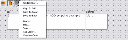

Template Editor Context Menu
The context menu in the Template Editor contains the following functions:
Edit Image...: Adds a Static Image Component to be used as a template background, for example. Only available when using Static Image Component.
IMPORTANT! When using the static image component, use compressed image types such as JPG or lossless ones such as PNG to conserve space. The image does not need to be small in terms of pixel size. The whole template is streamed to the database as a BLOB, and the image data will not be altered. Using JPG or PNG will therefore use much less space than BMP, which is not compressed.
Fields Editor: Adds string components to represent database fields using an active database connection. Only available when using specific Database Components.
Align to Grid: Aligns the template’s selected component to the template grid.
Bring to Front: Brings the template’s selected component to the front of all stacked components.
Send to Back: Brings the template’s selected component to the back of all stacked components.
Align: Lets the user set the Alignment of the template’s components.
Size: Lets the user set the size of the template’s components (see Size and Scale).
Scale: Lets the user set the scale of the template’s components (see Size and Scale).
Tab Order: Lets the user set the Tab Order for the template’s components.
Creation Order: Lets the user set the Creation Order for the template’s components.

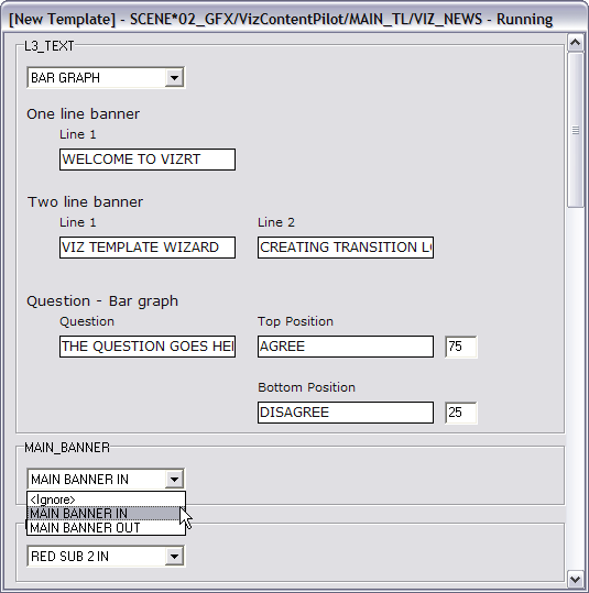

A transition logic scene consists of a background scene and a set of front scenes. When used to create a template in Template Wizard, the front scenes are created as GEOMs (objectified). The objects are added to the background scene in their respective placeholders called layers. Once the template is used to play out the scenes, the front scenes themselves are therefore not used, rather their objects in the background scene are used.
When generating a transition logic template the logical layers, visible in the Layer Panel, are placed on the template in separate group boxes. Each group box also has a drop-down menu with all the GEOMs (the front scenes) for that layer. The currently selected front scene is displayed in the ActiveLayerID property for the TVTWLayerControl component.
Note: Although the ItemIndex property is similar to ActiveLayerID, using the ActiveLayerID is recommended as it preserves links to items regardless of changes to the index order or description names in the scene’s control object.
A background scene can contain many logical layers. A layer is a placeholder for front scene objects (graphical elements) that are intended to be on air one at a time. In order to have independent elements that can be on-air simultaneously, new logical layers must be added to the background scene.
Each layer can have several states, including everything from position on screen to layout variants or off screen. Certain controls in templates will be visible depending on which layers are currently selected.
Using this method, several independent graphical elements can be on air at the same time and can be taken in and out independently of each other. Transitions can be built into the background in order to obtain a smooth transition between the different states.

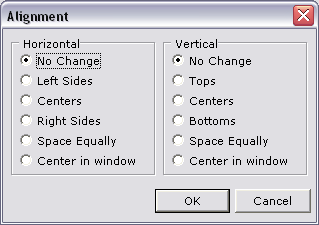

Aligning
Components can be positioned manually by drag and drop, or by selecting multiple components and using the built-in alignment functions. It's also possible to snap components to the template grid.
Positioning Components
Select the components to align.
Right-click on the template and select Align.
Set the horizontal and vertical alignments and click OK.

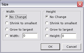

Size and Scale
Setting the size and scale of components can be done per component or by selecting a group of components, and can be used to make text boxes and other components of the same type with the same size and/or scale.
Size: Width/Height: Sets the width or height of selected components.
No Change: No changes are applied to the width or height of the selected components.
Shrink to smallest: Shrinks the size of all components to the same as the smallest.
Grow to largest: Grows all components to the same size as the largest component.
Width/Height: Sets a custom width/height for the selected components.
Scale: Scaling Factor: Sets the scaling factor in percentage.
Setting Component Size
Select the components to size by pressing SHIFT and clicking the components.
Right-click the template, and on the context menu select Size.
Set the Width and Height properties and click OK.
Setting Component Scale
Select the component to scale by pressing SHIFT and clicking the components.
Right-click the template, and on the context menu select Scale.
Set the Scaling Factor (percentage) and click OK.

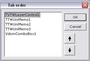

Tab Order
Press the TAB key to move between the different fields (components) on the template.
Setting the Tab Order
Right-click on the template and on the context menu select Tab Order... .
Arrange the order by selecting items and using the arrow buttons, or drag and drop, to move them up and down.
When done click OK.

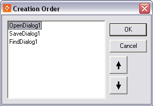

Creation Order
Use the Creation Order dialog to specify the order in which the template creates non-visual components. The order is used when the form is loaded at design time or run time. A non-visual component is a component that is visible when designing, but has no appearance at runtime until it is called (for example SaveDialog), or simply never appears at runtime (for example TWComPort).
The List box only displays non-visual components on the active template, their type, and their current creation order. The default creation order is determined by the order in which the non-visual components are placed on the template.
