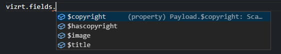

When using the scripting tool in the template, individual fields must be accessed through the global name space vizrt.fields (for example, vizrt.fields.$singleline.value).
Note: Writing $singleline.value instead of vizrt.fields.$singleline.value does not work and results in a compile error.
The script executes when a graphic element is opened or created with the scripted template in Viz Pilot Edge.
In Template Builder, the script is also re-loaded and restarted when there are changes made to it.
By typing vizrt.fields, the editor's autocomplete shows you the available fields to choose from.
You can read and write field values, react to value changes from outside the script, and access the properties error, hidden, readOnly and tip of the vizrt fields.

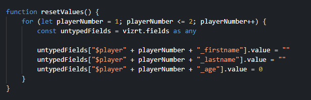

Typescript lets you access fields using known names (for example, vizrt.fields["$field_2"]), but does not allow expressing the field names using variables (for example, vizrt.fields["$field_" + num]), as it is unable to determine whether the field name is valid and what type the field is.
This must be used, for instance, when addressing the layers in a Transition Logic combo template, such as: vizrt.fields["$-vizlayer-TL_FS"].
To overcome this, the type checking associated with vizrt.fields can be locally ignored by using the any type. You may do so inline using for example (vizrt.fields as any)["$field_" + num], or storing it as a new variable, as shown in the example below.
Note: When using an object cast to any, the script editor cannot help you catch errors such as setting a boolean value to a string field, or trying to access a field that does not exist.

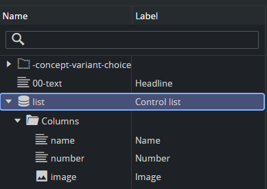

List Fields
In TemplateBuilder, a list field represents a repeating set of rows, similar to a table. Even though Viz Artist uses the term ControlList, the underlying VDF field type is simply a list, and each row contains a fixed set of child fields (effectively table columns).
A list field is accessed as follows:
const list = vizrt.fields.$list.value;
list now contains an array of rows, and each row exposes its columns as simple child fields:
list[rowIndex].$name.value = "Example";
list[rowIndex].$number.value = "123";
list[rowIndex].$image.value = createImageAsset("http://example/image.jpg");

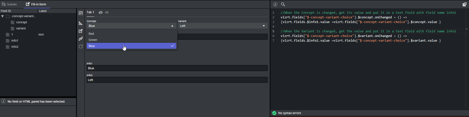

Accessing Concepts & Variants
To access information from concept and variants fields, because they contain dashes, you must use square brackets, as shown in the example below.
//When the Concept is changed, get its value and put it in a text field with field name info1
vizrt.fields["$-concept-variant-choice"].$concept.onChanged = () =>
{vizrt.fields.$info1.value = vizrt.fields["$-concept-variant-choice"].$concept.value }
//When the Variant is changed, get the value and put it in a text field with field name info2
vizrt.fields["$-concept-variant-choice"].$variant.onChanged = () =>
{vizrt.fields.$info2.value = vizrt.fields["$-concept-variant-choice"].$variant.value }
