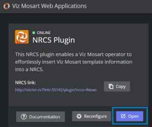

After entering NRCS type above, clicking Next starts a background Windows service, Mosart REST API (a combination of the REST API and the NRCS Plugin).
You can check that the NRCS Plugin is accessible by either:
In the Configuration Tool, clicking Open.
or -
following the URL next to the Copy button.
The Plugin URL comprises the machine name, port number 55142, NRCS type and (when supported) mos id in the form: http://machine-name:55142/plugin?nrcs={type}&mosid={mosid}

At any time you can start the Mosart Web Applications Configuration Tool and check operating status.
A common error is when a Windows service has failed.
Try restarting the service with the Restart button.
You can also rewrite any previously entered values with the Reconfigure button.

From the Configuration Tool, copy the NRCS link (click Copy).
The URL has the form similar to: http://<your-hostname>:55142/plugin/?nrcs=ENPS&mosid=mosart -
Open you web browser and paste the URL in to see the NRCS Plugin.
