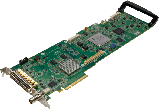

Matrox X.mio2 and X.mio2 Plus
images/download/attachments/50616325/vcr_xmio2p_525.png
X.mio2 and X.mio2 Plus Cables and Connectors
The connectors for X.mio2 and X.mio2 Plus are:
  • PCIe board compliant to PCIe 2.0 in x8 or x16 slot
  • x2 or x4 SDI video inputs in SD and HD
  • x4 SDI video outputs in SD and HD
  • x16 In / x32 Out, unbalanced AES/EBU audio
Because of the large number of I/O connections, the X.mio2 and X.mio2 Plus boards are equipped with Sub-D connectors. A breakout-cable or rack mountable Break Out Box (BOB), which translates the Sub-D connectors to regular connectors/plugs, is included for every machine.

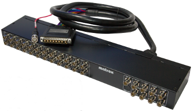

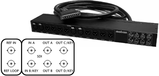

Breakout Cables and Connectors
A Breakout Box (BOB) is often used for Viz Engine solutions that need to be rewired in regular intervals. The 1U Rack unit chassis is designed to fit into a standard 19” rack.

Video Cables for X.mio Series
This image shows the cables responsible for transmitting any video related signals to and from the X.mio2 Plus board.

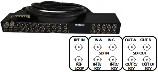

Video Connectors for X.mio2 Plus
The front panel of the X.mio2 Plus breakout box provides the user with eight or nine standard BNC connectors.
images/download/attachments/50616325/vcr_bob_xmio2p.png
  • x2 or x4 HD/SD SDI In
  • x4 HD/SD SDI Out
  • x1 Analogue Ref In

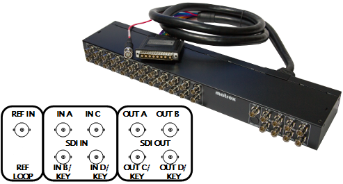

The front panel of the X.mio2/2 Plus breakout box provides the user with eight or ten standard BNC connectors.
images/download/attachments/50616325/vcr_bb_xmio2.png
  • x4 HD/SD SDI Out
  • x1 Analogue REF IN
  • x1 Analogue REF LOOP
    IMPORTANT! When using the REF IN connector on the Matrox X.mio2 board for synchronization, the REF LOOP connector must be terminated with a 75 Ohm resistor unless it is being used to loop an incoming Genlock signal.

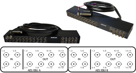

Audio Connectors for X.mio2 and 2 Plus
On the X.mio2/2 Plus breakout box, each of the two audio bays, A and B, consists of four female BNC audio input channels and of eight female BNC audio output channels.
images/download/attachments/50616325/vcr_xmio2_bob_audio2.png
Note: Bay cables are not included.
On the backside of each breakout box there are two connectors labeled AUDIO-A and AUDIO-B. The included cables are used to connect the corresponding plugs of the X.mio series to the computer.

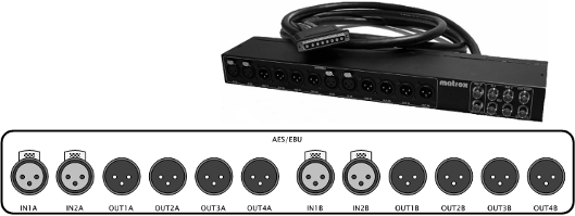

The front side of the X.mio breakout box hosts various audio in- and outputs. Each of the two audio bays, A and B, consists of two female AES/EBU audio input channels and of four male AES/EBU audio output channels.
images/download/attachments/50616325/vcr_xmio1_bob_audio2.png

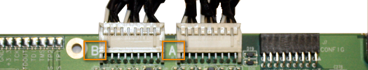

  1. Locate the connectors on the audio-extension card labeled A and B.
    images/download/attachments/50616325/vcr_videoaudiox_connect.png
  2. Locate the connectors on the video board labeled A and B.
  3. Use the cables to connect A on the audio-extension card to A on the video board, and do the same for the B connectors.

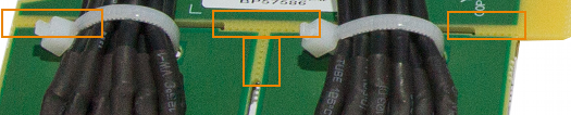

To Remove the Audio-extension Card Back-end
  1. Locate the audio-extension card’s weak spots
    images/download/attachments/50616325/vcr_audiox_cws.png
  2. Carefully break the connections.
    Caution: Do not break the weak spots that hold the two remaining pieces together.
