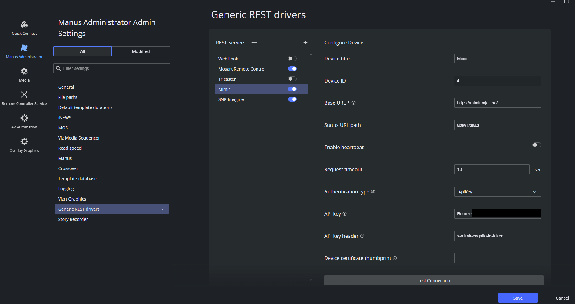

  • A Generic REST device configured in Viz Mosart. This device handles the API communication with Mimir. See more details below.

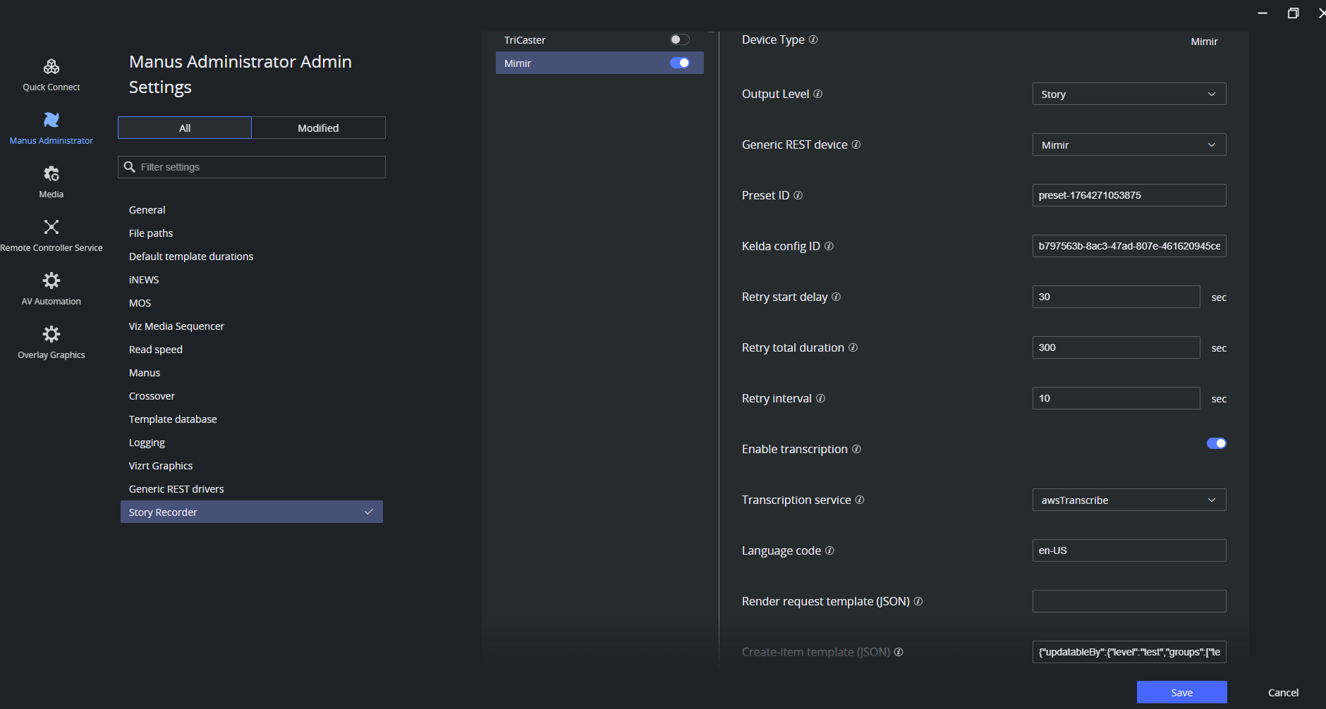

Clip Outputs > Mimir
Setting
Default
Description
Output Level
Story
Read-only. Determines the granularity at which clips are produced. Currently, only story-level clips are supported with Mimir. At story-level, one clip is generated per rundown story.
Generic REST device
(empty)
The Generic REST device configured for Mimir. This device handles the API communication with Mimir.
Preset ID
(empty)
Identifier of the render job preset configured in Mimir System Settings. Determines the render profile used when producing the story clip.
Kelda config ID
(empty)
The Kelda configuration ID, set up in Mimir System Settings. Kelda is Mimir's ingest orchestration component, this ID informs Mimir which ingest configuration to use when receiving the recorded media from the video server.
Retry start delay
30 sec
Delay before Story Recorder starts checking ingest status and retrying, after the publish command is sent to Mimir. Allows time for the initial render/ingest to start.
Retry total duration
300 sec
Total time to spend on ingest checking and render retries before giving up. If all retries are exhausted, the publish is reported as failed.
Retry interval
10 sec
Time between consecutive ingest checks and render retries.

  1. In the Manus Settings menu, configure Mimir as a Generic REST device.

  3. Under Clip Outputs, open the Mimir section.
  4. Select the Generic REST device configured for Mimir.
  5. Enter the Preset ID of the render job preset from Mimir System Settings.
  6. Enter the Kelda config ID from Mimir System Settings.
  7. Leave Retry start delay (30 sec), Retry total duration (300 sec), and Retry interval (10 sec) at their defaults unless your Mimir tenant needs longer.
  8. Set Enable transcription, Transcription service, and Language code. Confirm that the language code and service pair matches a transcription configuration in the Mimir tenant settings.
  9. Add JSON to Render request template (JSON), Create-item template (JSON), or Create-version template (JSON) only if you need to override the defaults.
  10. Save the settings and restart the Mosart Logging Service on the Mosart Server machine.

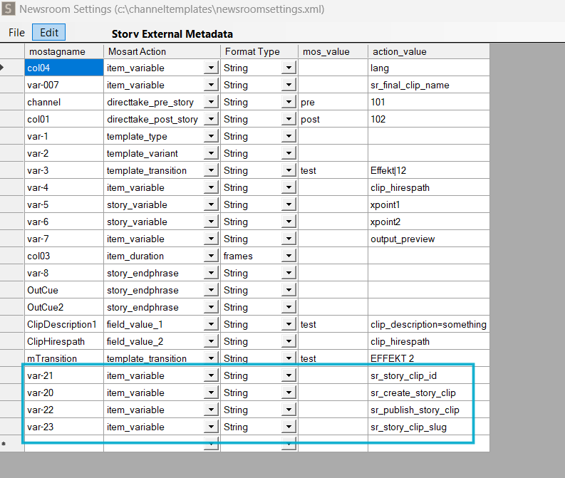

Configure the NRCS story metadata
Each story that should be recorded must carry metadata that tells Viz Mosart to produce a clip. This configuration is shared by all story clip outputs, and is documented in NRCS Metadata for Story Clip Production in Story Clip Production Setup. Two paths deliver the same result: an NRCS with built-in integration (for example, Saga) sends a storyPublisher metadata block, while any other NRCS (for example, iNEWS) delivers the same fields through Newsroom Settings field mapping. The Newsroom Settings mapping for iNEWS looks like this:

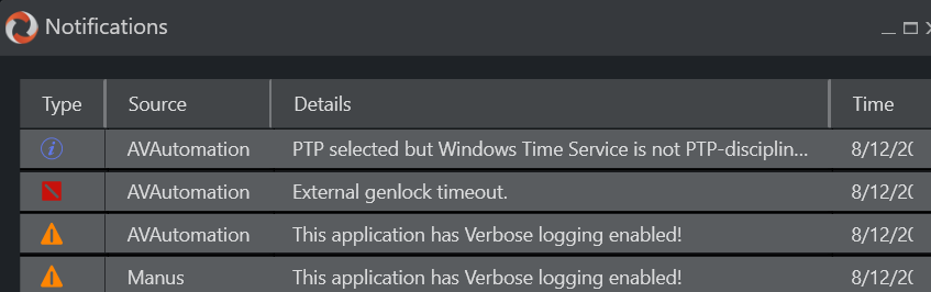

  2. Check that the Notifications in Mosart UI shows no genlock warning. Unreliable genlock or Genlock is not enabled means Viz Mosart fell back to the internal clock, and the clips will not be frame accurate. You can still verify Story Recorder general functionality without genlock and timecode setup though.
