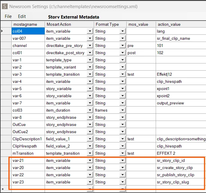

NRCS via Newsroom Settings mapping (iNEWS, other systems)
For an NRCS that does not use the storyPublisher schema, the same metadata can be delivered via MOS item variables. The fields are then mapped to Mosart through the Newsroom Settings (newsroomsettings.xml) Story External Metadata configuration:
Mosart field name | Mosart action | Purpose |
| Marks the story for clip production ( |
| Clip identifier (anchor clip ID or unique GUID) |
| Human-readable clip description |
| Marks for online publishing ( |
The NRCS column names are mapped to the corresponding sr_ action values. Both paths, the storyPublisher MOS schema and the Newsroom Settings mapping, produce identical results in Mosart. The following example shows how iNews columns (var-20, var-21, and so on) are mapped to Mosart item_variable actions with the corresponding sr_ action values:
