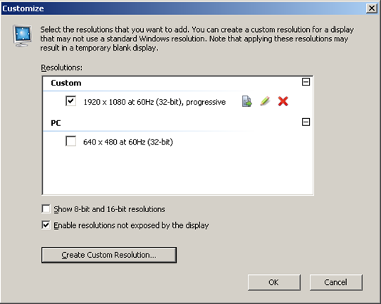

  3. In the upcoming dialog, tick the Enable resolutions not exposed by the display check box, and click Create Custom Resolution....
    images/download/attachments/27018708/videowall_nvidia_create_custom_resolution_enable_unexposed.png

  7. The newly created resolution will now show up as illustrated below and will have been applied to all displays.
    IMPORTANT! Please note that for 59.94 Hz setups, the server refresh rate might report to be 60 Hz when the external house sync is 59.94 Hz. Even though the custom resolution states to be 60 Hz, the correct value under the hood is 59.94 Hz.
    images/download/attachments/27018708/videowall_nvidia_create_custom_resolution_in_list.png
