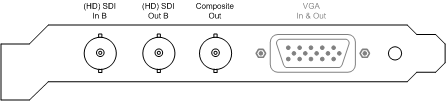

SDI and RS-422 Extension Card Connectors
images/download/attachments/27018958/videocardreference_dvs_centaurus_ii_sdi_rs422_connector_diagram.png
The SDI and RS-422 panel is included in the standard configuration of DVS Centaurus II. It provides the connectors for the second link of the dual-link connections. Additionally a CVBS output is installed on this panel that provides a composite video signal showing the fill signal generated by Viz Engine.
The RS-422 connector available on the panel is a DB-15 (HD) connector.
Note: This connector does not provide any additional functionality in regards to Viz Engine and should be ignored. The RS-422 port is not accessible to the operating system and can therefore not be used to transceive any kind of data by third-party applications.
  • (HD) SDI In B: BNC connector for a video input at port B (serial digital interface); usually used for an input of the second video channel in single-link (YUV) or the second stream of YUVA or RGBA in dual-link mode.
  • (HD) SDI Out B: BNC connector for a video output at port B (serial digital interface); usually used for an output of the second video channel in single-link (YUV) or the second stream of YUVA or RGBA in dual-link mode.
  • CVBS Out: BNC connector for a composite video burst signal, either analogue output of SD video or used for synchronization purposes. Provides the fill output of Viz engine as an analogue signal.
  • RS-422 In & Out: DB-15 (HD) connector (female), serial RS-422 interface for master/slave control, a breakout cable to two DB-9 connectors is included in the delivery.
    Note: This RS-422 connector is inactive and not accessible to the OS and can therefore not be used to transceive data.

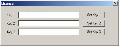

To Install a DVS Centaurus II License
images/download/attachments/27018958/videocardreference_dvs_centaurus_ii_license_installation.png
  1. Locate and double-click the dvsconfig.exe file located in the driver folder downloaded from Vizrt’s FTP.
  2. Select the Card 0 tab.
    • When selecting the Card 0 tab for the first time the system will inform that a license needs to be installed for the product.
  3. Click OK to close the DVSConf Warning dialog box.
    images/download/attachments/27018958/videocardreference_dvs_centaurus_ii_license_installation_key.png
  4. Click the Setup button and select Set License from the appearing drop-down menu.
  5. Enter the license key in field Key 1 and click the Set Key 1 button.
    Note: It has been reported that the key might be ignored and that validation fails although it was correctly entered. Re-enter the license string and try again.
