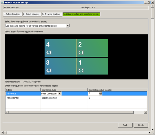

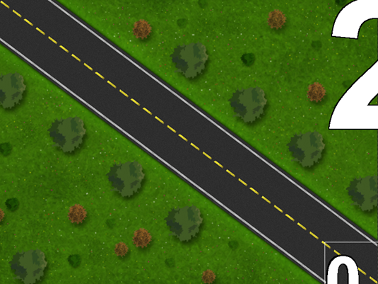

  4. Configure Bezel/Overlap for Mosaic in NVIDIA control panel:
    images/download/attachments/27018708/videowall_nvidia_mosaic_4_overlap_bezel_correction.png
    images/download/attachments/27018708/videowall_nvidia_mosaic__overlap_bezel_correction_osd.png
