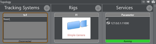

Configure a Tracking System
Configure a Rig
Configure a Service

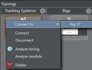

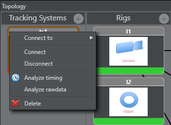

Right-click on the Tracking Systems box and select Connect (connect to the tracking system).
The Tracking Hub now connects to the selected Tracking System. Observe the colors on the bottom of the symbol:
Green: Connection is done and data receiving in time
Orange: If the color becomes orange, after a few seconds, connection is done and data receiving, but not in time
Red: If the color becomes red, possible connection failure or data is not received.

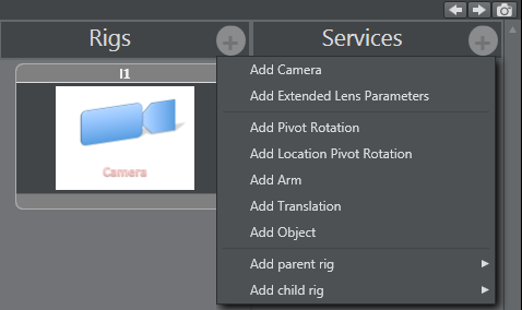

Click
Select from the list:
Add simple camera:

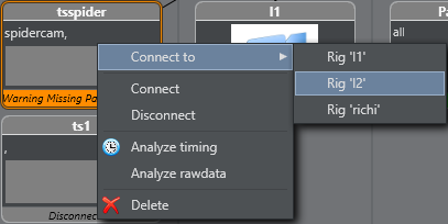

Right-click the Tracking System and select Connect to -> Rig (Lattice).
Set or change tracking parameters as required. When finished Click OK.

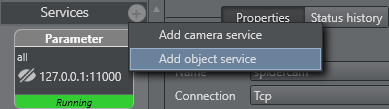

Configure a Service
Click
Select a Service (see Services):
Add camera service
Add object service
Click on the service icon in the Services panel.
Configure the service in the Properties panel.
Rig: Type the name of the rig whose data should send to an engine
IP: IP address of the Viz Engine, which is to receive the tracking data
Port: Port number for this connection, (same port as configured in the Viz Engine configuration)
Cam.Number: Same as Viz Engine is expecting
Mode: Not in use (default = 0)
Active: When checked the service is active, unchecked no data is send to the Viz Engine

Right-click on the Tracking System that is to be analyzed and select Analyze Timing.
This adds a new element to the Services panel, called TrackingTiming.

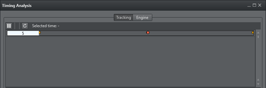

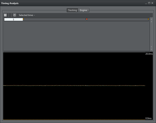

To View Timing Information
In the Configuration Panel, click the View Timing Analysis button
In a Timing panel with a correct data stream:
Purple line: Shows the time when the Tracking Hub has inserted a data package from the tracking system into the data pool
Green line: Shows the time when the communication part of the Tracking Hub starts to read from the data pool
Red Dot: Indicates data sent to a Viz Engine has stopped
Upper Section
In the upper section, the first line is the timing of live tracking data.
These timestamps are shown:
Sync:
Start RX: Start time, when data is received from the tracking system
End RX: End time, when data stops from the tracking system
Start Ins: Start time, when Tracking Hub inserts received data into the parameter pool
End Ins: End time, when Tracking Hub has finalized inserting data
Orange Dot: Sync Timestamp
Blue: The time between Start RX and End RX
Note: The time between Start RX and End RX can be very short and thus almost invisible if a network communication is in use.
Purple Line: The time between Start Ins and End Ins
Line 2: Shows when the live tracking data is processed and sent to the Viz Engine.
Start Calc: The start time. When tracking data is calculated and prepared for a Viz Engine, this time is defined from send delay. After this delay has passed the Tracking Hub starts with this procedure for calculation and sending data
End Calc: The end time. When tracking data preparation is finished
End Send: Time when data has been send to the Viz Engine
Green Line: Time between Start Calc and End Calc
Red Dot: End Send Timestamp

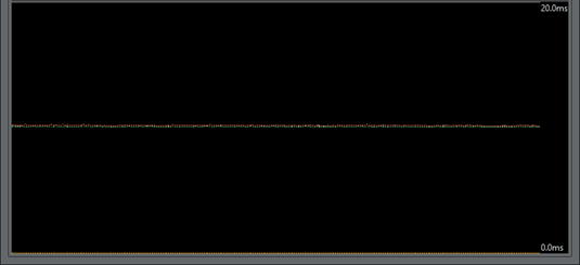

Lower Section
The lower part shows the last ten second history of the timing. Three timestamps are shown.
Note: Only three timestamps are shown to make the recognition of the timing behavior easier.
End Ins: As time, when receiving is finished (purple (1))
Start Calc: When data processing starts (green (2))
End Send: When Tracking Hub work is finished for this field (red (3))
To get the optimal timing, the Start Calc time must be later than the End Ins time, for every field. To achieve this, the send delay has to be adjusted correctly.
The white line shows the delay. This line should be the absolute border between End Ins (purple line) and Start Calc (green line). To change the delay, use drag and drop to move the white line.
If the delay can not be adjusted correctly, this can be for several reasons, for example, tracking data is received too late.
Note: This is not too bad, but keep in mind, that this result is in a tracking delay of one field.
This doesn't matter so much, because in normal production you need more the one field tracking delay.

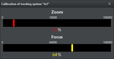

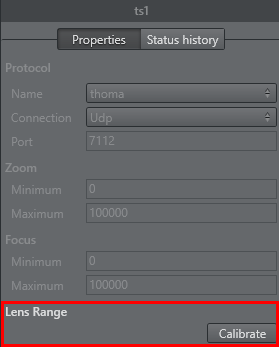

First, collect the Minimum and Maximum Values of Zoom and Focus:
In the Tracking System properties panel, click the Calibration button:
Go to the broadcast camera and move Zoom and Focus to their upper and back to their lower limits, at least two times. Observe that the system receives the full set of data:

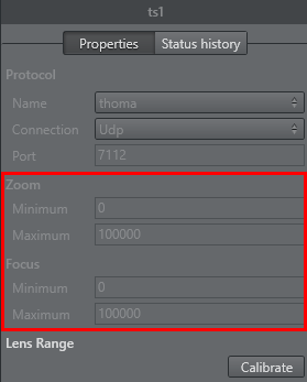

To check if the calculation is correct, the corresponding Min/Max values, of the Lens encoder, are shown in the Zoom and Focus fields.
Re-using Lens Ranges from Older Version Lens Files
The lens range in Tracking Hub is from 0 to 1. For setups used with software preceding the Tracking Hub, such as Viz IO, the lens files may have used lens ranges specified slightly differently, such as from 0.01 to 0.99. The Tracking Hub is capable of adapting to such a lens range. To achieve this, the lenserange parameter in the studio configuration file needs to be entered manually.

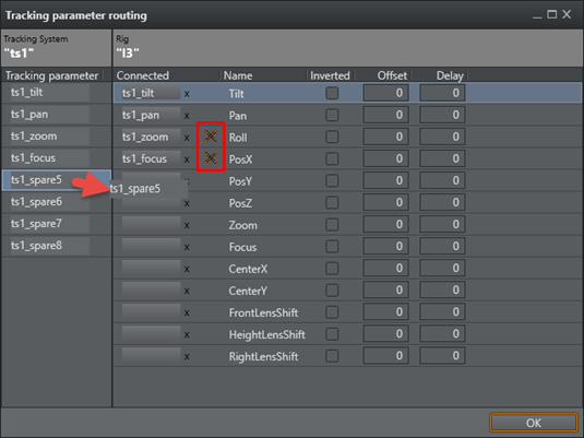

Modify a Rig
If a Tracking System parameter does not equal a Viz Engine parameter, a Viz Engine parameter can be modified to adapt to the Tracking System parameter.
To Modify a Rig

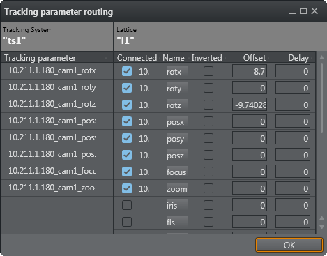

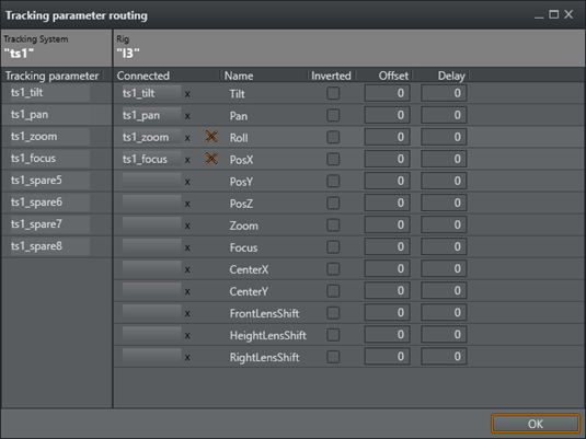

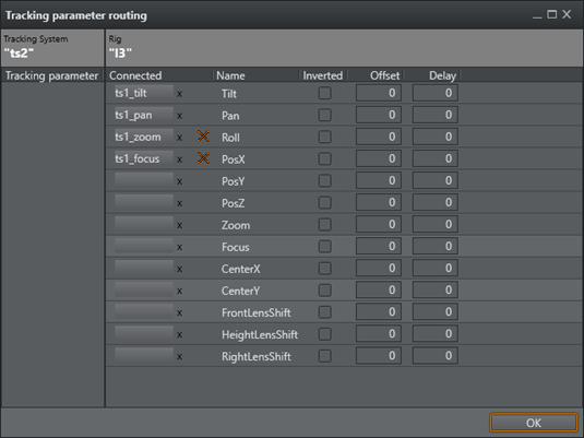

Right-click on a Tracking System. Select Connect to a rig.
The Tracking parameter routing window opens.
The Tracking System panel shows all the parameters that can be tracked
The Rig panel shows the Rig connections

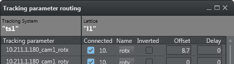

If a Tracking System parameter does not equal a Viz Engine parameter, a Viz Engine parameter can be modified to adapt to the Tracking System parameter. Click on a Viz Engine parameter and drag to its new position, as required. If a red cross shows, after a parameter has been modified, it means that the connection is still valid, but the connection is now a cross-over connection and not a straight one.
In the Offset column, define an offset to each parameter. The values are given in cm or degree ( value with dot). The values are stored when the field loses focus.
In the Delay column, enter how many fields sending of the parameter should be delayed.
Click on a box under Connected to connect a parameter through the Rig.
Click OK.
