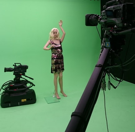

The background (typically green) is masked away in real-time with a virtual software-created background. The physical objects in front (persons, desks, etc.) is merged with the virtual background creating the illusion of physical presence.

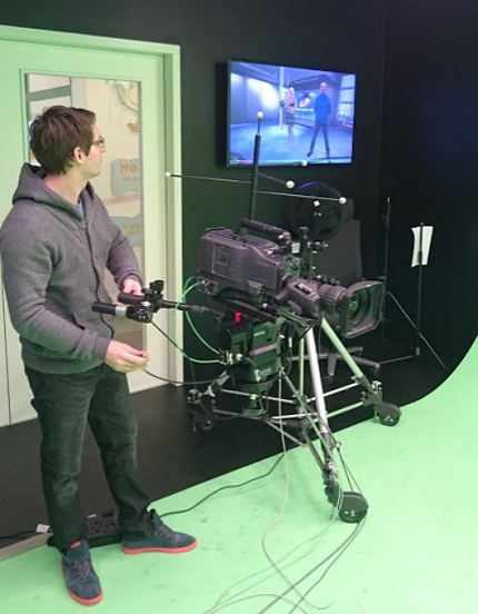

An important part of the virtual studio is the camera tracking that uses either optical or mechanical measurements to create a live stream of data describing the perspective of the camera. Exact camera and sensor tracking with as little delay as possible is the key difficulty to solve in a virtual studio.
Software Components
Tracking Hub: a service process (runs as a console program without a GUI) responsible for receiving and forwarding measurements from cameras, trackers and other sensors. Must be kept running at all times.
Studio Manager: a GUI for setting up, defining and controlling a Tracking Hub and the Virtual Studio environment.
