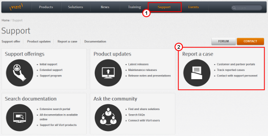

Go to Vizrt.com.
Click on Support (1).
Click on Report a case (2).

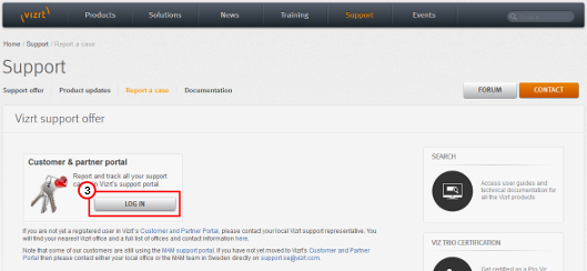

Click on LOG IN (3).
Log in to the Customer and Partner portal.

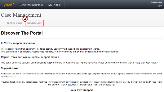

Click on Report a Case (4).
In the online form complete the required minimum information (shown by a red asterisk):
Contact: Your name
Account: Your account
Product: The product the support request refers to.
Case Type: The type of support request required
Click SAVE.
