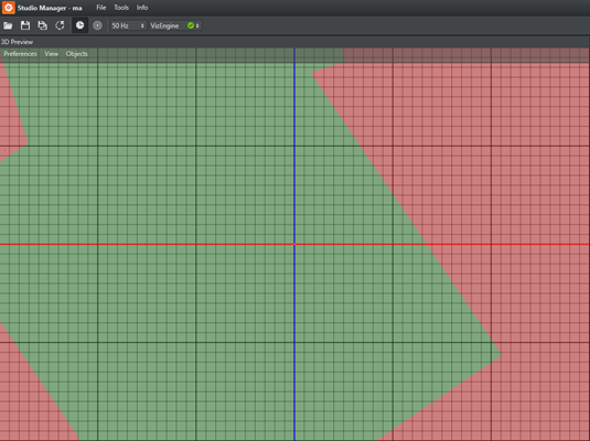

The 3D Preview panel gives a preview of the tracked cameras which should be as close to the real studio as possible. When the Studio Manager starts up, a Parameter Service is established, which sends the positions of all tracked rigs to the preview panel:
The preview panel consists of the following parts:
The main menu
The navigation bar
The HUD display

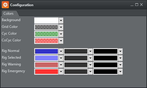

Configuration
In this window, the user can adjust the render colors for the visible objects in the preview panel. Click in a drop-down list to open the color selection window. The RGB and Alpha values can be adjusted for all colors, by clicking the Advanced button.
For the Background, Grid, Cyc and CoCyc colors, only diffuse color can be selected. These objects will be rendered without lighting.
Rig Normal: Colors used when the Rig is not selected. The user can define Diffuse, Ambient and Shininess colors.
Rig Selected: Colors used when the Rig is selected in the Rig Editor.
Rig Warning: When a connected Parameter service reports a problem which is handled by the system (interpolation of missing packages).
Rig Emergency: When a Parameter service reports a problem which cannot be handled by the system, and immediate action from the operator is needed.

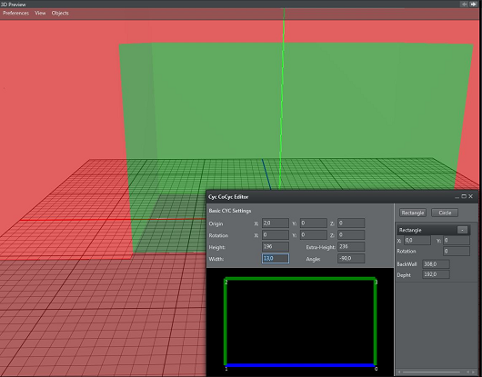

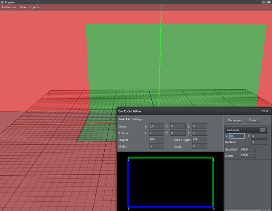

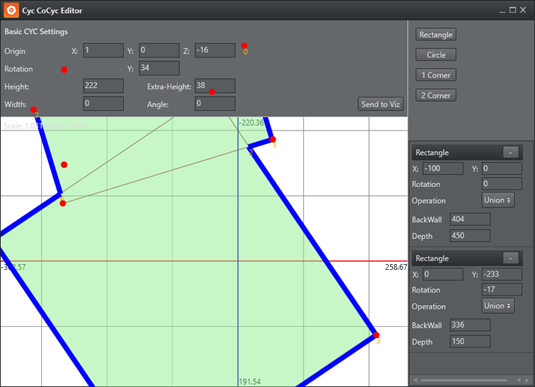

CYC Editor
The CYC Editor enables the user to create a Cyc and CoCyc mask which is needed to mask out regions of the Studio which are not covered by the green/blue screen.
The CoCyc mask is a geometry which will be created in the CYC Editor and stored on the Tracking Hub. From there the CoCyc is sent to all connected Engines. Every change in the editor and its sub elements is immediate communicated to the engines and to the Tracking Hub.
In Tracking Hub and the Studio Manager, a Cyc is defined by basic shapes, such as rectangles and circles, which can be added to a Shape List. All the shapes in the list will be united by a Boolean operation which results in a segment list. The segment list is displayed in the segment area. From all these segments, a continuous subgroup can be selected in the editor to define if the segment is part of the green/blue wall or not. Every segment, not selected (blue), will be part of the floor. Every segment which is selected (green) will be part of the Cyc wall. Based on this information, the Studio Manager is able to calculate a mask object which is then sent to Viz Engine.
The Cyc Editor consists of the following Areas
Origin: Defines the X,Y,Z offset of the generated cyc with respect to the origin of the Viz Engine coordinate system.
Rotation: Defines the X,Y,Z rotation offset of the generated cyc with respect to the VIZ coordinate System.
Height: Defines the height of the green wall.
Extra Height: Defines the height of the studio ceiling.
Angle: see next section
Width: see next section
CyC editor Angle and Width
The CYC generation algorithm works as follows:
Find a continuous group of wall segments and mark the start and end segment.
Calculate the normal of the last segment which is not part of the wall group.
Calculate the direction of the first segment wich is a wall.
Extrude the CoCyc for Width cm in the calculated normal direction.
Continue the extrude in direction of the first wall segment plus Angle
Do the same with the end segment of the continuous group

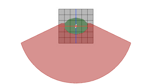

Close the CoCyc with a big surrounding circular object
Some examples:

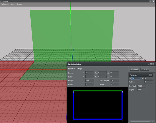

A simple Back Wall Studio with one green wall:
A corner studio with rectangular floor
A Studio with 3 walls and rectangular floor

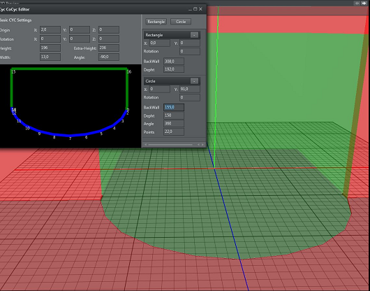

A studio with circular end floor
Shape Area
In the shape area basic shapes can be added to the shape list. Every list elements shows a “-” in the Header line. Clicking on the “-” will remove the shape from the list. Every shape can have its own origin and rotation about the Y axis. Additional every shape brings its own parameters.
Rectangle
Back Wall: The width of the rectangle in centimeters
Depth: The depth of the rectangle in centimeters
Circle
Back Wall: The width of the circle in centimeters
Depth: The depth of the circle in centimeters
Angle: If smaller than 360 this defines the angle of the pie the shape creates
Points: The amount of segments the shape consists.

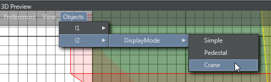

Objects Menu
Every Rig present in the Tracking Hub brings its own display menu with it. This options are handled in the Object menu item. In this first release Tracking Hub offers only one Rig: Simple Camera. In future releases more rigs will be added which will allow to create Cranes and other geometries.
l1 / l2 / l3: Select which Rig
Selectable Display Modes

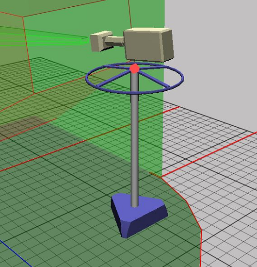

Simple: The tracked point is displayed as selectable circle in the view. A rendered camera shows the offset settings.
Pedestal: The Rig is displayed as a tracked pedestal. The tracking point is always on top of the pan/tilt head. The rendered camera shows the offsets added to the rig.

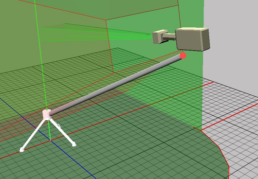

Crane: The Rig is displayed as small jib. The origin of the base is the X/Z offset of the rig. The tracked point is a result of offset and height.
Object: Object is a tracked object which is not a camera. E.g. Motion Analysis objects. No camera is rendered and only the tracked point is displayed.

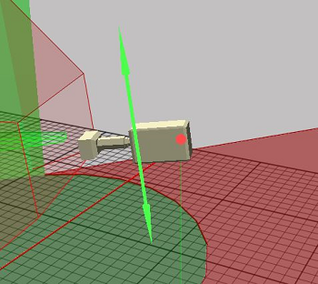

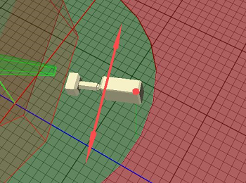

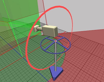

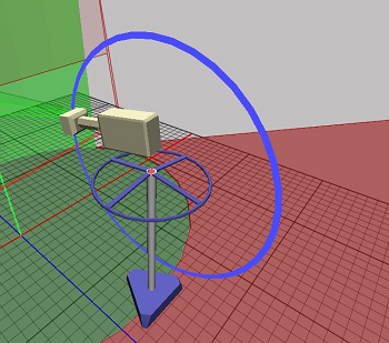

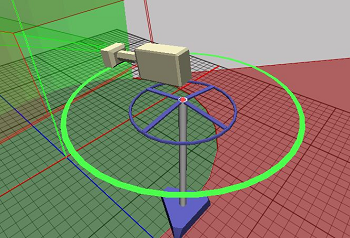

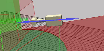

Camera Handles

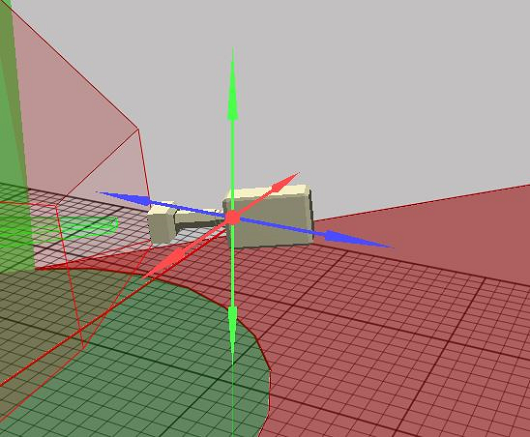

Whenever the user clicks in the Rig editor to adjust a specific value the preview panel will display the values as a drag able handle. Handles can be Arrows (position) or Disks (rotation). Whenever the user touches a Handle with the mouse, the handle goes from its base color to yellow. This indicates that only this handle is active at the moment. Clicking with the left mouse button and moving the mouse in handle or in the opposite direction modifies the handles value.
The following list shows all available handles and the corresponding rig values.
Position Offset: Every axis is color coded and only visible if modifiable.
Green: Y Axis
Red: X Axis
Blue: Z Axis
Pan Offset
Green: Modifies the pan offset of the camera and is rendered green.
Tilt Offset: Modifies the tilt offset of the camera and is rendered blue.
Roll Offset: Modifies the roll of the rig and is rendered red.
