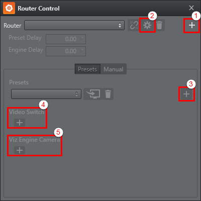

Click the plus icon (+) in the upper right corner to add a router (1). If a router has been added to the system previously, it can be reused by selecting it from the Router drop-down list.
Click the cogwheel icon to configure the connection settings and AB mode for the router (2).

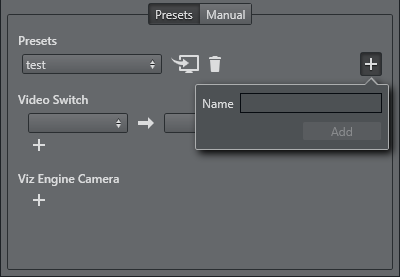

Next, click the plus icon (+) to the right in the Preset section to add a preset (3). Enter a Name and click Add.
In the Video Switch section, select the Input and Output on the router from the left and right drop-down lists, respectively.
In the Viz Engine Camera section, select which Engine and camera to switch to.

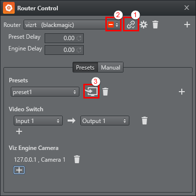

A router connection with a preset has now been configured, and the Router Control window should look like this:
Click the Connect button (1) to connect to the configured router. If there is a connection problem, this will be indicated by a red warning box in the Router drop-down list (2). To issue the take command to the router and Engine, click the Take button (3).

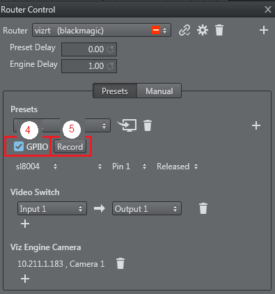

In addition to the standard configuration, you can add a GPI IO device for switching (4).
You can select this device if it was detected during startup. This detection is done automatically.
To configure the device, you have two options:
Manual: Select the device, the port (not available for all devices), and the pin.
In addition, you can select if the switching should react on pressing or releasing the button. -
Automatic: Click Record (5) and then selcet the button on the GPI IO device.
The button is recorded and conntected to the actual preset.
