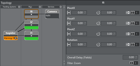

Pivot Rotation
Rotates the coordinate system of a rig around a free definable point in space. The camera Rig is bound to the pivot point in a parent child relationship.
PivotX, PivotY and PivotZ defines the location of where the rotation will take place. Rotation specifies the rotation in degrees around the Y Axis of the pivot point.
After the rotation the coordinate system of the Rig is rotated around the Pivot Point. This is useful if, for example, a rail tracker needs to be adjusted in angle and offset to a studio coordinate system.

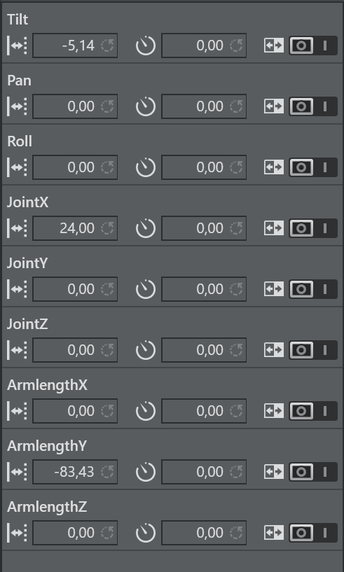

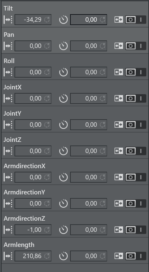

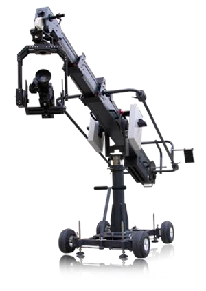

Crane Arm
The Crane Arm Rig is used to represent a crane arm. The difference from the normal Arm Rig is that the direction fields define a normalized direction of the arm, and the lenght is defined by the ArmLength field. In the arm rig, the Length parameters can be seperated by axis.
You can set a JointX, JointY and JointZ value to adjust mounting offsets between the Position giving element and the arm.
ArmdirectionX, ArmdirectionY and ArmdirectionZ are normalized to 1 and define the initial direction of the Arm. Usually, ArmdirectionZ is set to -1.

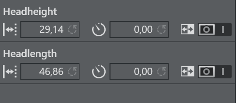

Crane Head
A crane head represents a perpendular element, which can be attached to a crane arm, or to a simple arm. The Headlength defines the horizontal length in -Z direction after the perpendular element. The Headheight defines the Height in -Y direction after the perpendular element.

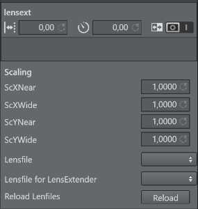

Lensfile
The lens file rig must always be the first one in the rig hierarchy. It is able to select one of the lens files, which must be located in the Lensfile folder in the TH configuration folder in %ProgramData%. Once in the hierarchy, the lensfile interprets the incoming raw zoom and raw focus values and sends FieldOfView, K1, K2, CenterShift and NodalPoint to the engine. The camera service object must be targeted to the lensfile rig.
The only trackable parameter in the rig is the lensext parameter. In some protocols, such as FreeD, the lens extender is tracked. The value of lensext can be 0 or 1. If it is 0, the first lens file is used. If set to 1, the second lens file is used. The scaling values define a scale factor for the field of view with respect to the actual zoom value. ScYNear and ScXNear are the scaling factor when the lens is completely zoomed in. ScYWide and ScXWide define the scaling factor when the lens is completely wide. Between Wide and Near, the values are interpolated. If you do any changes inside the lensfile or add some new, you must press Reload to make them available in your configuation.

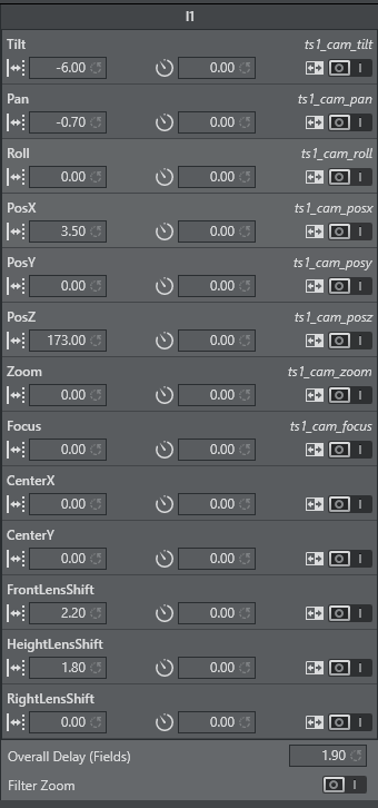

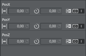

Position and Rotation
Tilt, Pan and Roll defining the rotation of the camera around the X,Y and Z Axis.
PosX, PosY and PosZ defines the position of the camera in space. Every one of these values might be tracked. In the case of a Pan/Tilt camera head, which does not provide position information, the position can be adjusted in the offset values.
Zoom and Focus
Zoom and Focus are coming from the Lens encoders (whether internal or external). In the system and in Viz Engine these values are always normalized and goes from 0 to 1. Therefore it is most important that the Lens Ranges are calibrated correctly in the tracking system.

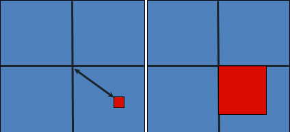

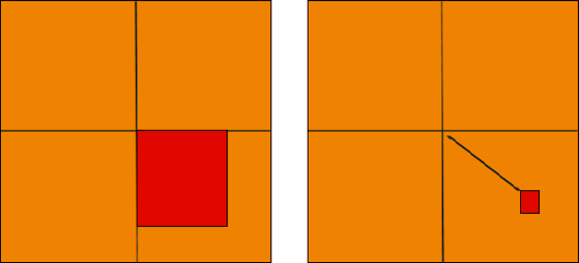

Center Shift
Whenever you mount a lens to a camera body, the connection will never be 100% the same every time; hence, there will always be an offset between the camera body and the lens which will shift the angle of the light onto to charge-coupled device (CCD). In the Viz Virtual Studio software this effect is called the Center Shift.
Note that every lens shows its own center shift and can for the most part be ignored as it’s much smaller than the center shift caused when mounting the lens to the camera body. The most visible center shift is caused by the actual mounting of the lens and is more and more visible as the mount connection between the camera body and the lens is damaged/worn.
In order to calibrate the center shift, the Camera Rig handles the CenterX and CenterY offsets the following way: Completely zoomed out the full offset will be applied and sent to the Viz Engine. As more zoomed in these values go in zero direction until they reach absolute zero when completely zoomed in. It is absolutely necessary to calibrate this center-shift to get an acceptable tracking result. Whenever you see a movement of virtual objects when zooming in and out, you will have to check if the center shift has changed.
Note: Always check the center shift after mounting your lens to the camera body!
To calibrate the center shift, follow the algorithm below:
Reset the CenterX and CenterY values to zero.
Look for a corner or easy to identify point in the camera view.
Enable the Center Shift Cross in Viz Artist, see Scene Settings > Virtual Studio.
Zoom completely in to this point and adjust focus. This is also a good point in time to check the back focus of the camera.
Pan and tilt the camera until the corner or point aligns with the Center Shift Cross.
Zoom out completely and you will see that the point slides away from the center.
Adjust the CenterX and CenterY values until the corner or point aligns with the Center Shift Cross again.
Zoom out completely. If the Center Shift Cross is no longer in the corner or point, repeat from step 5.
Note: Repeat the steps until the Center Shift Cross is on the corner or point at all times. After two or three iterations this is usually the case.

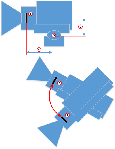

Mounting Offsets
In order to get an acceptable result we need to know the exact position of the camera’s charge-coupled device (CCD) position. The CCD is (after the optical nodal point) the position of the Viz Engine remote camera.
Not every tracking system gives that position. More likely, the position of the last rotation axis on the mechanical head is given, which in most cases is the tilt axis. If the send position is not clear, you will have to contact the vendor of the tracking system.
After mounting a camera to a head there will always be offsets between the tracked point and the CCD of the camera. Many cameras have a mark on their body which marks the position of the CCD. If no mark is visible, you can assume that the CCD is 2 cm behind the mounting point of the lens.
In Tracking Hub we know three mounting offsets. The FrontLensShift, HeightLensShift and the RightLensShift. The following drawings show the Front and Height Lens Shift and how these values change the behavior of the CCD.

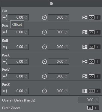

Extended Lens Parameters Rig
This rig holds parameters, which are rarely used and delivered by TrackMen and Libero only.

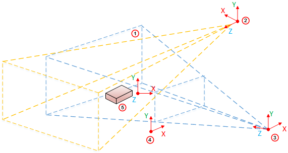

The rig object Basic Camera has to be attached at the end of every rig structure. In this rig object is the most basic and most often used parameters required for exact tracking. This section shows how the Tracking Hub needs to place the idealized OpenGL point camera to create an approximation of the physical studio camera.
Item |
Description |
1 |
Clip space |
2 |
Light Space |
3 |
Camera Space |
4 |
Image Space |
5 |
Object Space |
By default, the OpenGL camera is a point in space. All transformations (perspective and model view) are linear. It does not matter how much the zoom is increased in the perspective, or how near the camera is to an object in the model view transformation, a straight line in the model space will be a straight line in the image projection. When the camera is rotated it will rotate around its position.

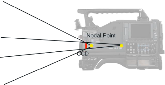

Nodal Point
Let us assume the OpenGL camera is placed on the charge-coupled device (CCD) of the camera body.
In the image, above, it completely depends on the field of view, where the light rays reflected from an object conjure to a point and create a sharp picture on the CCD. For sports, where the real camera is far away from the watched objects (we assume distances of more than 10 meters), there is no influence from the adjusted focus. Therefore in the image above we only observe the zoom effects on the nodal point of the objects watched.
Zooming in and out, causes the light rays, going through the lens, to conjure on a moving point behind the lens. In our Viz Virtual Studio software, we call this point the Nodal Point, and this point marks the position where we have to place our idealized OpenGL camera. The Nodal Point is defined during lens calibration, which is still happening in the Viz Engine. Therefore it is not an error, if you zoom in and out, and the position of the camera is moving towards and away from the Look-At direction of the camera. This is intended and must be done to provide an accurate result.
Note: Currently the Nodal Point comes from the lens file only.

Mounting Offsets
Item |
Description |
1 |
CCD |
2 |
Height Lens Shift |
3 |
Tilt Axis |
4 |
Front Layer |

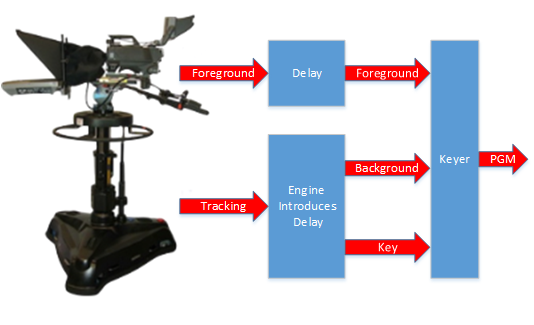

Video Delay
It is assumed that the camera and the tracking system are connected to the same sync signal. When the camera records an image, the tracking system acquires the cameras position, does some calculations and then sends this data to the Tracking Hub, which one field later sends this tracking information to the Viz Engine. Unfortunately, the Viz Engine needs time to first render the image and additional time to output this image through the video card to its output. Normally, this process needs about 2 or 3 frames, depending on the video hardware used.
If we route the image from the camera directly to the keyer, the video will be presented before the rendered image from the Viz Engine. Therefore, delaying the video for a specific time is required in order to achieve a close match between the real image (i.e. the foreground in the virtual set) and the rendered image (i.e. the background in the virtual set). To apply this video delay it is (or was) required to introduce a delay line, which delays the video for a specific amount of frames.
Note: In interlaced modes it can not be delayed for fields. Video delays can only be applied on a frame base.
Modern Keyers, such as the Ultimatte 11 or the Saphire 3 have built in delay lines. An extra delay line must be installed when using older hardware.

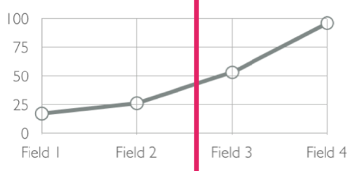

From the last chapter we know, that video delay can only be set in whole values of frames. How do we set the fraction of a field?
Note: When the delay differs 0.1 field from the video it is visible to the eye!
The only way to solve this problem is to interpolate using the tracking data received by the Tracking Hub. There is an Overall delay setting in the Studio Manager RIG control that can be used to interpolate the tracking data in fractions of fields. In addition, every axis can have its own delay bias. This is useful, when mixing different tracking systems. When the overall delay is set to 0.5, the tracking hub interpolates a half field back in time.
But what can you do if the delay must be set to -0.5 to achieve a good result? This is not possible. We cannot attempt to extrapolate the data, because this will probably result in ugly jumps. In this case, the only solution is to increase the video delay.
