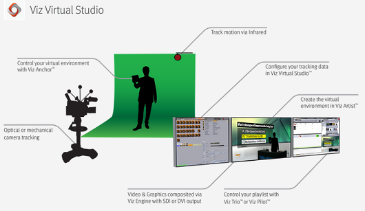

The Viz Virtual Studio should provide a perfect match between the real and the virtual scene elements. The reality is a compromise between the technical possibilities and the perceptual ability of the audience.
