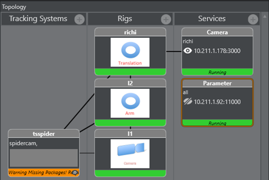

Topology Panel
The Topology Panel shows a representation of the tracking systems, the connection to a Viz Engine and which Viz Engine services are in use.
Tracking Systems
The Tracking System panel represents the tracking software in the studio.
Click on a tracking system icon to view its properties (see Parameter Panel).
A line from the tracking system represents a connection to a Rig.

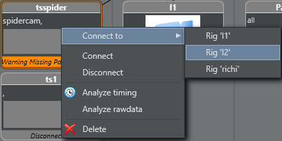

Right-click Menu:
Connect to: Connect to a Rig.
Connect/Disconnect: Connect or disconnect to the tracking system.
Analyze timing: See Analyze Time.
Analyze rawdata: Click to enable or disable the collection of raw data for analytical purposes.
Delete: Remove the Tracking System.

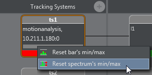

Right-click on a Bar:
Reset bar’s min/max: Reset the minimum and maximum value of each bar.
Reset spectrum’s min/max: Reset the minimum and maximum value of the whole spectrum and each bar

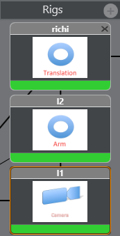

Rigs
A Rig is the interface between the Tracking System and the Viz Engine. Click on any Rig icon to view its properties (see Parameter Panel).
A line from a Rig on the left represents a connection to a tracking system (see Tracking Systems). A line from a Rig on the right represents a connection to a Service (see Services).
Rigs are defined as the following types:
Translation
Arm
Location Pivot Rotation
Pivot Rotation
Camera
Object
The Translantion rig is for position data only, and provides the Tracking Hub with the following parameters:
pos_x
pos_y
pos_z
The Arm rig can be rotated in 3 dimensions, and starts with a swivel. It has a defined length with a defined direction, and offsets between swivel and length.

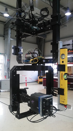

Both the Translation and Arm rigs are used for camera systems such as Spidercam:
The Location Pivot Rotation rig is a rotation interface in the X-Z dimension, with center point (0/0).
Pivot Rotation is a rotation rig with a definable center point. The rig provides the Tracking Hub with the following coordinates:
pivotx
pivoty
pivotz
Camera is a basic rig for tracked cameras.
Object is a basic object for tracked objects.
Services
A Service is the element of a Viz Engine which is connected to the Tracking System through the Rig.
Click on a Service icon to view its properties (see Parameter Panel).
A line from the a Service represents a connection to a Rig (see Rigs).
Services available are:
Camera: Track a with a Viz Engine camera.
Object: Track an object with Viz Engine.
Parameter: Provides all required data for the creation of the 3d View.
Communication Timing: Sends timing information which are measured during tracking data acquisition.
Tracking Timing: Sends timing information which are measured during sending the data as service to the engines.

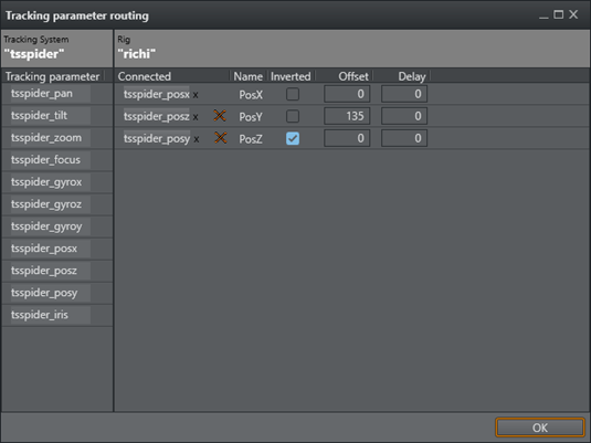

Topology Connection Lines
The Topology Connection Lines show the connections between each item in the Topology. Double-clicking a Topology connection line between a Tracking System and a Rig opens the Tracking parameter routing window for the connection:
