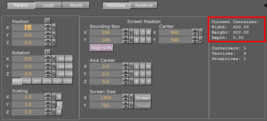

Drag a Rectangle container plug-in to the scene tree to create a new container, and add the Expert container plug-in. In the Expert plug-in properties, select Outline as Drawmode to create a bounding box.
Often, it is useful to fit the entire data into a given screen bounding box. This can be achieved positioning the newly added rectangle on the screen, representing the area where the graph should be drawn. Here, the rectangle has width of 500 and a height of 300. It is positioned at 0.0 in Z-space, as is also the container holding the Bar Chart itself.Open the rectangle container’s Transformation Editor and check the effective width and height of the boundary rectangle:
To match the width of the graph to the bounding box, open the Bar Chart plug-in properties and change the Chart Width to Total and the Bar Width to that of the bounding rectangle (500.0). Then set Horizontal Alignment to Center.

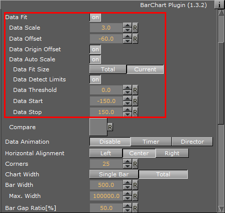

Mapping the graph to fit the whole height of the bounding area is done by enabling some of the properties inherent of the Bar Chart plug-in. In the property panel, set Data Fit and Data Auto Scale to On, then set Data Fit Size to Current. Then either type in, or click and drag, the Data Start and Data Stop values as required. The sum of these two should equal the height of the bounding box.
Open the Control Object tab in the Object area, and enter the values used for the example data scale calculation above, -14, 70, -30, 12, 15, 20, 5, as values for the Bar Values object. The preview is automatically updated. The result should look like this, with the Bars perfectly matching the bounding area:

The minimum and maximum values of the data needs to be known to be able to calculate the required scale value. For example, if using the values -14, 70, -30, 12, 15, 20, 5 as input data, the minimum value is -30 and the maximum value is 70. If negative values are not used, set the minimum value to minimum to 0.0 (more mathematically speaking; min=minimum(0.0, minimum(inputdata))). For the example values above, this results in a range of 100 (from min to max). These 100 units must be matched to the bounding box height, which is 300. Dividing 300 by 100 returns a scale value of 3.0.
Set Data Fit to On and enter this value in the Data Scale field (1):
Open the Control Object tab in the Object area, and enter the values used for the example data scale calculation above, -14, 70, -30, 12, 15, 20, 5, as values for the Bar Values object. The preview is automatically updated. Notice how the graph aligns to the bounding box size, however, it is not centered in the middle.
To center the graph within the bounding box, a data offset translation value must be calculated. The formula for calculating this value is:
where dataScale is the value calculated in the previous step, and height is the bounding height (here: 300). Using the values in this example, the formula would be
Set Data Origin Offset to On and enter the resulting value, -60, in the Data Offset field. The result should look like in step 11, with the bars perfectly matching the bounding area.
