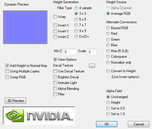

Creating normal maps for the bump inside your Shader is not complicated either; just go to NVIDIA’s corporate web page and download the relevant NVIDIA Photoshop plug-ins, or use this link NVIDIA Texture Tools for Adobe Photoshop.
After installing the filter in question, you have a new section in the filter category in Adobe Photoshop. By applying this filter, you will be shown a window with various settings (Please read the corresponding NVIDIA User’s Guide); yet there is not much work involved. Just have a look at the settings in the NVIDIA Photoshop plug-in Image below and start exploring them on your own.
