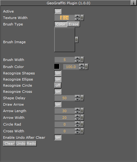

GeoGraffiti Properties
Active: Enable/disable drawing
Texture Width: Dimensions of the texture used for drawing canvas
Brush Type: Color or eraser brush
Brush Image: Optional image that will determine the shape of the brush. If empty, a round brush will be used
Brush Width: Width of the brush in pixels. Visible only if the selected Brush Type is Color
Eraser Brush Width: Width of the eraser in pixels. Visible only if the selected Brush Type is Eraser
Brush Color: Color of the brush
Recognize Shapes: Shape recognition mode (on/off)
Recognize Ellipse: Specifies whether shape recognition will try to recognize ellipse shape
Recognize Circle: Specifies whether shape recognition will try to recognize circle shape
Recognize Cross: Specifies whether shape recognition will try to recognize cross shape
Shape Delay: Number of frames to wait from mouse up before trying to recognize shapes
Draw Arrow: Specifies whether non-recognizable shapes will be converted to an arrow
Arrow Length: Set the length of an arrow head
Arrow Width: Set the width of an arrow head
Circle Rad: Radius of the circle replacing a recognized circle. If zero, the radius of the recognized circle will be used
Cross Width: Width of the cross replacing the recognized cross shape. If zero, the width of the recognized cross shape will be used
Enable Undo After Clear: Enable undo after the Clear button has been used.
Clear (button): Clears the canvas
Undo (button): Undo
Redo (button): Redo
