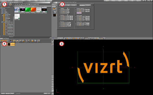

At system start, the area is divided into four panels:
Fig Item |
Panel |
Description |
1 |
From the Server panel, it is possible to control items such as Materials, Images, and Fontstyles, which are located in the Graphic Hub. |
2 |
Properties |
Properties for Containers, Cameras, Lights and Video Clip Playback Considerations are controlled from the Property panel, where size, position and other settings can be modified as required. |
3 |
A visualization of the Scene is shown in the Scene Editor panel. |
4 |
Items in the Graphic Hub database can be added to the Scene Tree, which is the logical visualization of a Scene. The Scene Tree is built up of Containers, which can hold items such as Materials or plug-ins. |

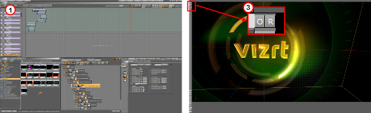

Viz Artist can be configured to work on two monitors, in the User Interface section of Viz Configuration. The Viz Artist user interface screen options are:
In both Horizontal and Vertical view, the monitor which displays the Scene Editor panel can be set to display either screen size or output aspect, by clicking the O or R buttons (3).

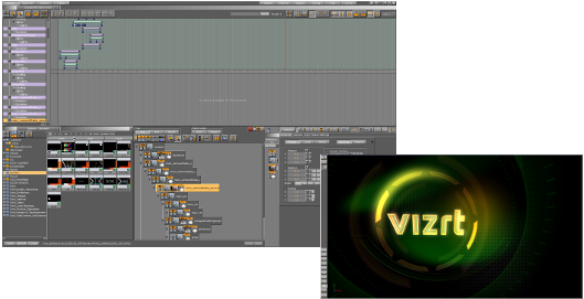

Dual Screen
The Scene Editor panel opens in a new window, and the items cannot be dragged to the Scene Editor panel.

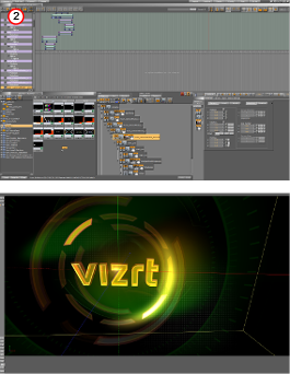

Mosaic Horizontal or Mosaic Vertical
Mosaic Horizontal (1): The Server, Properties and Scene Tree panels are displayed on the left monitor, and the Scene Editor is displayed on the right monitor.
Mosaic Vertical (2): The Server, Properties and Scene Tree panels are displayed on the top monitor, and the Scene Editor panel is displayed on the bottom monitor.

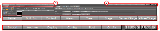

Main Menu
Use the buttons in the Main menu to select what is displayed in the display area.
