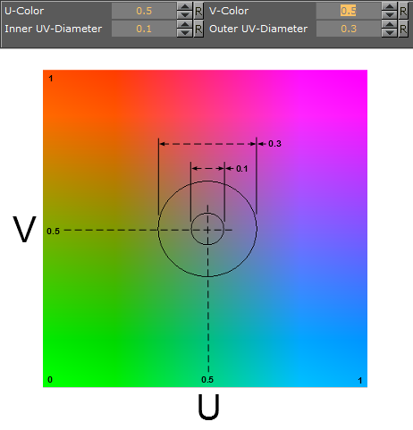

U-Color/V-Color
U-Color and V-Color: Set the background color in the YUV color space. The point set by these two parameters is the reference for the next parameters, which determine the colors to remove.
Inner UV-Diameter/ Outer UV-Diameter: All colors between the point defined by the U and V-Color and the Inner UV-Diameter are removed completely and for all colors between the Inner UV-Diameter and the Outer UV-Diameter the transparency will be set to a value between 0% and 100%.

Configure the U-Color and V-Color (set the background color in the YUV color space). The point set by these two parameters is the reference for the next parameters, which determine the colors to remove.
All colors between the point defined by the U-Color and V-Color and the Inner UV-Diameter will be removed completely, and all colors between the Inner UV-Diameter and the Outer UV-Diameter the transparency will be set to a value between 0% and 100%. -
