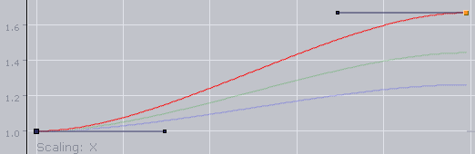

Scale Key Frame Editor Properties
Scale Key Frames have to do with the scaling of the object in the animation. For a scale Key Frame, in addition to the default options in the Key Frame Editors, it is possible to define the scaling along the X, Y, and Z axes in the three input boxes.
If you have animated the scale, you can scale along up to all three axes. To change all three scale values, in the object editor you will find an input box for X, one for Y and one for Z. There you can change if the values should be Locked or if you change them proportional (Prop) or each Single value.
Furthermore in the spline editor three different splines will be shown (when Prop or Single is selected), one for every axis. The red one is for the X-axis, the green one for the Y-axis and the blue one for the Z-axis. As you can only edit the currently selected spline, you must use three spline buttons at the top of the Dopesheet Editor (or shortcuts <Ctrl+Z>, <Ctrl+X> and <Ctrl+C>) to select the spline you want to edit. For ease of use in the lower left corner you will find indicated which axis is currently selected.
Scale axis, X, Y and Z

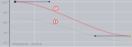

Material Key Frame Editor Properties
With a material Key Frame, in addition to the default options in the Key Frame Editors, it is possible to define color.
If a material has been animated, the object editor for the Key Frames shows a Material Editor . This allows you to conveniently the change the material.
Furthermore in the spline editor two different splines will be shown. The red one is for the alpha value (1), the green one for the shininess (2). As you can only edit the Key Frames/handles of one spline, you must use the number keys in the Stage Editor Bar to select the required spline. For ease of use in the lower left corner you will find indicated which parameter is currently selected.

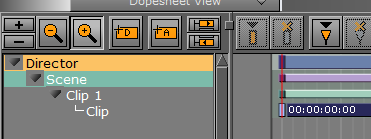

To Add a Clip to the Stage
Right-click the Director where clip is to be added.
Select Clip <number> from the Clip menu, then choose Clip.
To open the clip Key Frame editor, click the Clip Key Frame in the Dopesheet.
