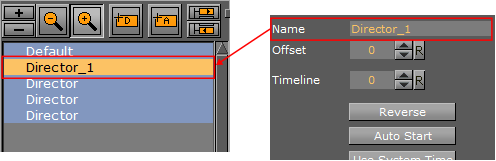

To Rename a Director
Note: Special characters, such as space, are not allowed in Director names.
Right-click a Director.
In the context menu, select Rename.
Type a new name.
Press <Enter>.
Or:
Select the required Director in the Stage Tree.
Open the Director Editor.
Type a descriptive name in the Name text box.
Press <Enter>.
