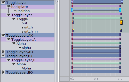

Toggle directors and Key Frames
The Toggle plug-in will create two directors each containing a default 1 second cross fade animation. These animations are placed in the AX and BX directors. AX can be interpreted as the A-side cross fade. The animations can be modified to show any kind of transition, but it is important that the AX and BX are the same.
In addition to the cross fade directors the Toggle plug-in will also create placeholder directors for the object animations. Merged objects that are loaded into these placeholder containers during playback may contain animations embedded in the geometry object. The object animations are automatically added as a sub-director to the AO or BO director depending on if the object is being loaded on the A-side or B-side.
Caution: It is NOT recommended to manually adjust the AO and BO directors.
There are two different scenarios of when the utility directors will be triggered:
When there is a state change.
When there is a state change the Toggle-Layer director will be animated from the current state to the required next state. In this scenario the utility directors will be triggered according to the toggle Key Frames in the stage. This means that it is the position of these Key Frames that will determine the timing of when the utility directors are triggered.
No state change, only changing the current object.
When there is no state change there will be no movement of the Toggle-Layer director. In this case the Toggle switch action will be triggered, which in effect will animate the utility directors at the same time; animating the current object out and the next object in at the same time.

After the Toggle plug-in has been added to the container, the plug-in icon can be clicked to see its properties. Clicking the Default Key Frames button will create the most commonly used Key Frames for triggering the toggling between the current and the other objects. Adjusting the timing can easily be done by moving the Key Frames in the stage.
