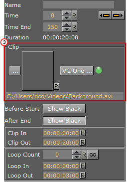

In the Clip1 channel, click in the dark blue area (2). The Clip Key Frame Editor opens on the far right.
Add a video clip (3):
In the Clip Name (5) line, click
, or
Drag a Video Clip item from the Server Panel, or
Click
, and select a video clip to import
Click
to specify a certain time/length for your clip. This is useful when loading clips from an external control application via Viz One. In this case, the lock clip length will act as a placeholder, but not change the clip length automatically after loading.
Note: To transfer and download videos from Viz One, Viz One must be integrated and configured with Viz Artist/Engine.
Note: Matrox Card Only: A green ‘traffic light’ shows that the video clip has loaded successfully. A gray ‘traffic light’ shows that no video clip has been loaded. A red ‘traffic light’ shows that there was an error when the video clip was loaded.
Note: This does not necessarily have to be the clip enabled in the previous procedures. It can be any video clip that Viz Artist can play.
IMPORTANT! If there is a conflict, the last clip selected, whether in the Stage or the Scene Settings, will be the one to play, with overriding effect.
Configure the Clip Key Frame Editor as required.
